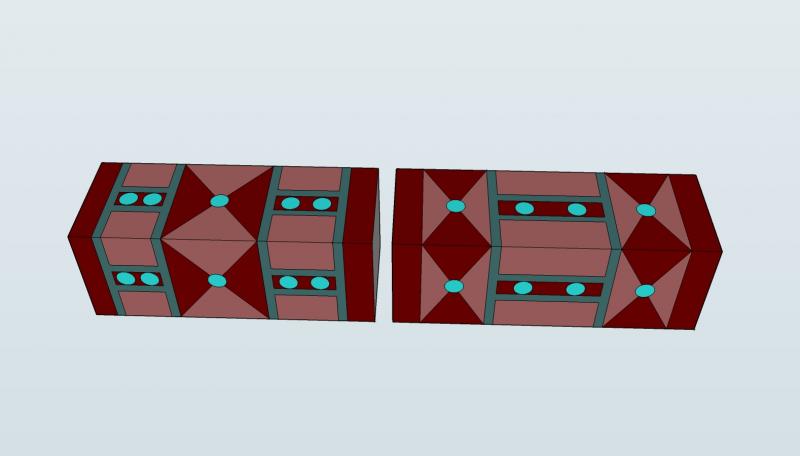

I'm uploading this just in case anyone is interested. My Byrnes saw comes tomorrow. I'm hoping to try this design next weekend.
I'm calling this a Harlequin pen and its engineered (on Sketchup) to match specs on a Big Ben twist pen from PSI.

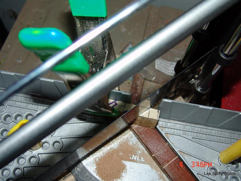

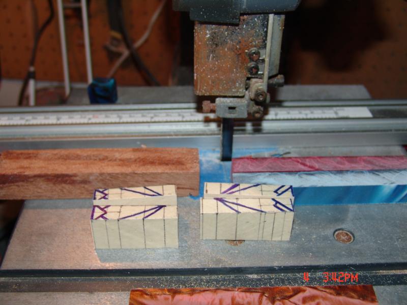

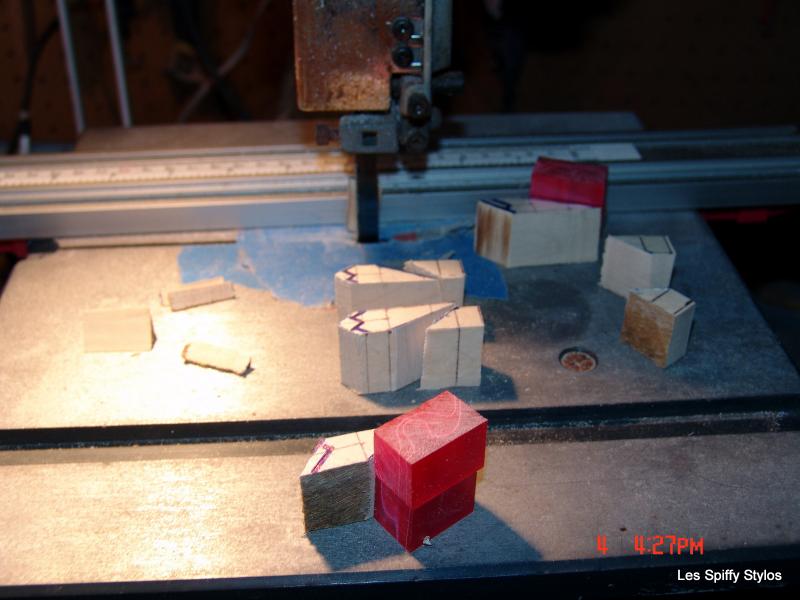

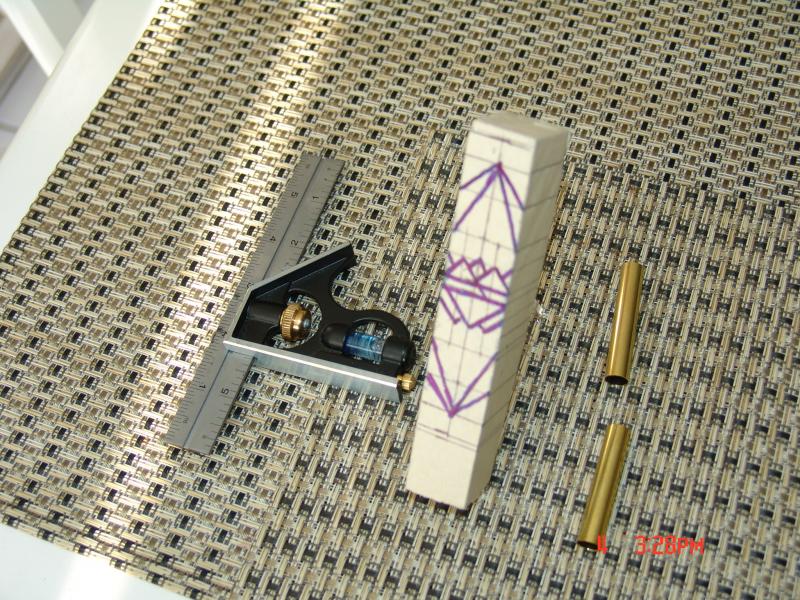

Will be happy to give details, but need some time to work on it. I'm already documenting on another design I put up. All I'm waiting on is my new saw and I'll get to work on them. Tried using my pain-in-the-keister table saw and a miter chop saw but could not get close to what I was looking for.
I'll attach some pictures from what I did if that's any help but truely, it didn't work right...the design I was trying to make is also attached. Not the same one from earlier in this thread

Don't know if this is going to happen...

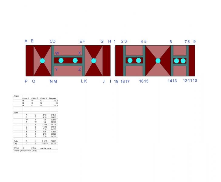

I did the math on the project. I've attached it. Now, I'm worried...
Still going to try this weekend though

Geophyrd,

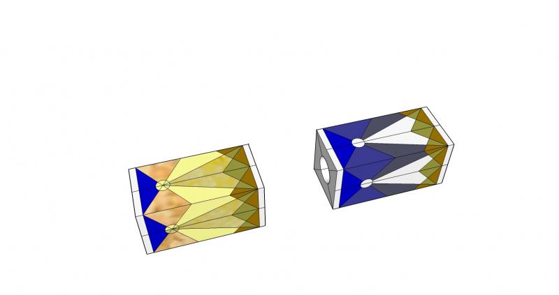

I've used Sketchup to try and design blanks and started like you did, with the blank square. When I rounded the blank, however I found the design had changed in ways that I hadn't imagined. In the blanks that you have posted, they are always still square, so I'm curious if they will look the same once they've been rounded?

Once I get it back, I'll post pictures of the pen I made out of the last attempt at this blank. I thought it looked a little 'busy' but my wife commented that its the prettiest pen I ever made. And I don't really consider it to be a success. I made a cigar pen but I used a kit that I bought off Ebay and the kit itself really isn't that good. Should have stuck with a PSI kit...that will be Saturday's project
As to why square, I like the fact that the pens turn out different than the blanks. Part of the charm of making complex pens...You can kind of predict after awhile what's going to turn out but not always. What I don't like is that if you don't drill perfectly in the center of the blank (which I think happens rarely despite my best efforts) the result is less than it might have been.
