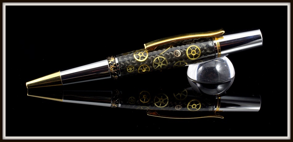

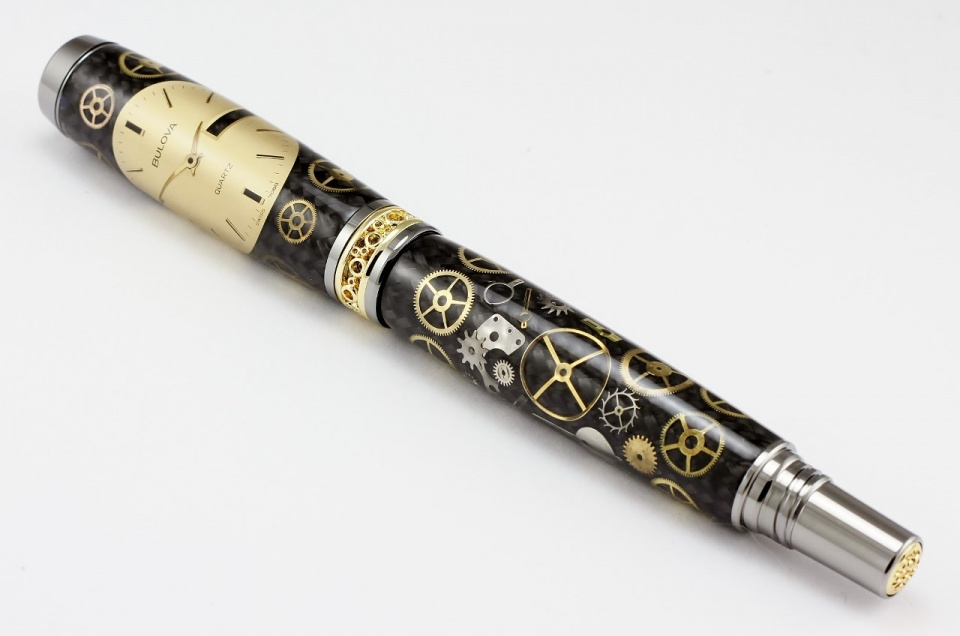

I received what in my opinion to be an amazing and flawless watch part pen on black carbon fiber in the Nov 2018 PITH from Jason ( Argo13). So I know he knows the answer if no one tells the trade secret maybe ask him. I been wondering the same thing so glad you asked these questions.

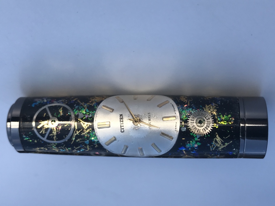

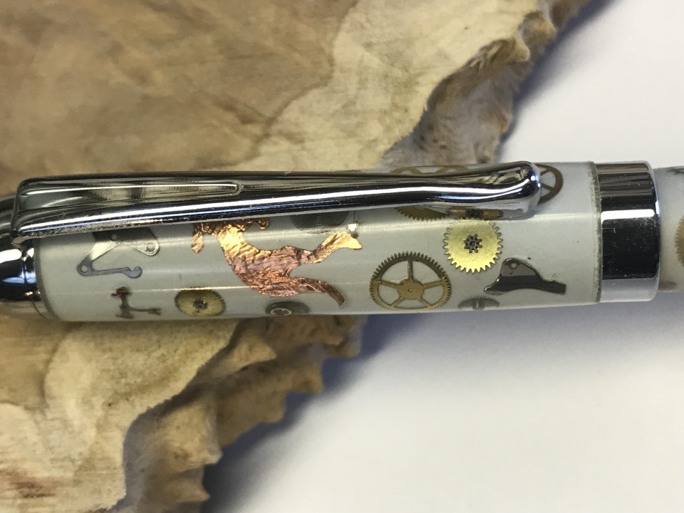

Attached is one of two watch parts blanks I have made that I was able to sell to a couple of customers.
I started by attaching the carbon fiber with CA. Here is the process I used:
1. Paint the tube black.
2. Fill the ends of the tube with play dough.
3. Cut the Carbon fiber to length and insert the tube.
4. Stretch the carbon fiber tight over a frame or by tying the ends.
5. Drench the whole thing in CA and allow to dry overnight.
6. Cut the end of the carbon fiber close to the tube and remove play dough.
7. Layout all of the parts that are going to be used to get a nice pattern.
8. Ben all of the parts to the size tube you are using with a dapping block and a press or hammer.
9. Using Thick CA attach all parts as organized earlier. Use as little CA as possible.
10. Allow to dry for at least 24 hours.
11. Cast with PR in whatever way you choose to cast. I recommend no more than 3-3.5 drops of MEKP per ounce of PR. (Also I think a pressure pot makes this cast so much less frustrating.
I think that is pretty much it. I have heard others using PR to adhere the carbon fiber to the tube but I have not tried it. I have had some failures with this because I did not get the CA to fully cure or off gas.
Hope this helps someone. I am certainly no expert.

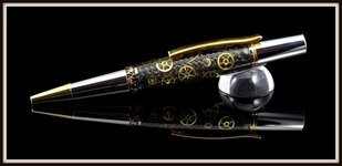

I have had excellent results gluing carbon fiber to the pen tube and also the watch parts with "Epoxy 330" water clear. I only have experience with Alumilite however the glue completely disappears in that material. I have also used thin CA to glue the parts to the carbon fiber with similar results. I believe the epoxy 330 is used a lot for jewelry making.

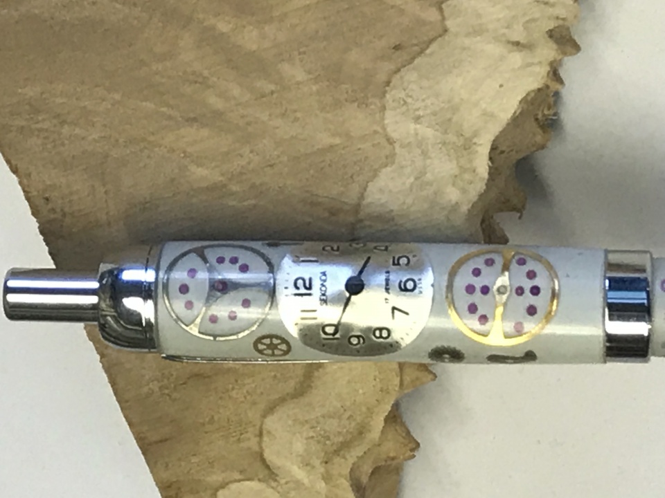

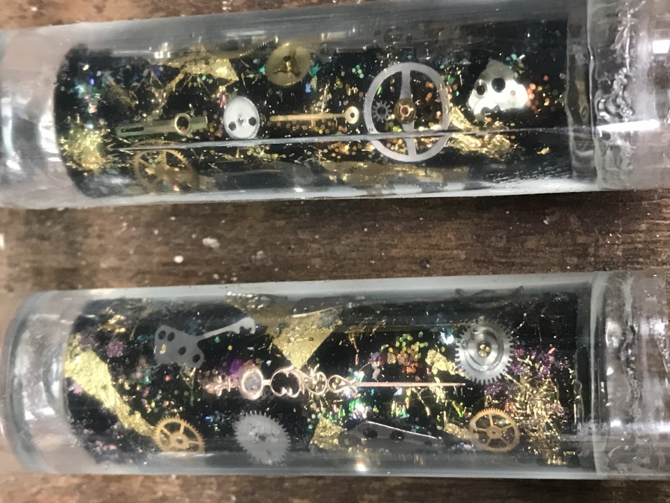

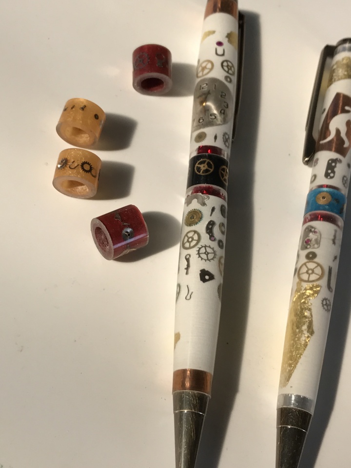

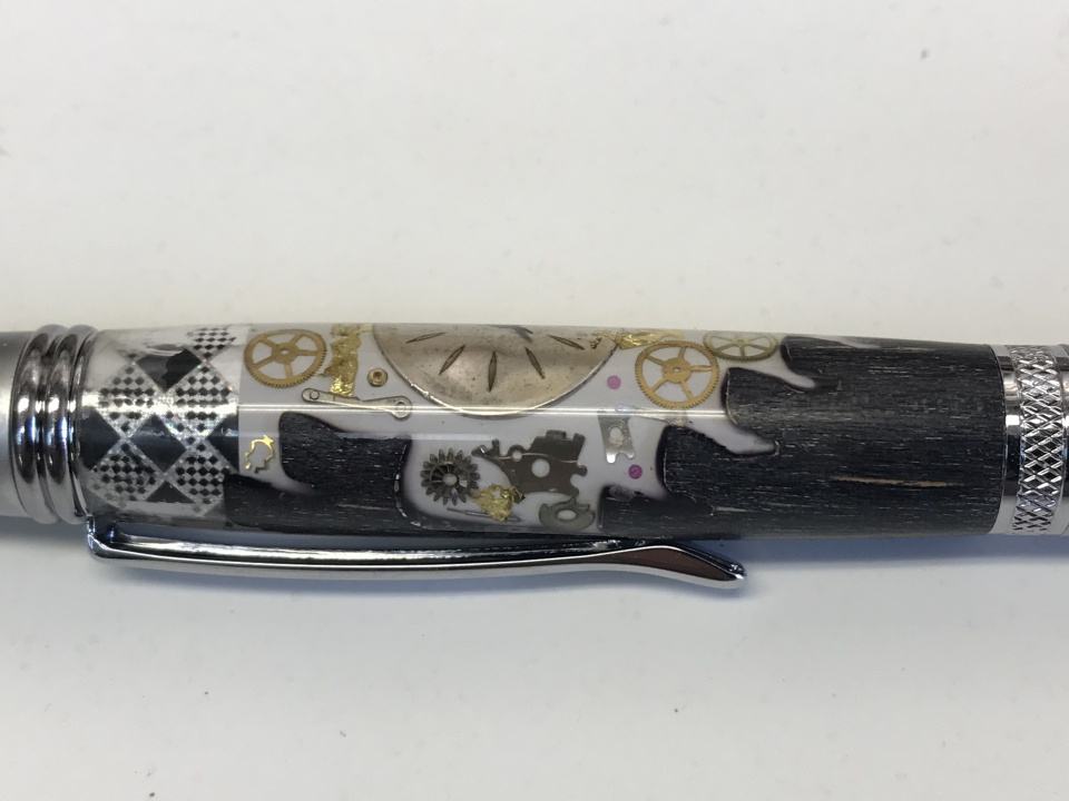

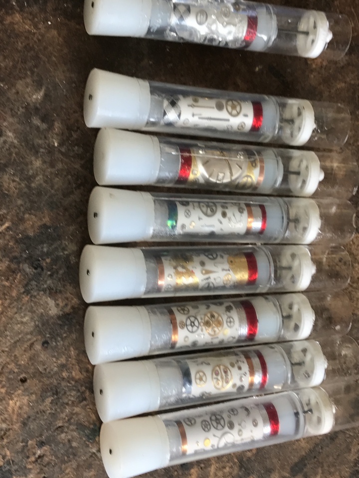

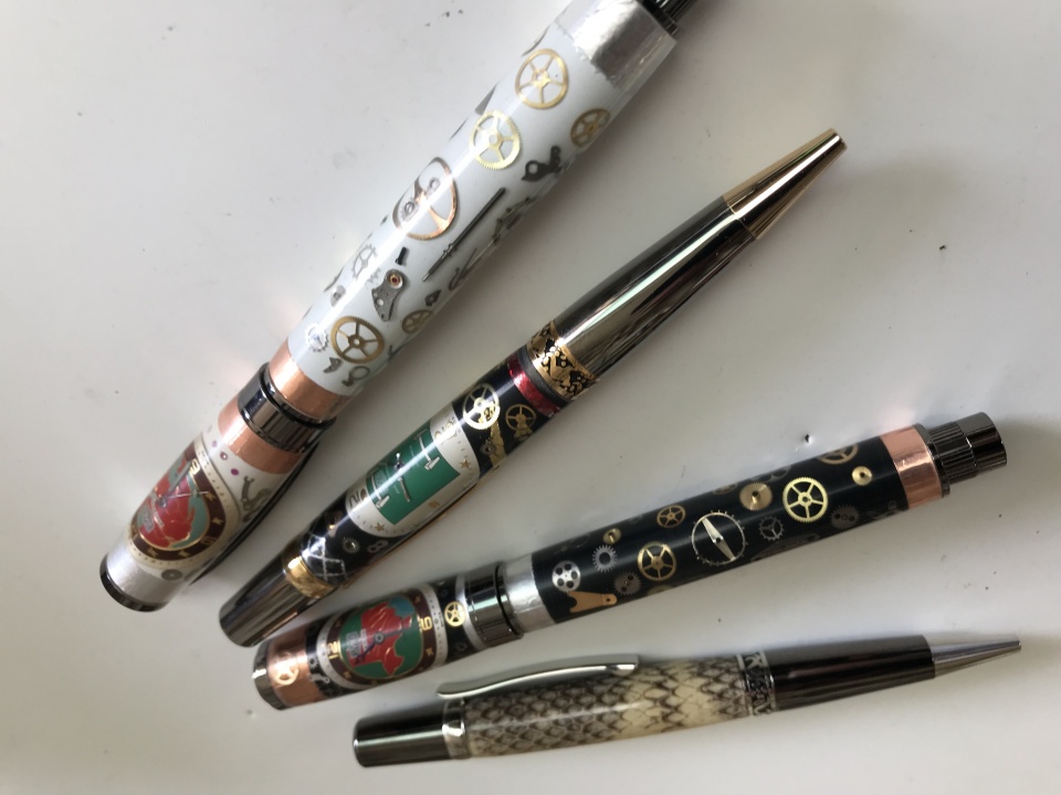

Some of my work,
Good thread was wondering when this would happen
Been doing watch parts Steampunk pens for 7 years now and before ask the first main question """ where do you buy the watch parts "" I buy mine from eBay and buy old whole watches that I pull apart myself and use all parts I can use
If some people got they trade secrets , sure some do and I do .
For casting I use PR and work well have no problem with CA to show on tubes and parts , will use in the coming weeks some Royal Palm Epoxy that I just recently receive so don't know what soil be the result , I try with LD ( Liquid Diamond ) and personally I don't like .
My process is simple I mix my PR and degase it ( or if I can say vacuum it ) leave rest for 5 minutes then pour in my tubes , I cast up right then in pressure pot over night, I turn my blanks when fully cured about 3 days ( this is me only because of my work )
Then turn and fit my kit , what kind of kit do I use , well I'm the only one to use any kits find on the market and I didn't see anyone doing CB Steampunk yet before me
Not to be pretentious here but look at those pens
Some members here got some of my work
Thank you for reading and looking , any questions ask if it goes on my little secret box :biggrin:

Sounds like there are many ways to get the results you want. For me, I use epoxy to glue the carbon fiber to the painted tube. After a day I use epoxy and a tooth pick to glue the parts to the tube after bending in the jewelers block. Another day and vertical cast in silmar. If your using painted backgrounds, experiment with a cast first. Many spray paints will react to the resin and heat, shrinking and melting. Try grill or engine paint. That's worked for me in other casts. Another issue is some watch face images may fade, melt or distort in resin. You may have to coat with medium Ca first, and let sit for a day. Just don't use Ca and alumilite together. Good luck!
