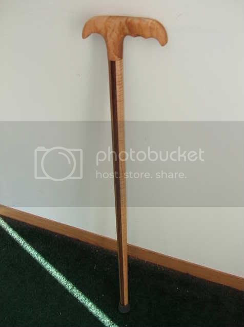

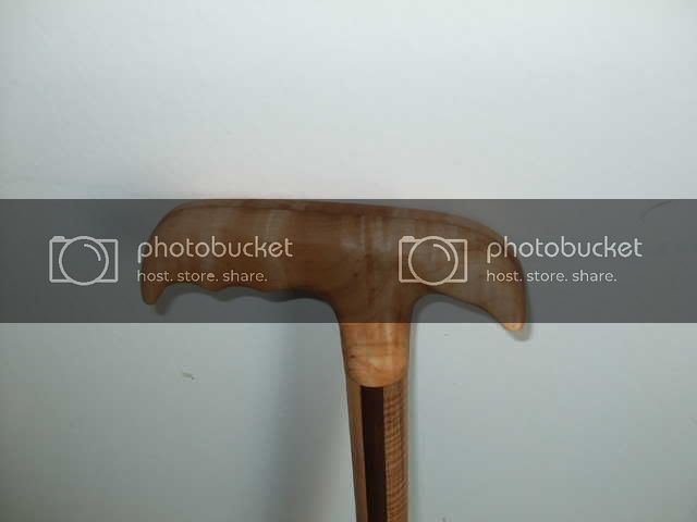

I made this one about a month ago, first time I ever tried one. Made it for my Dad. I ended up having quite a time with wobble in the middle, I needed a steady rest and didn't want to take the time to make one so I ended up turning a bunch of depth cuts on the shaft them taking it to the bench and proceeded to mill it down with hand planes and spokeshaves. Didn't take long maybe 45 min or so, them re mounted it on the lathe and finished it off with very light cuts from a skew. The handle was all done by hand with microplane rasps.
The wood is Maple & Walnut with Watco Teak wood finish.

But there aren't any problems with flexing when he puts weight on it?
How thick is it on each end?

No, no real flex issues while using it. The wobble I referred to was more vibration/chatter while engaging the tool. He's about 150 lbs and I'm 300+ and there was very little flex while I tested it with a lot of weight at all different angles. Shaft is 1" at the handle and 7/8" and the tip and the shaft is 29" long, which is a long distance between centers. The handle/shaft joint is drilled and doweled together.
