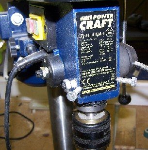

Chris, I stripped the DP down till the bones and found that the rack was only supported in two sloppy holes in the cast body. I bent up an aluminium plate to fit between the body and the rack. ( no precision needed, just vise and hammer ) This created a third bearing point. I then drilled and tapped in the thickest part of the body ( on the corners ) and screwed in two bolts to push the plate against the rack. I only tighten the bolts by hand of course or the rack won't move.
The pic shows where I put the bolts.
Hope this is useful
