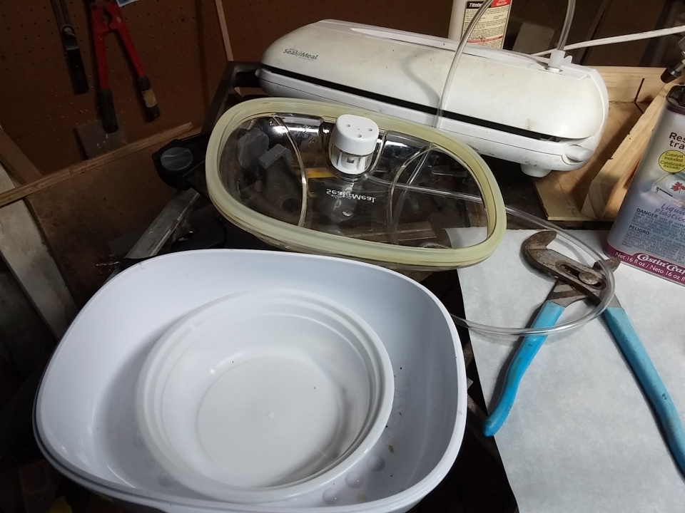

I've seen some videos where they put the PR in a vacuum pot for a few seconds before pouring to get the bubbles out. I don't have a vacuum pump and don't plan on getting one.
Do you think it would be worth it to use the accessory vacuum hose that's on my seal a meal and a small mason jar rigged up with the hose to give it a few seconds of most likely lighter vacuum to degass it?
I can't leave it running with some sort of chamber because the Seal a meal will only run for a minute or two.

Its one of those things I have the seal a meal and the chamber, a marinating dish so I may try it this morning.

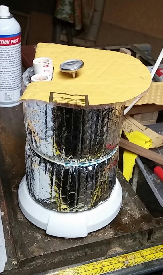

Ok here is a report.
While the resin moved around a bit I didn't see any bubbles popping. So I'll stick with warning my resin on a candle warmer.
I also use it to gently warm the blanks as they cure in a water bath. They get up to around 140 f.

Here is my setup. But they are still cooking. After an hour in the bath they we're past gummy. But I haven't been home.

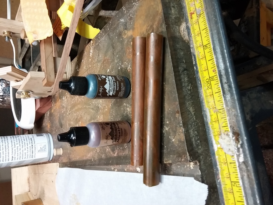

Done "cooking". There are done with alcohol inks. Epresso and copper mix ins.
I may get to drilling and painting tomorrow if I can get out and get some copper craft paint. And then turn them Tuesday.
