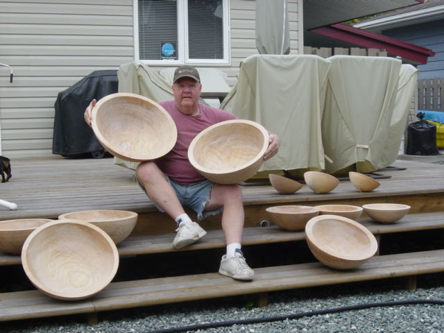

When you make bowls this big I think a vacuum chuck is a must. I have chucks from 2" to 10" and a vacuum face plate that is 20".
Lin

I don't have one, but I can see where it would be handy on large items where you don't want to attach with screws or do a lot of off the lathe finishing work. But, I could be wrong since I haven't done anything big yet.
Those are very large sir. :biggrin:
Lin
but seriously, a vacuum chuck is necessary to get to the next level of bowl and platter turning. Allows you to turn and finish without it being obvious how the piece was chucked to the lathe. Much more professional looking work IMVHO.

Yep you can jam chuck, you can make BIG cole jaws, but there is nothing like a vacuum chuck.
