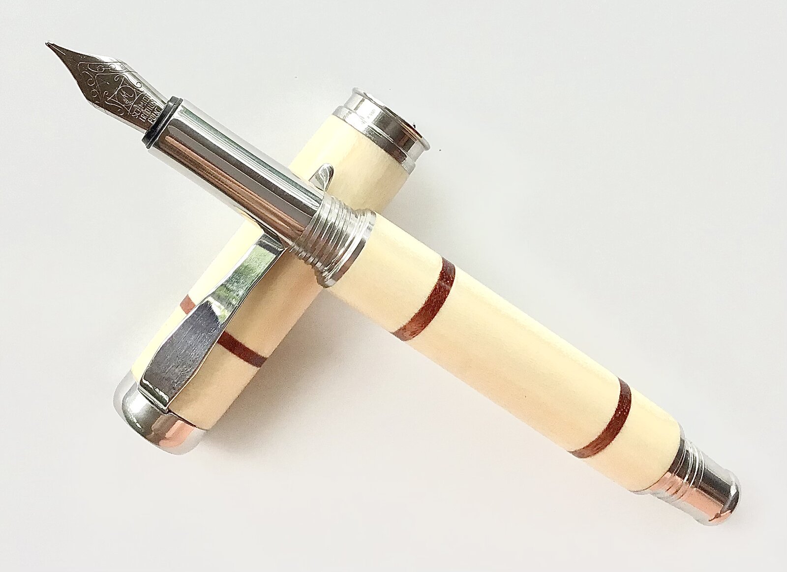

Feb 24, 2012
4,368
Claremont NH
I really don't do anything special with holly except what Goodturns said. Take it off the bushings and sand between centers. You can mix other woods with holly as long as you keep everything dry when sanding..

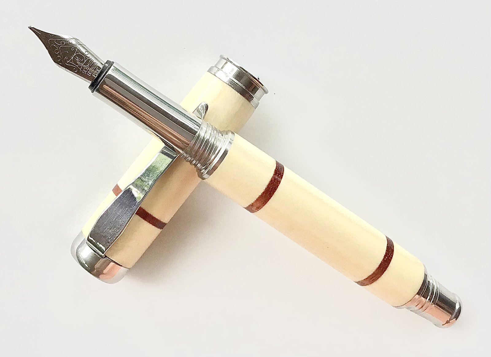

Feb 24, 2012
4,368
Claremont NH
Btw there was no CA used on this pen except for the segmenting. I don't CA finish anymore..
