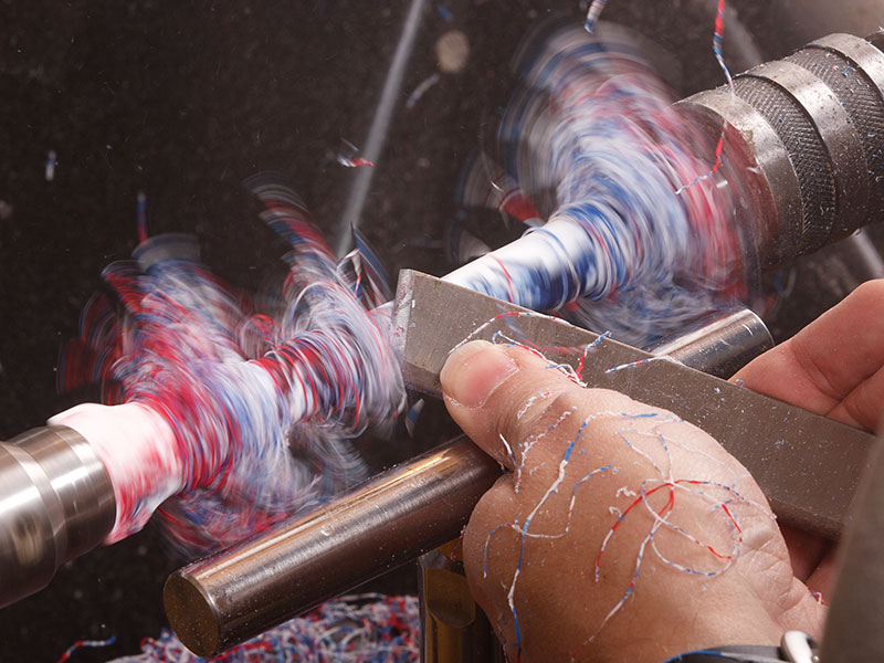

This is what works for me:
Foreshortening in the photo makes the chisel look stubby, but it is ground at a 30 degree skew angle. I have an oval skew, but I don't like it. I prefer a 1" flat skew with a rounded heel. If you look at the sharpened edge, you can see that it is hollow-ground, and has been touched-up with a flat stone (I use a diamond hone) a few times. As the photo illustrates, it cuts ribbons.
The shear-cutting action is achieved by presenting the edge to the work at an angle, and moving along the axis of the piece. That is, you start near one end, and the cut progresses along the length of the blank. Use the center of the skew, not the point or heel. Don't cut into the piece (unless you're making a v-cut). Keep firm axial (side-to-side) pressure on the tool to avoid a catch.
Many people recommend "riding the bevel" of the tool to help maintain control, but I find that tends to leave spiral ridges. I get a smoother cut if I stay just off the bevel.
I hope that helps,
Eric
Eric's picture is excellent!!
One thing you should notice is that the skew is angled upward slightly. Your back hand should be lower than the tool rest, by six inches or so.
Also note the lower edge of his skew has been sanded rounder-ish! It is NOT an oval skew, which touches your tool rest in only one point, it has the stability of a square skew, without the sharp edge that will mar your toolrest if you get a catch----best of both worlds.

In looking at the skew in Eric's photo and Ed's videos, it seems the blade of the skew is perpendicular to the axis of the handle. Most skews I see on the market (including all that I have) present the blade edge of the skew at an angle (other than 90*) to the axis of the handle. This may be difficult to picture in words. What I'm eluding to is this: is the angle of blade edge to handle axis more beneficial at 90* or at another angle?
I've thought about grinding down an old skew to make the blade edge perpendicular just to try it, but I haven't found the "stones" to do it yet.

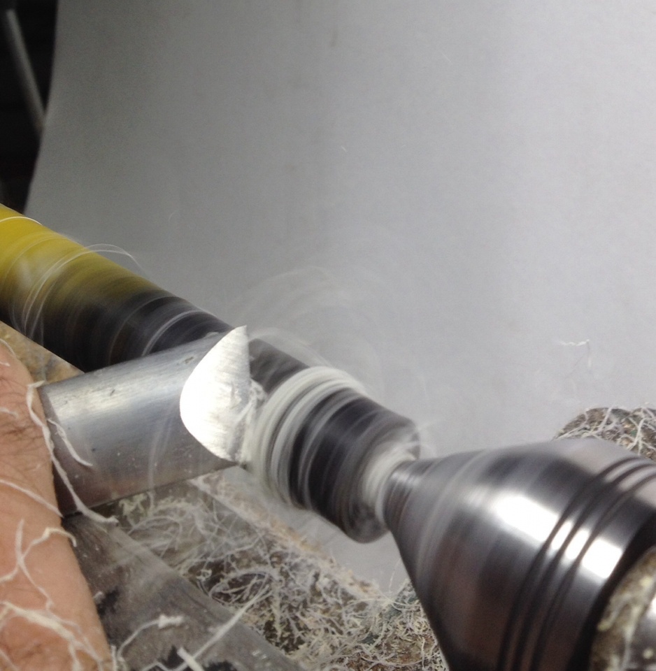

What you are asking about is below in my pic. I'm using a 35 degree bevel on an oval skew. There are many ways to use it, this is probably my most common approach on a blank.

I think Steve's approach is more traditional for skew use. It is an approach that could also easily cut coves in a spindle (which we never do on pens of course.
It is very close to what I do.
Eric's approach looks similar to what Ed Brown does in his videos and seems very effective for pen turning.
The perspective of the photograph can be deceiving. If you looked at my skew presentation from the top, it would look very similar to Steve's. The edge is not perpendicular, but rather at an angle (somewhere around 40-45 degrees) to the axis of the blank. That makes the chisel appear sharper to the turning than the actual grind angle.
Regards,
Eric
I was browsing through some of my old pictures for another reason and came across this shot. It shows that the chisel is ground at at 30 degree skew angle.
attachment.php
I hope that helps,
Eric

One more note that is very important, make sure the point stays above/out of the cutting actions and you will not have issues with catches. Erics last picture really shows this well. If the point gets into the action when you are planing as in the above picture you are amost always going to catch.
