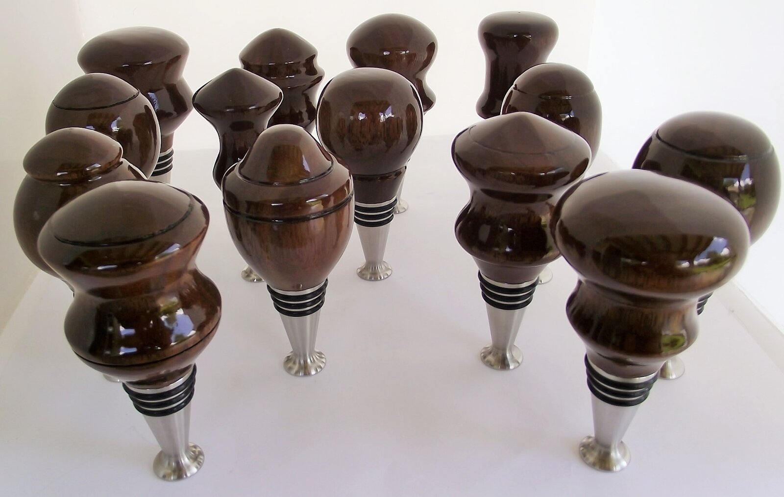

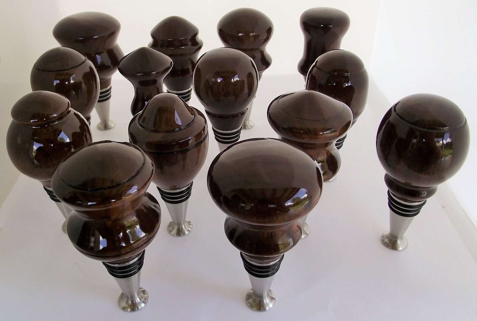

OK Steven demanded individual photos of these stoppers in my original post of four stoppers. Ain't gonna happen Steve! But here are 14 stoppers. All different, because I doubt that I could make two alike.🤨 Each have six coats of wipe on poly. (Watco) I had hoped I would never see another stopper, but there are more daughters and grand daughters around here, who I'm sure will want one. So I ordered more kits from Ruth Niles. The price is right. Enjoy Steven!

Very nice Chuck! Tis the season for wipeon poly now with all this heat. I like the poly finish but doesn't cure very good in the winter.
I didn't doubt you for a second Chuck.... ;) Not only did you complete your mission, you also maintained a stunning finish on every one of them. Well done buddy...:D
Thank you Steven! My first time ever using Wipe on. I was wondering if wet sanding and polishing would provide an even better finish. But I didn't want to risk back tracking. I like wipe on, and still have 1/2 can left.
