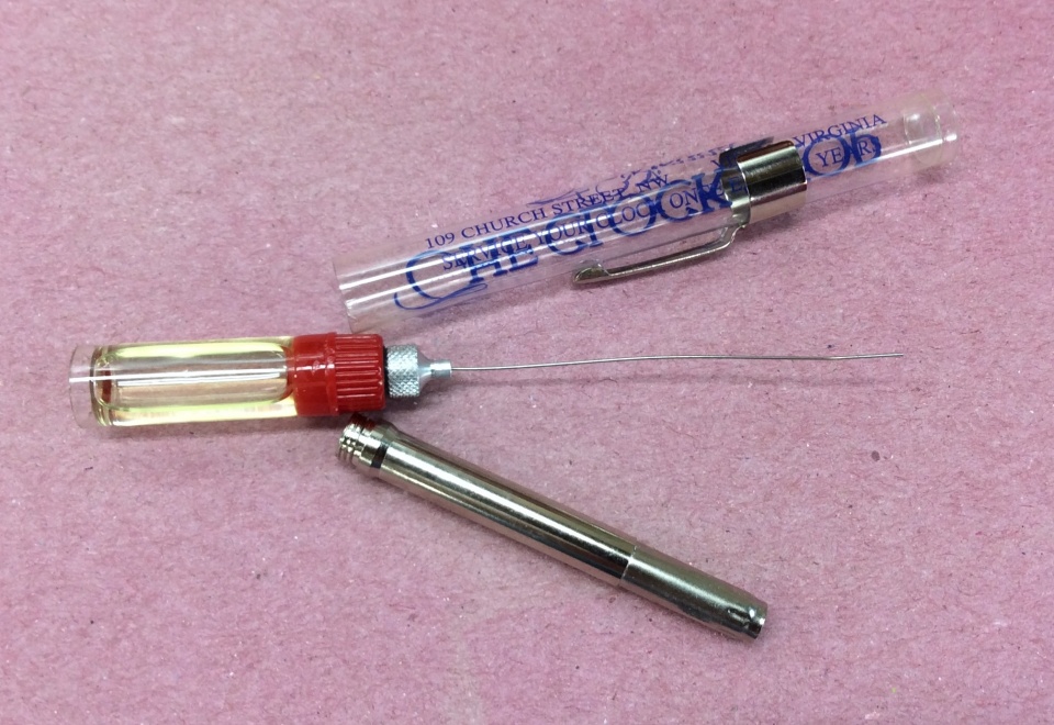

Here you go Tony! I picked this oiler up at a local clock shop. Pinpoint oiling.
Wow...more great stuff. Thank you. This is an amazing forum. The folks here are second to none.
Nice... I was going to use a diabetes syringe. This looks much safer. Thank you.
That is exactly what I use for small things that need to be oiled just cap it
when done.Tri-flo being a synthetic does not effect the plastic or rubber
the syringe is made of.
