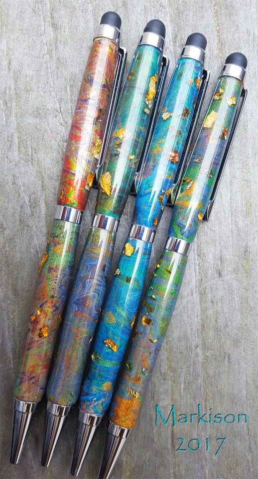

The same hooked-on-silk designer who asked me to make an opalescent hand-dyed/hand-marbled silk pen (posted here some time ago):
http://www.penturners.org/forum/f13/ill-have-silkie-side-opalescence-140706/
heard (through some grapevine that I don't know about) that I've been marbling - so she asked for a quartet of hand dyed/marbled pens - I obliged; steps:

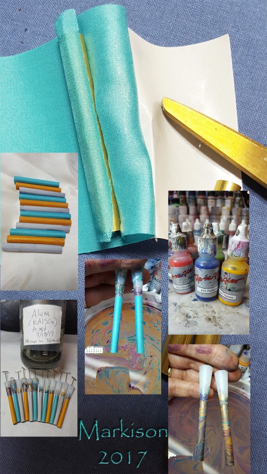

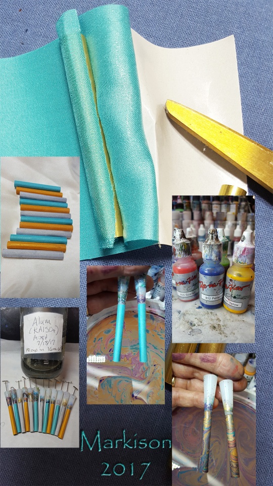

Hand dyed 8mm initially cream-colored Habotai silk (dyed with Jacquard silk dyes, wrapped in parchment and gently steamed x 1 hour to to fix the color, then hand-washed with Synthrapol detergent, tumbled dry, ironed).
Silk run through the Xyron to apply a permanent adhesive layer on the back side.
Silk then adhered to (acetone cleaned) brass tubes, trimmed.
Silk then alum'ed (using a more concentrated solution, i.e. 1/8 cup of alum mixed into 16oz. of warm water).
Tubes dried overnight.
Marbled paintings done on methocel-thickened water (as explained in earlier posts) with Jacquard Dye-na-flow dye mixed with tiny amounts of Jacquard mica.
Alum'ing/marbling sequence repeated a second time, dried overnight.
Sealed with Judikins Diamond Glaze, dried x 24 hours.
Tube-in cast with Douglas and Sturgess Clear Casting Resin with some metal flakes and mica powder mixed in for color and texture harmony.
Turned and finished as usual:

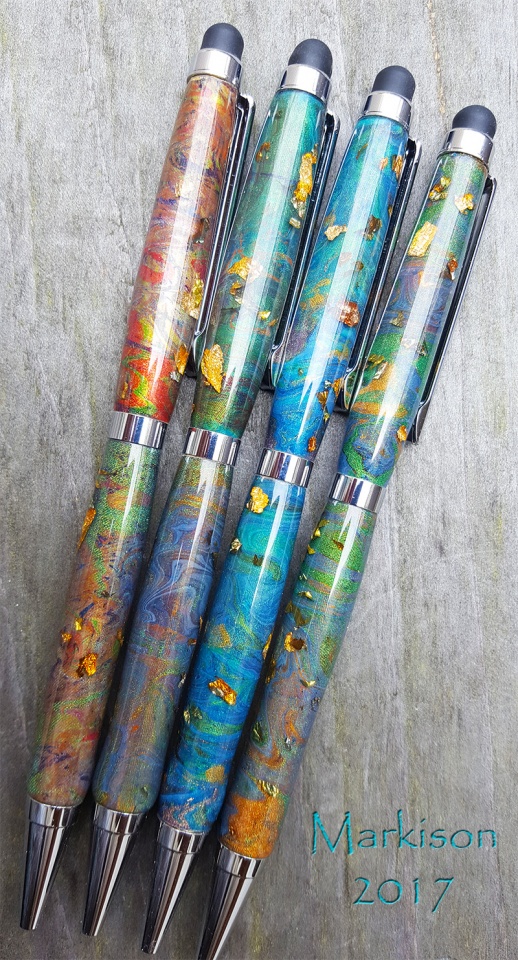

attachment.php
attachment.php
She's happy, so I'm happy.
The technique is opening up some creative possibilities - and now she's talking about a pen/scarf/bangle combo (why not?).
Happy Sunday to all - Bob

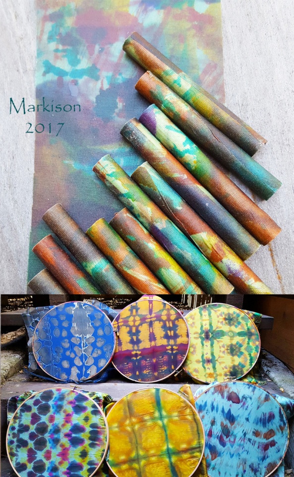

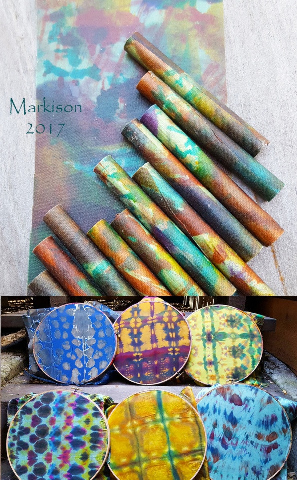

Silk is an ideal dyeing/marbling surface: thin, thirsty for color, strong, with a minimally visible seam after marbling..
I've done some more Shibori-style silk dyeing and will soon marble it.
Stay tuned.
Always glad to show little steps.
Warm regards, Bob
Shibori-dyed silk tubes, ready for marbling:
