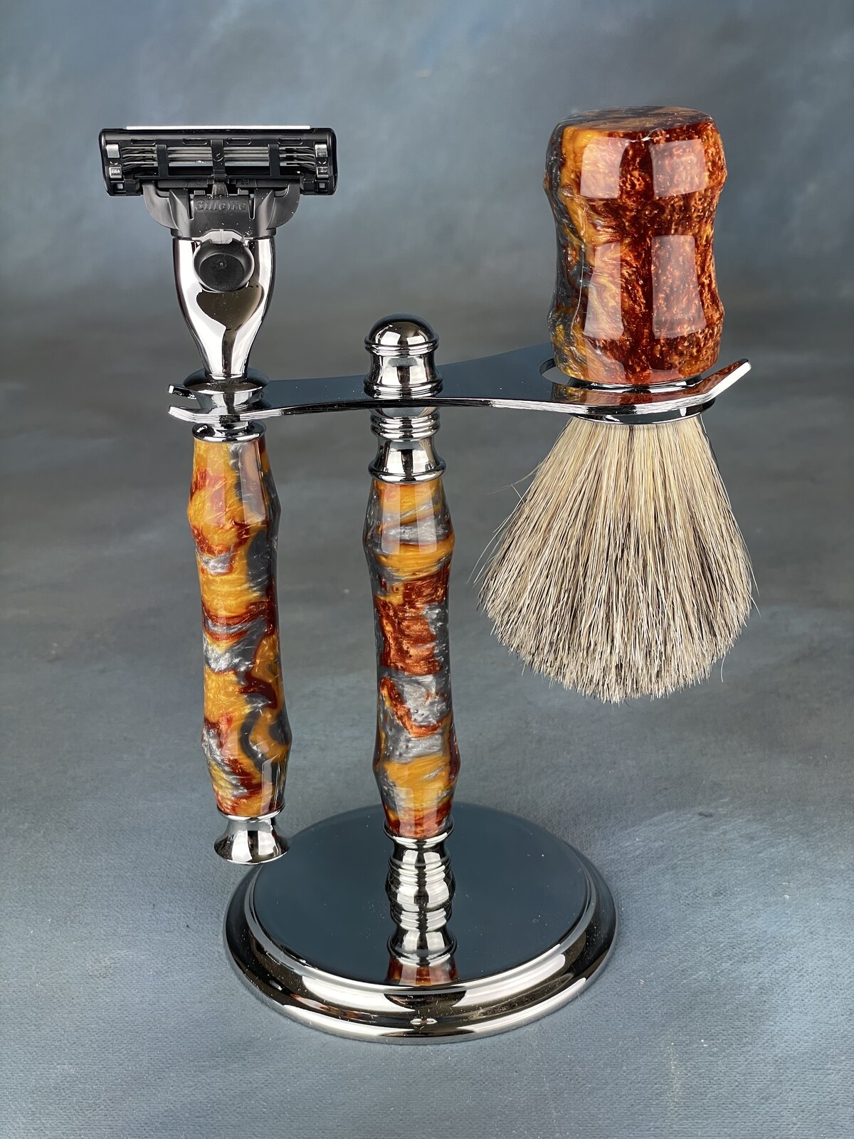

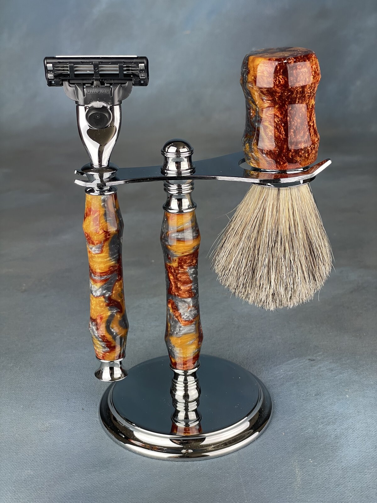

I always turn with official TBC bushings and will never return to mandrels/stock bushings for turning. I make TBC bushings for sanding and bushings with a center hole for buffing on my 3D printer. The system works and I have sets of bushings for every project I make and there are quite a few.
Shave handle and stand turned with metal TBC bushings then sanded with my printed TBC bushings. They were buffed using my printed buffing bushings.
Your mileage may vary…
