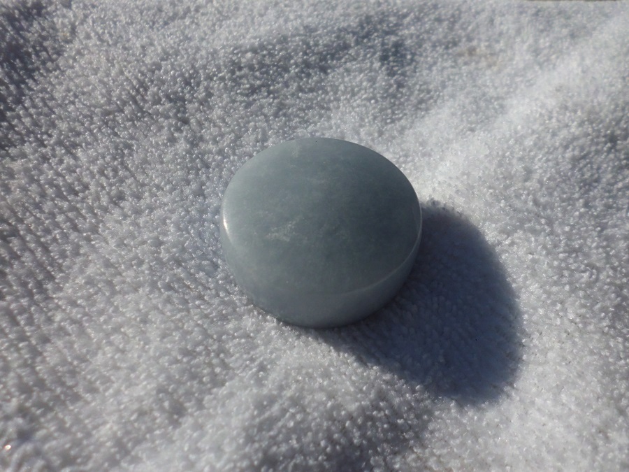

It's a sunny day!
attachment.php
It's a pretty little paperweight .... bout the size of a half dollar, I think?

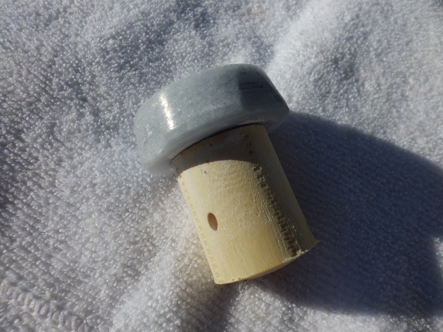

Trying to turn another similarly sized chunk reminds me why I decided NOT to turn the blue alabaster pen ...
While I do have a carbide tipped tool, I have only the one, and the insert is getting a bit dull. And VERY HOT.
attachment.php
I took this off the lathe to show you guys .... the edge that was being used was the sharpest I have left on it, so I'm going to have to chance sharpening that carbide insert or order a replacement. You can see the sides appear to be nearly polished by the burnishing action of the dull edge. It's not even fully rounded yet!
