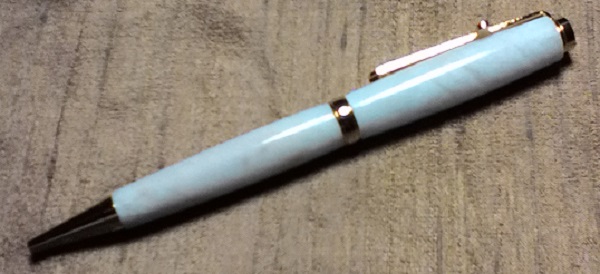

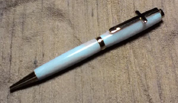

In fact, here's a pic of a finished pen in the exact stuff I'm taking about, and it's in the IAP Collection as pen #1...
Just beautiful .... They'll sell you a chunk that's about 4 pounds for 6 dollars, I think. Not too bad on prices.

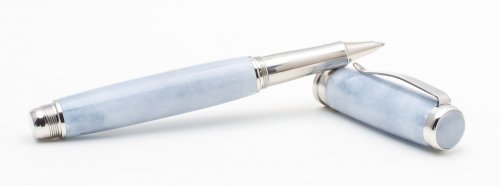

Incidentally, the ice blue alabaster pen shown in my previous post was a work by JohnGreco.

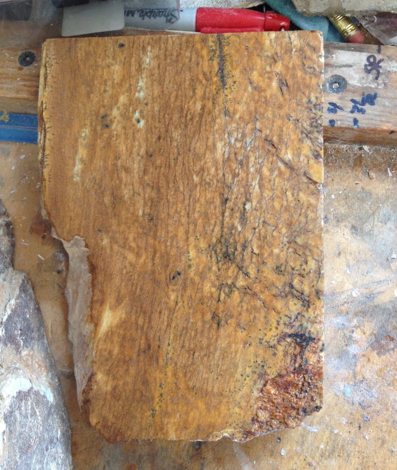

The tile saw slices through this stone quite easily, as fast as half an inch per second, and that seems almost too fast, compared to cutting granite.
I put it up against the fence (forgot to lock it down.... :mad: ) and started cutting ....
Once I locked the fence down :tongue: I cut all the way round the stone to give me some kind of guidance when cutting freehand. I used a simple wood saw. (Pics will be coming soon in my next post ... I'll just quote this post and insert the pics with more comments as they come.)
Cutting with the wood saw was quite easy, and the dust was very fine. It really looks and smells just like drywall material. :P A very fine talc looking powder.
After I cut the slab off, back to the tile saw .... I set the fence at about 3/4 inch and just started slicing my 5-inch long blanks from it. One of the blanks ended up a lil thinner, and I should have planned ahead for that ... I could have gotten the extra material from the end piece that was chipped out.
That same end piece that I cut first because I didn't want it to get in the way, lol ... Beautiful white, though, and mostly translucent... I chopped that one up into blocks for making beads (to practice with).

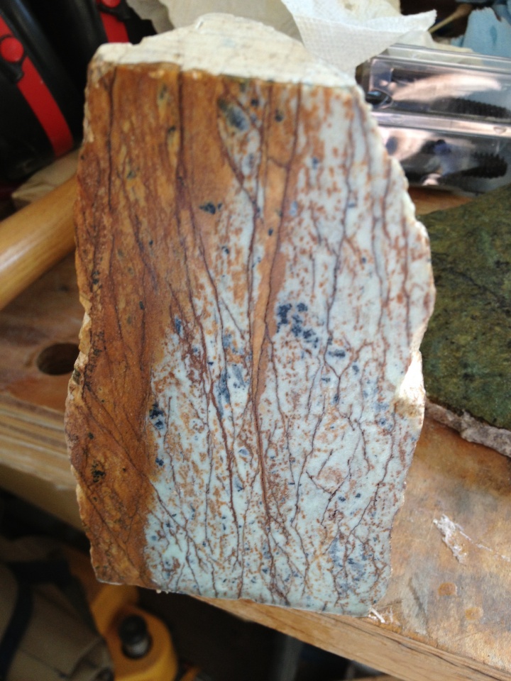

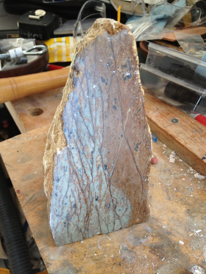

The Alabaster I got was a nice pretty reddish/orange to creamy white, with pink sandwiched in between.
As you can see, dry vs wet, the stone shows much better color when wet. Just don't leave it wet all the time, the stone will be damaged!

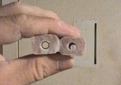

Ok ... first pic here is where I took the biggest blank I had (one of the orange/red ones) and tried to make a pen out of it. Success or fail, I knew I was going to post it, just to show everybody how it went. My first time making a pen from Alabaster...
I don't have a way to chuck this up between centers without putting a lot of pressure on the stone, and I already knew that would turn out badly... So I cut my blanks a little oversized and drilled them on the drill press dry.

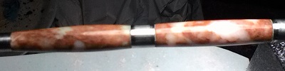

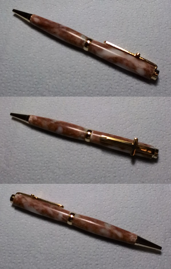

They came out fairly nice ... drilled right through, though I got one a tiny bit off center. I knew that would be OK for the pen kit I was making, a Comfort Pen by PSI... I'll just put that one on the front of the pen.
I turned them rough with a freshly sharpened 3/8ths inch bowl gouge ... I took my time with very small (.5mm) bites and worked it down to this stage ...

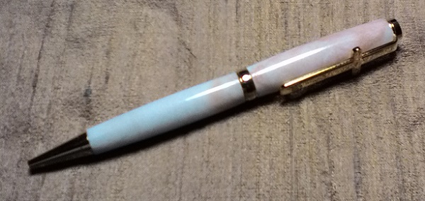

I sanded DRY from 220 grit up to 12,000 grit micromesh (all dry!). The grits up to 1000 loaded extremely fast ... but I took my time as I wanted it to look right. I used some old micromesh pads that I kept around for misc use, as my nice new ones that I just got don't need to be abused... :tongue:
I didn't seal my project with CA as I had originally planned. I want to see how well this pen holds up without it. I did use Meguair's PlastX for polish and shine, and topped it with Turtle Wax hard surface wax. While pressing the pen, a very small amount chipped out on the top half of the pen, right in the middle just above the band. It's hardly noticeable, but it's there. I think if I had used CA as a topcoat, I could have prevented that damage, but this is why I didn't do that in the first place ... to see how it will hold up.
That's it ... I did it ... I turned a pen out of stone! :)

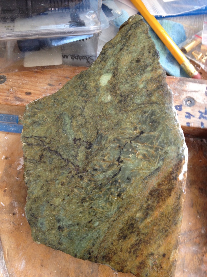

I posted a picture of a soapstone shaving brush I made in a thread I started in late 2013...message #4 of that thread includes the place I got my soapstone from at $1.50 a pound. Here's the thread:
http://www.penturners.org/forum/f45/tried-something-new-tonight-117388/
Here are the links (from that thread) to their official site and their Easy Store:
Sierra Hills Stone
https://www.etsy.com/listing/69421236/sculpture-quality-california-soapstone?ref=shop_home_active
The owner has a couple books out on Soapstone carving plus they carry sculpture-quality Alabaster as well as a variety of colors of Soapstone. If you're worried about asbestos, call and talk to them.
I am finding that a 3/4 by 3/4 by 5 inch block (standard large diameter pen blank size) is sufficiently strong enough for drilling and turning on the lathe to create a pen.

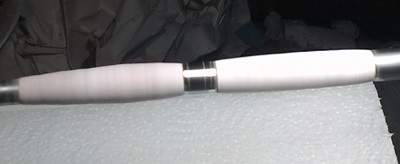

Tonight, I went ahead and turned a nice white/cream with a small amount of pinkish color stone to it. This time round, I attempted to give it a nice coat of CA, but it didn't take. When I went to wet sand the CA coating (I put 6 coats on it), the CA simply sloughed off and I was instantly back to bare stone.
I shrugged my shoulders and went ahead with micromesh sanding (wet, this time), all the way to 12,000 grit. Polished with PlastX and topcoat of Turtle Wax. We'll just have to see how well it holds up.
I didn't have any chipping from pressing the pen this time round, but there was some very sight damage caused by superglue at the edge of the blank where the bushing was glued to it ... I didn't separate it well enough before taking it off the mandrel, I suppose. The damage is very sight, similar to what happened last time, but as this happened before pressing the pen, the damage is quite well hidden under the clip. No other mishaps occurred.
I used Abranet for the first time tonight as well .... sanding at 3200 rpms with my fingers mere millimeters from the stone and I felt NO HEAT AT ALL .... just lovely!. The 120 is quite aggressive, and I could probably use that for final shaping of my stone without all the stress and worry using my chisels causes me with this material.
As for that store you suggested ..... it would be great if I could go there and pick some out myself, but ordering random blocks online without any kind of pictures? And the stones they show online are all dry ... no wet stones to indicate the types of colors that are truly in the rocks ...
The price is right, though .... 28 dollars for a 25 pound assortment of rocks, between 1 and 5 pounds, random color/size/quality. I might try a box of that, sometime ... but if I'm trying to fulfill an order for a customer who wants a specific color, I can't trust to chance.

Right now, I have a reddish/orange color with some white spotting in it (the pen you see pictured here) and a nice cream/white color with some peach/pink in it here and there, though if I'm lucky, I can get some nice pure white/cream going, and then there's the peach/pink color that I really wanted to get my hands on to prep up some high dollar pens for october breast cancer awareness ... My plan is to offer the pens up for a raffle at the local cancer center and donate the proceeds. :)
I got a 21 lb stone from a very generous IAP member for a sweet price ... perhaps half of it is that reddish/orange, 1/8th is the cream/white, and 1/3 or so is the peach/pink.
The white would go well with the chrome with pink crystals ... the pink with the rose gold with pink crystals.
As soon as I get my light box set up (I just bought some old fluorescent desk lamps to see if they'll work for me), I'll see about getting some better pics up.
Here's the pics of the white/cream looking one I mentioned ....
Next up will be the peach/pink color alabaster, but I ran out of pen kits ..... I might just do something original, like a tiny stone vial or vase ....

I'll have to see if I can get my hands on some of that green .... my sister and brother are both partial to that color.

I still would like to get my hands on some of that Italian ice-blue/white alabaster ... but I've got enough to play with for a lil while here. I'm outta pen kits! lol!

It's best to ream/drill the barrel tube ends so that you do not use pressure to fit the pen components together, and glue them in place....
My idea to compliment this was to sand the components so that they fit easily with no binding or pressure, and then glue them in place....
