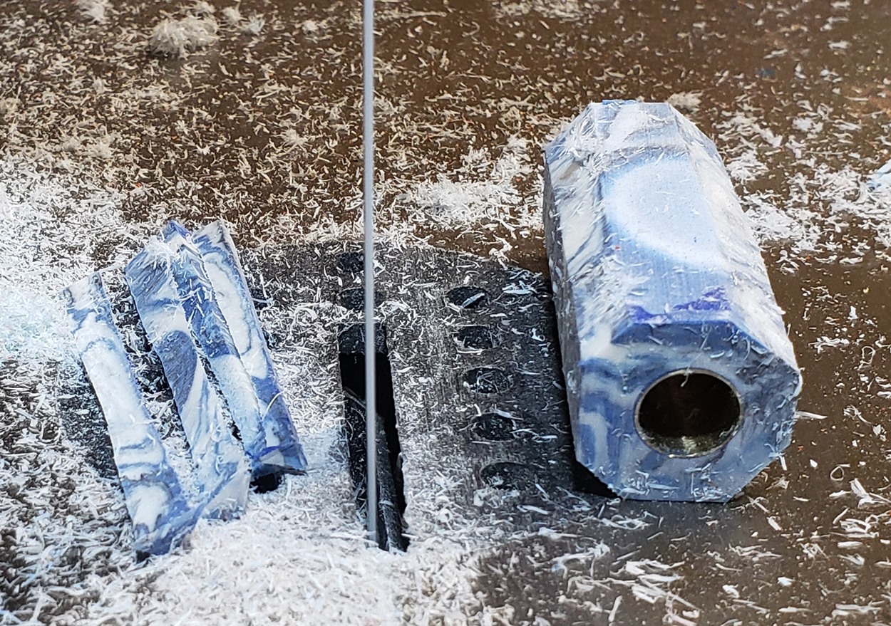

I "knock" the corners off on the bandsaw before I turn acrylic blanks. Makes it much easier to rough them. I use a carbide chisel at an angle so I get a "shearing" cut. I turn at 2000 rpm for roughing, shaping, sanding, and finishing.

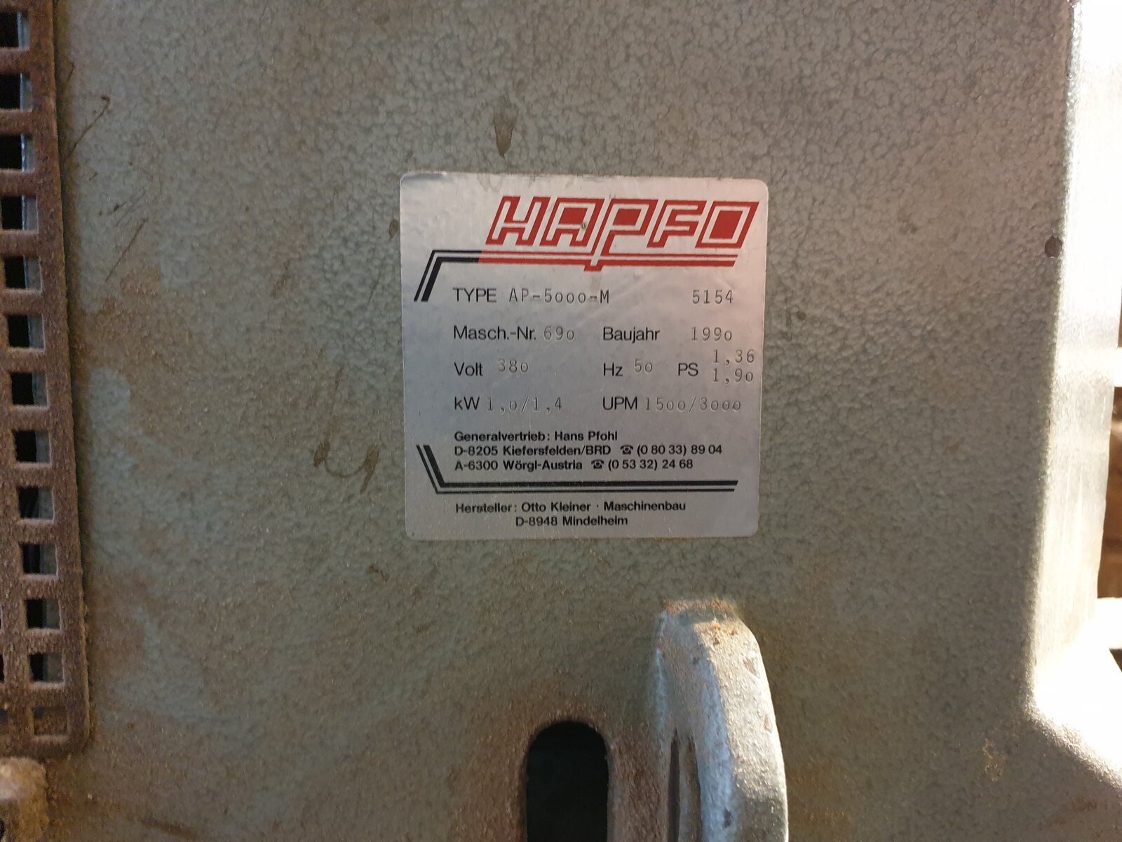

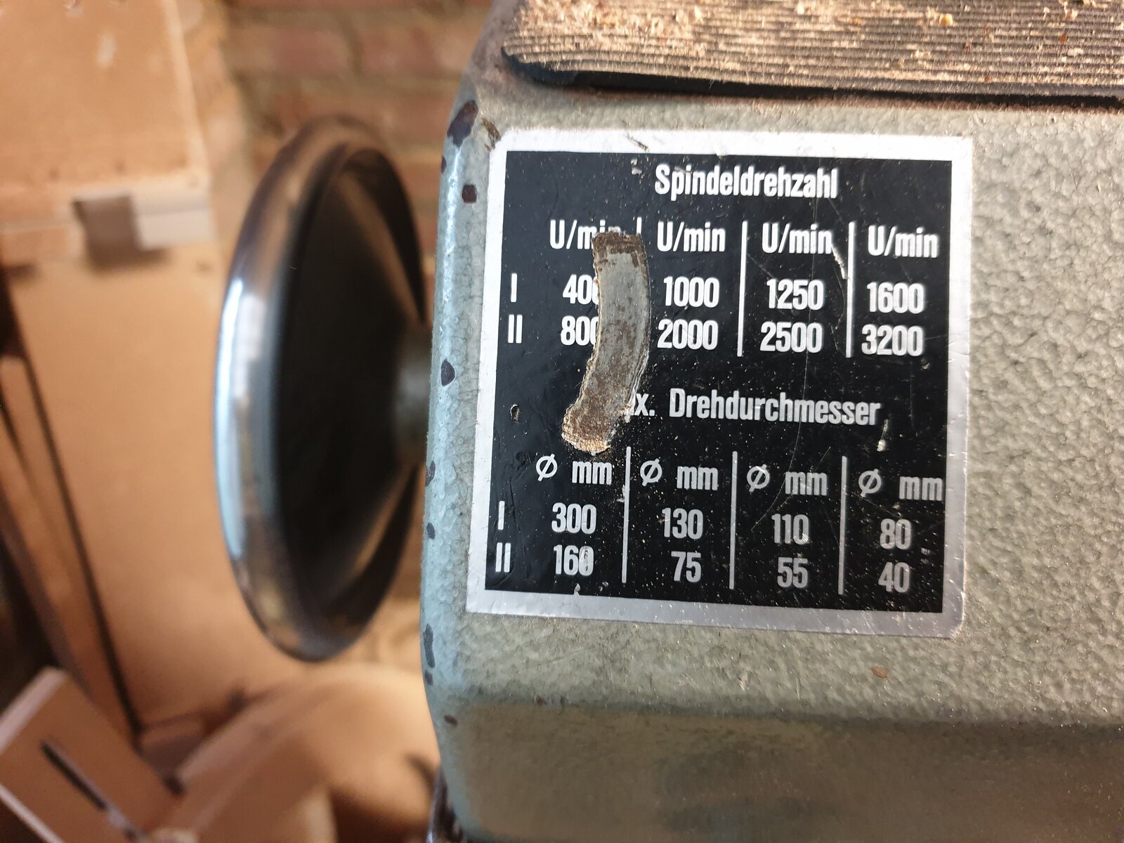

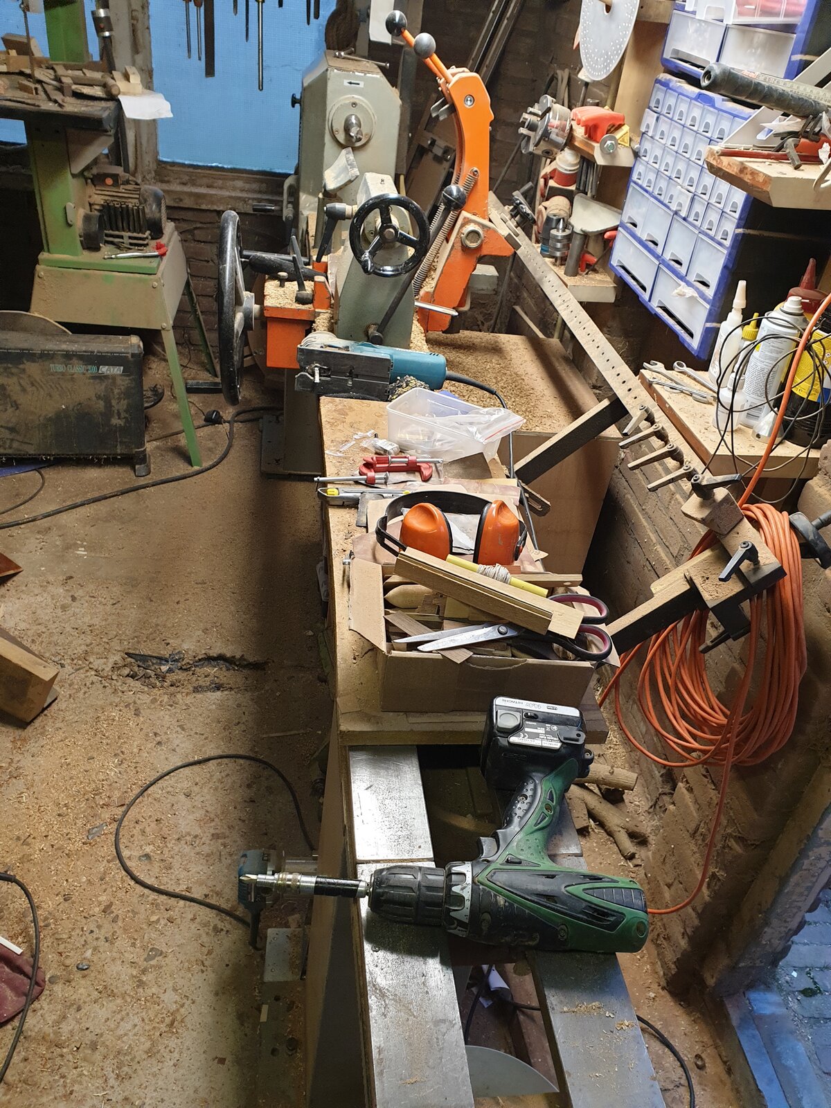

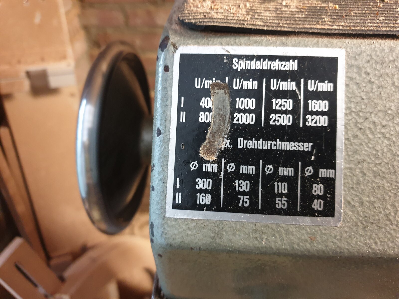

On my lathe is a matrix of speeds and diameter, i'll post a picture here.
It has a 4 pulley drive and 2 electric settings for slow and fast, So beltchanges are frequently done.
400 rpm is slowest 3200 is fastest speed.
Then i use all different turning tools, hss gauges and chisels, carbide roun and square scrapers, but my favourite gauge is a spindle gauge about 13 mm or 1/2 inch, very hard kobalt steel. Powder technology of Crown. Extremely hard and touch
Finally took some pictures of the lathe.
1. the table of speeds and diameters on the lathe
2. specs
3. 2.2 meters between centers and some bedstorage.
