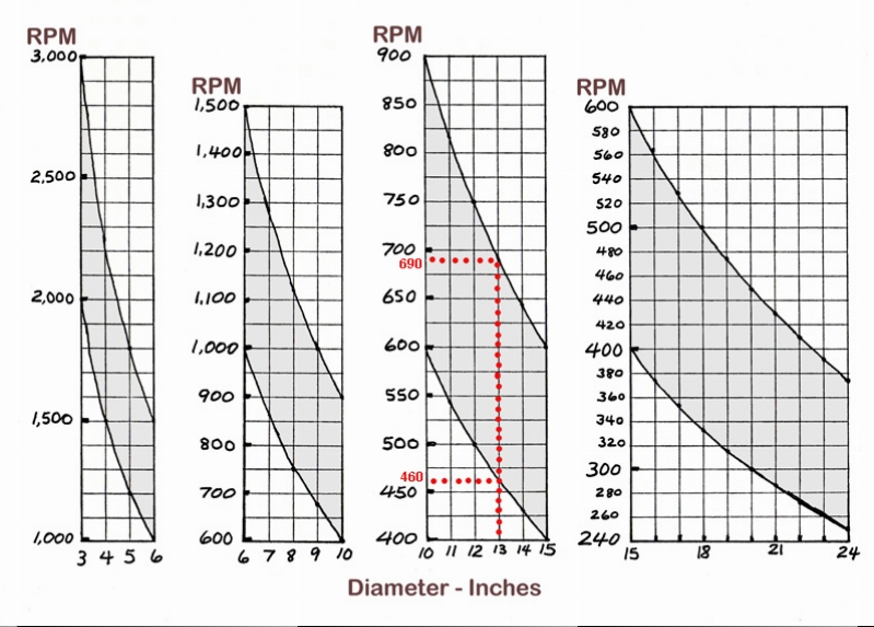

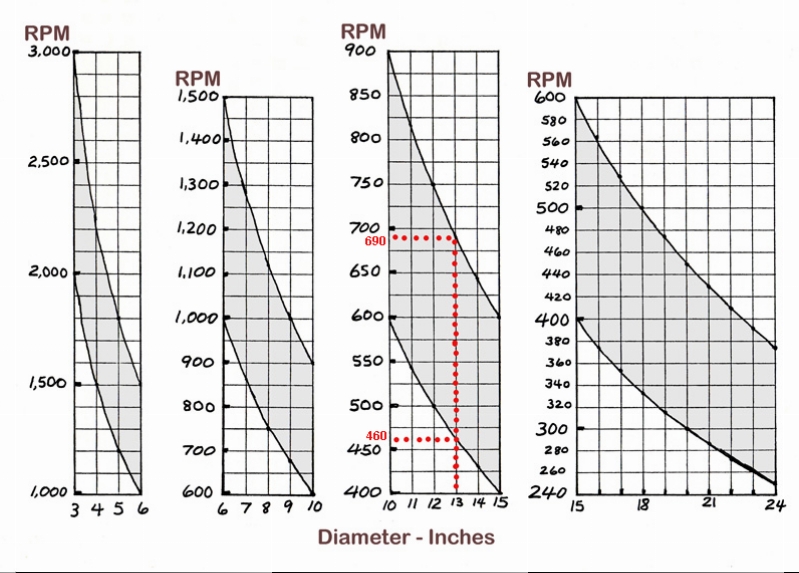

I noticed a few bowl turners in the early days coming over to IAP and turning pens. Some said the had been told 700 rpm MAX and a few others would say 800 or so. While that was a general good rule of thumb depending upon the size of the bowls, it certainly did not translate to pens. even now about once a year, someone will bring that up.
Gary, I occasionally use the simple mathematics that you used - to show how SLOW the cutting speed is at 700 RPM on a 3/4" diameter versus the cutting speed of 700 RPM on a 12" bowl. HUGE difference.
Below is a BOWL lathe speed as it relates to diameter. I would like to see another chart to include 1", 3/4", 5/8" and 1/2".
And That does not include special densities and material.
