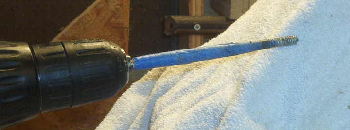

How this barely qualifies as a jig. It is painters tape on a piece of ¼ threaded rod. I turn on the drill and stick the tube on the end holding the tube with 100 grit sand paper. As you push towards the drill the tube spins and when you pull away it stops. I don’t touch the tube with my hands so no oil problems.
