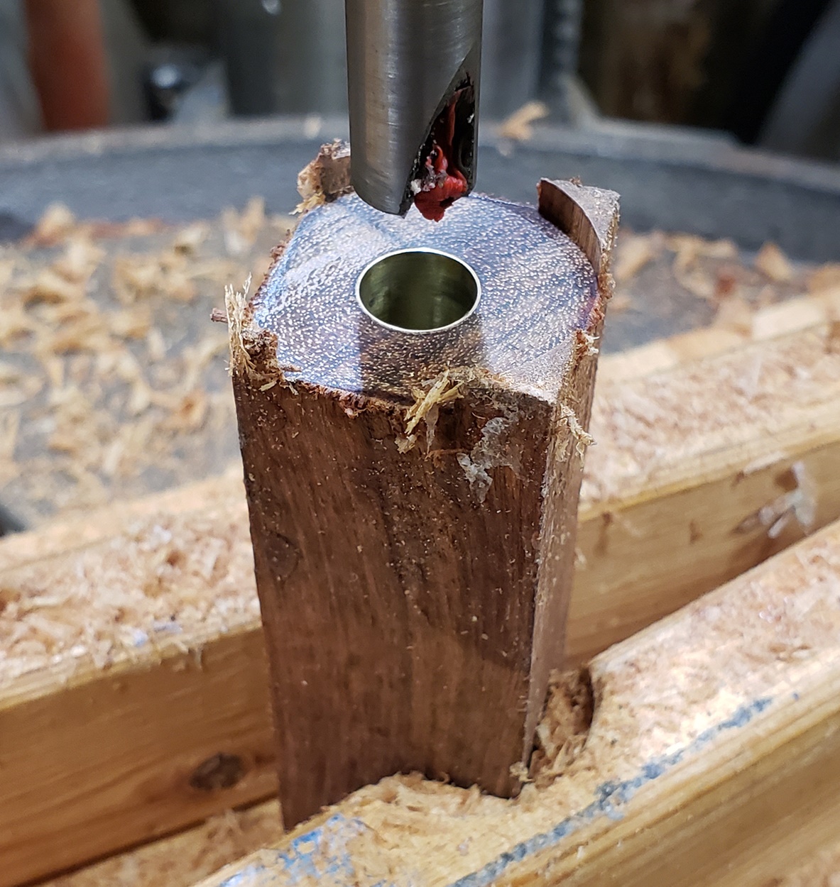

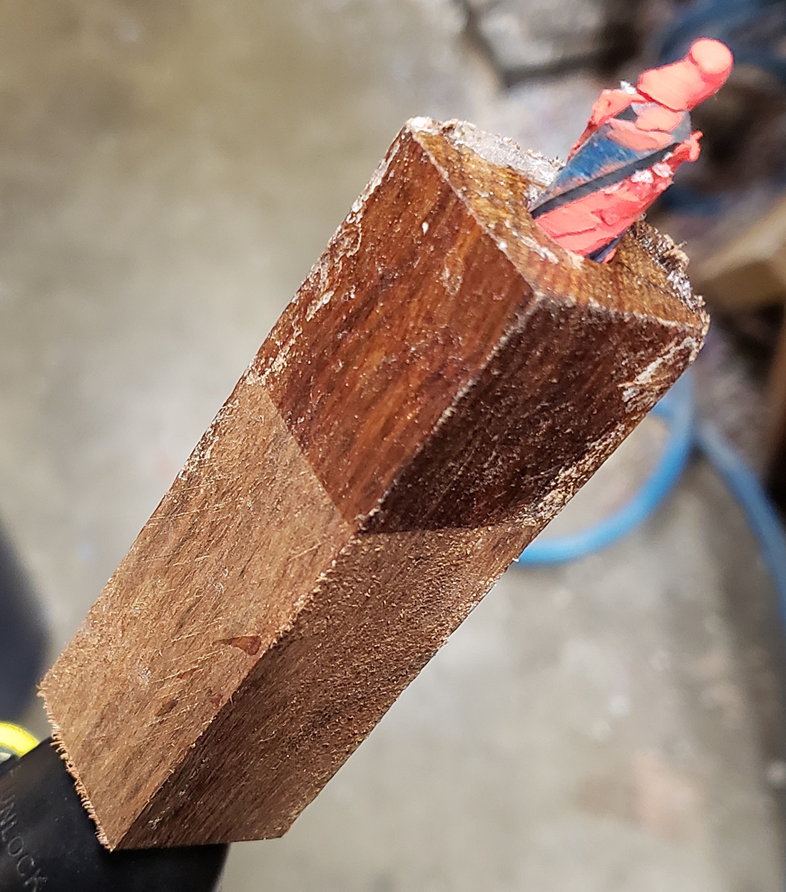

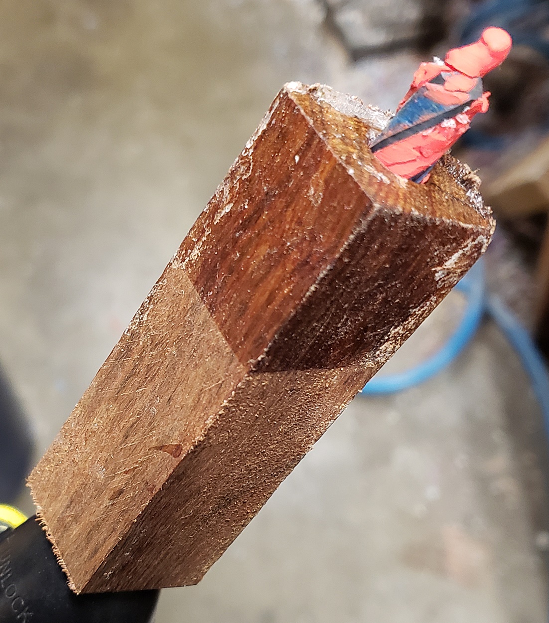

I press the tube into a sheet bees wax each end. After the glue sets pick/cut the plug out to a clean tube. The wax was sold for candle making where the wax is rolled around the wick to make the candle. Other people use dental wax or plumbers putty. Point is to keep the glue out of the tubes to begin with.

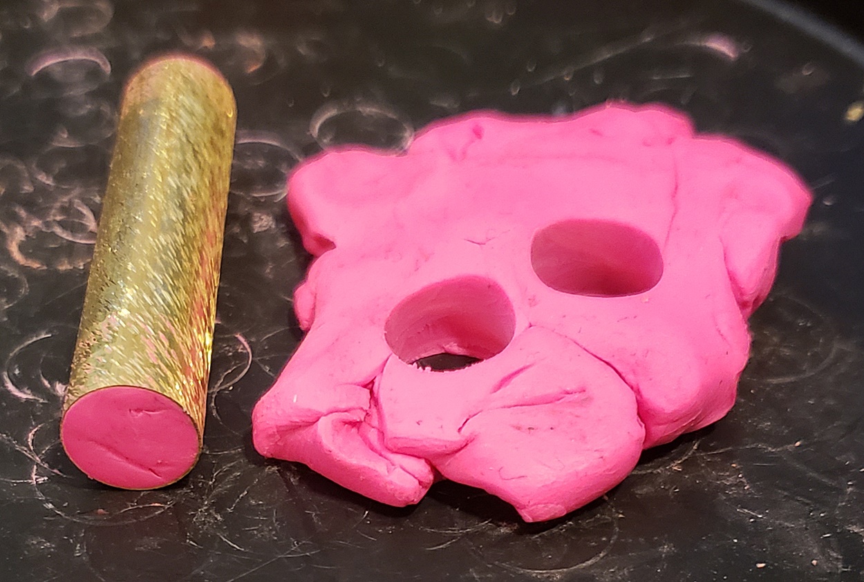

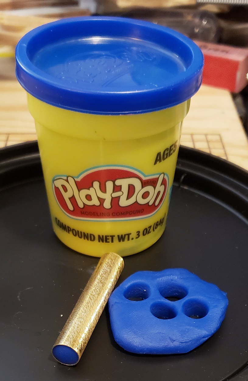

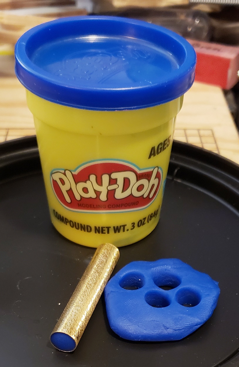

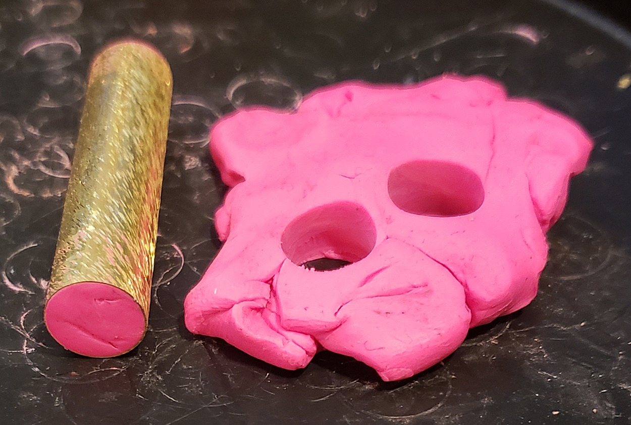

I've been using Play-Doh. But I might try wax, as the Play-Doh doesn't stay put real well. I've started just using it on the end I put in the blank first, the end that goes in last is ok. When I tried putting it in both ends the air pressure would push it out the other end!

I plug the ends with either non-drying modeling clay or Play-Doh. Both have worked well for me. I used to use dental base wax, but I like something a little thicker.

Since my neighbor is a beekeeper I have been using foundation wax to plug the leading end of my tube before applying glue and inserting. Like Jim, I too like a thicker plug, so I usually press my tube in at least 2 and sometimes 3 times. I then clean the outside with denatured alcohol to make sure there isn't any wax residue on the outside that might interfere with adhesion. I use a stick with rubber bands wrapped around it to build up the diameter jammed in the other end to hold the tube when I apply glue and to push it into the blank. I leave the stick in there until the glue dries then I pull it out and pop the wax out of the other end. I also use a round chainsaw file to clean out anything that does wind up inside the tube. So far it has been working great for me. - Dave

I use the pink dental wax to plug the ends of the tube. I use a chainsaw file if I need to clean the tube, I like them better than rat tail files because they're not tapered and they will fit a slimline tube.

I also use the pink sheets of dental wax. It works like a charm. I use a small X-Acto knife to clean the wax out of the tube after everything is done.

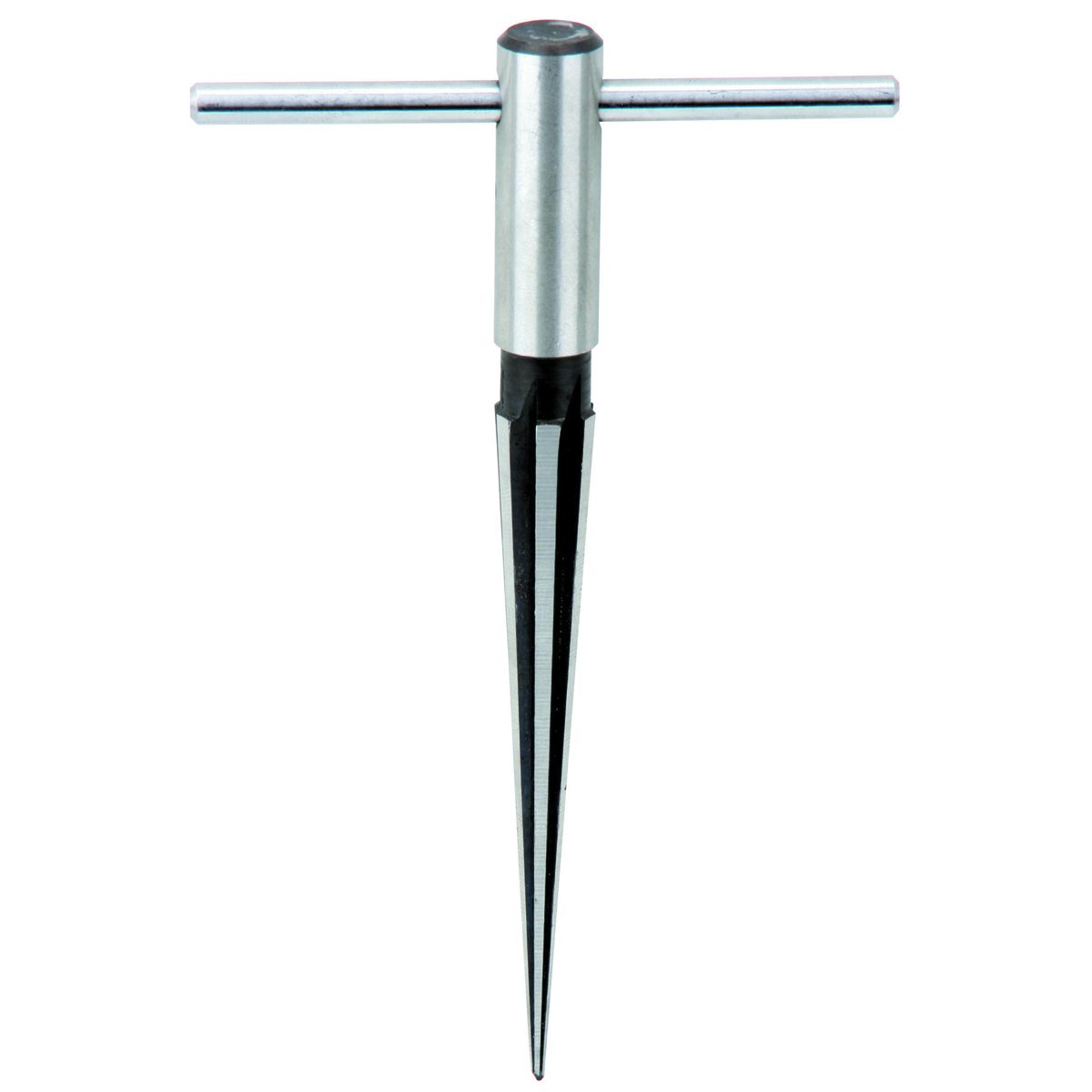

The reamer that comes with an end mill kit, without the end mill. That's what they're designed for. I have one in a wood handle. A couple twists and the epoxy is out.

I tried dental wax and play-doh multiple times. Neither worked out very well for me. It was more effort to clean out the wax or play-doh than it was to deal with glue issues.

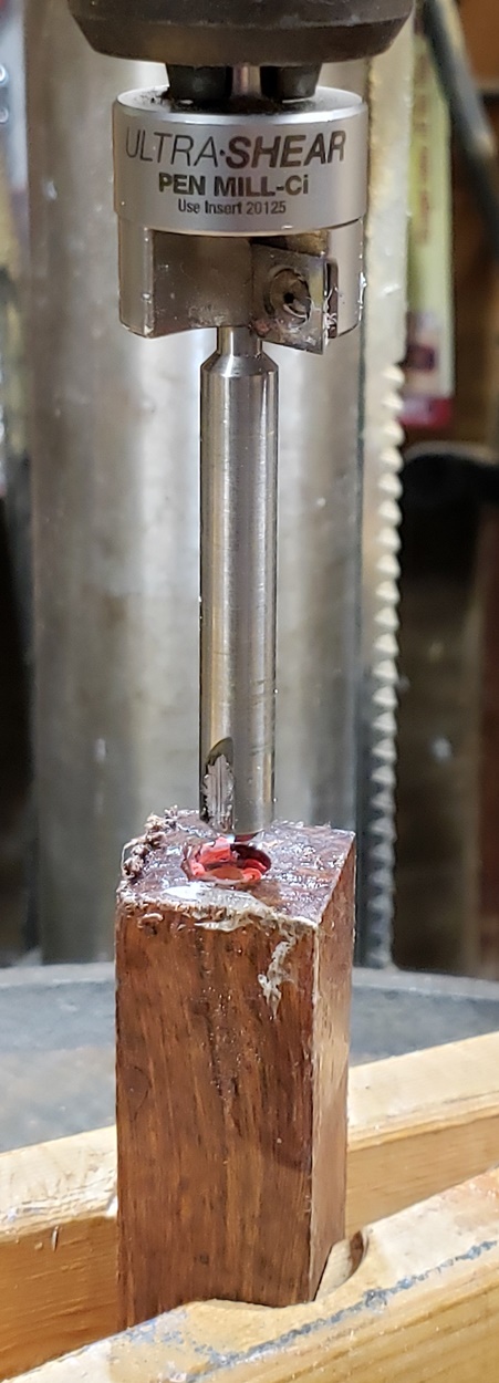

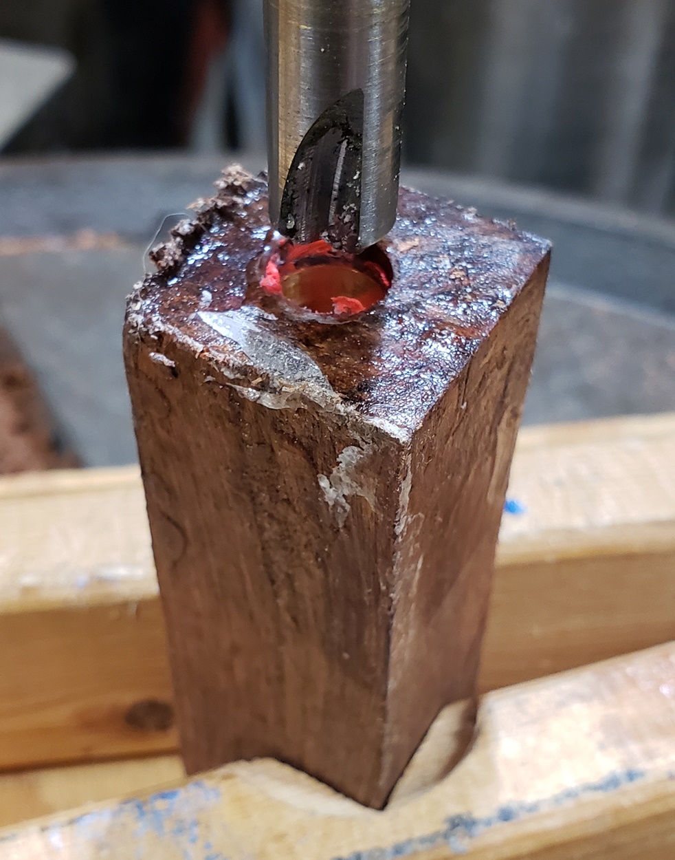

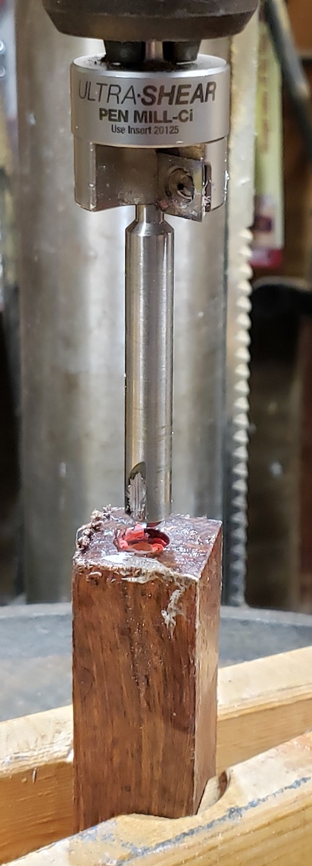

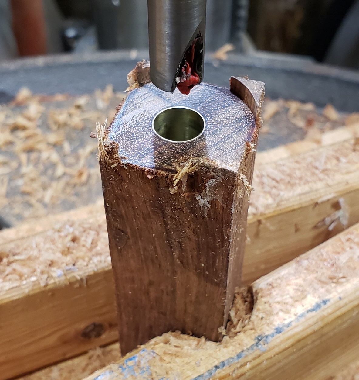

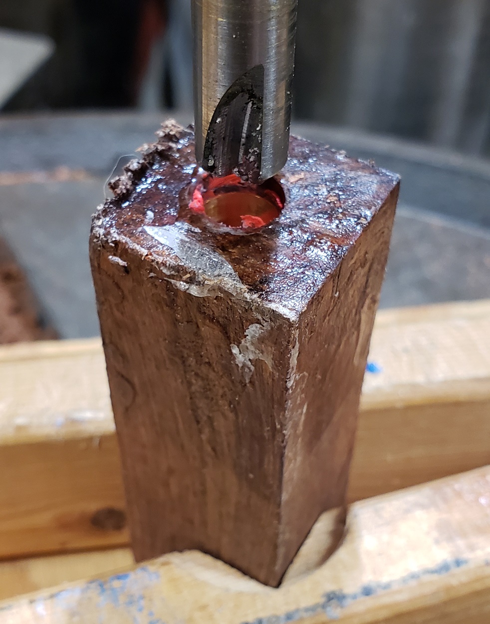

I use what I call a "cleaning drill", a drill bit that fits inside the brass tube. Plus, the pilot on the trimmer cleans it further. I rarely need to do more, but if necessary I'll scrape inside the tube to remove any remaining residue.
