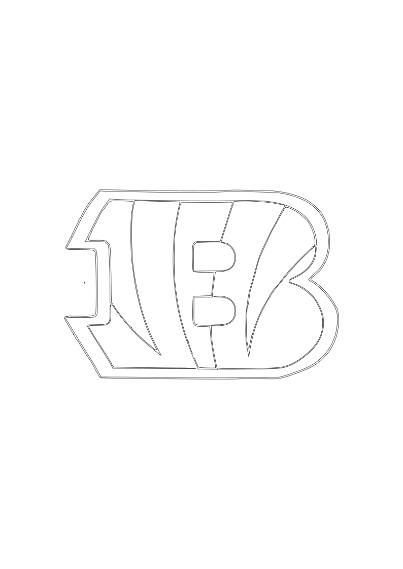

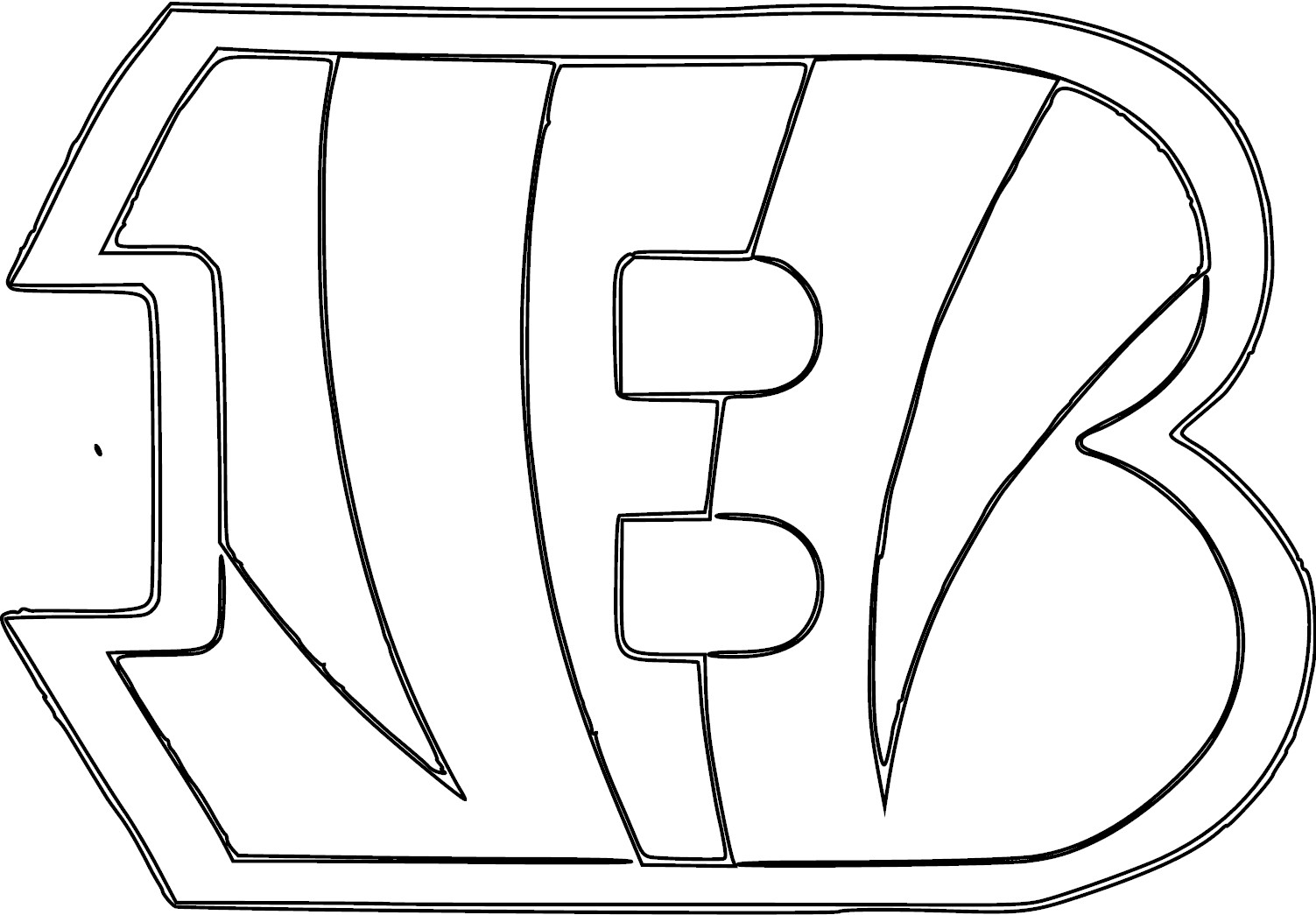

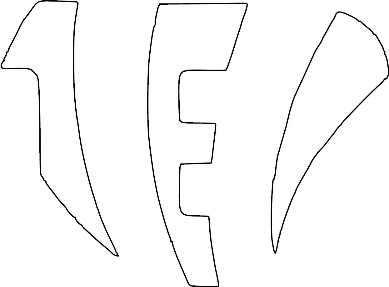

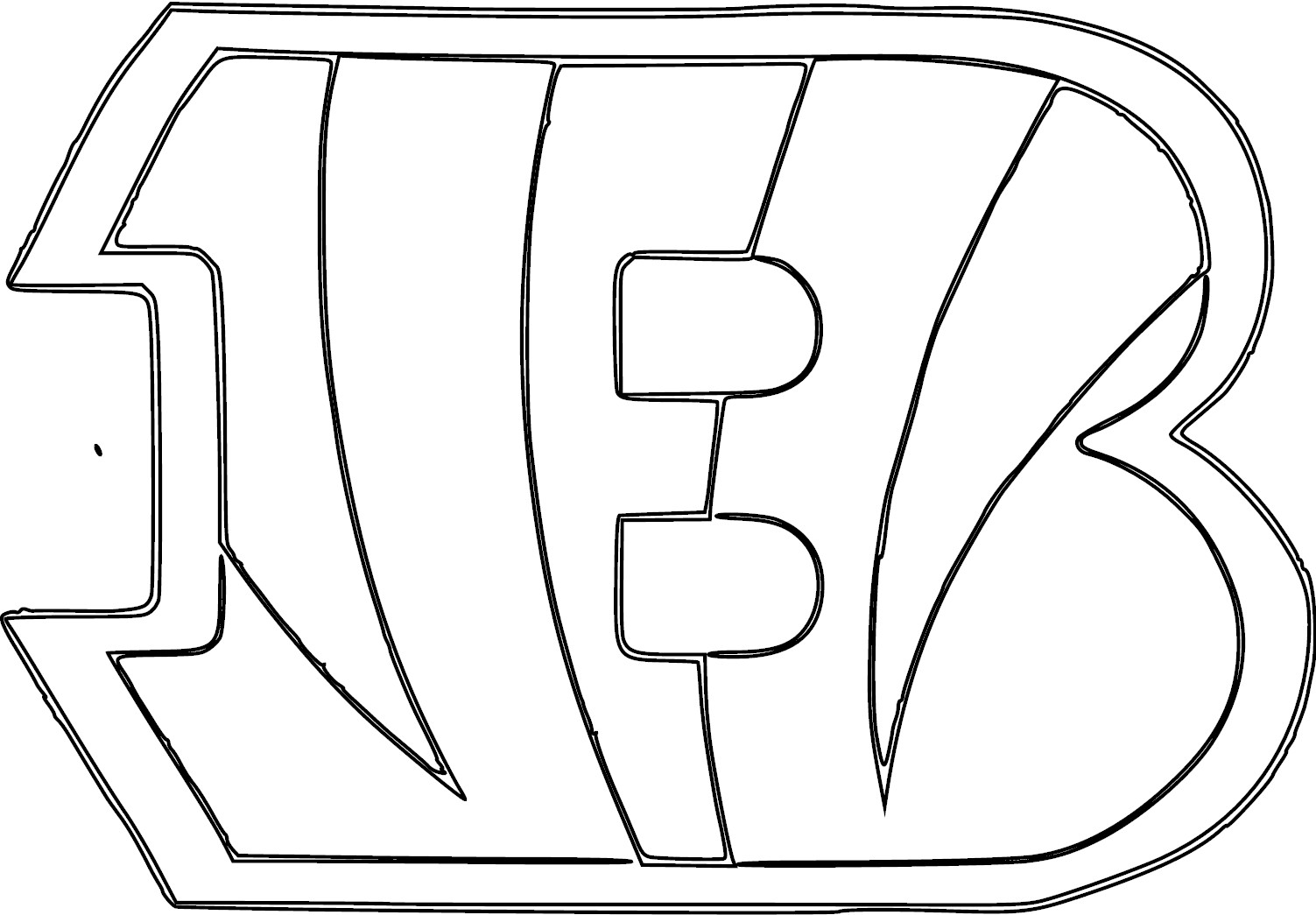

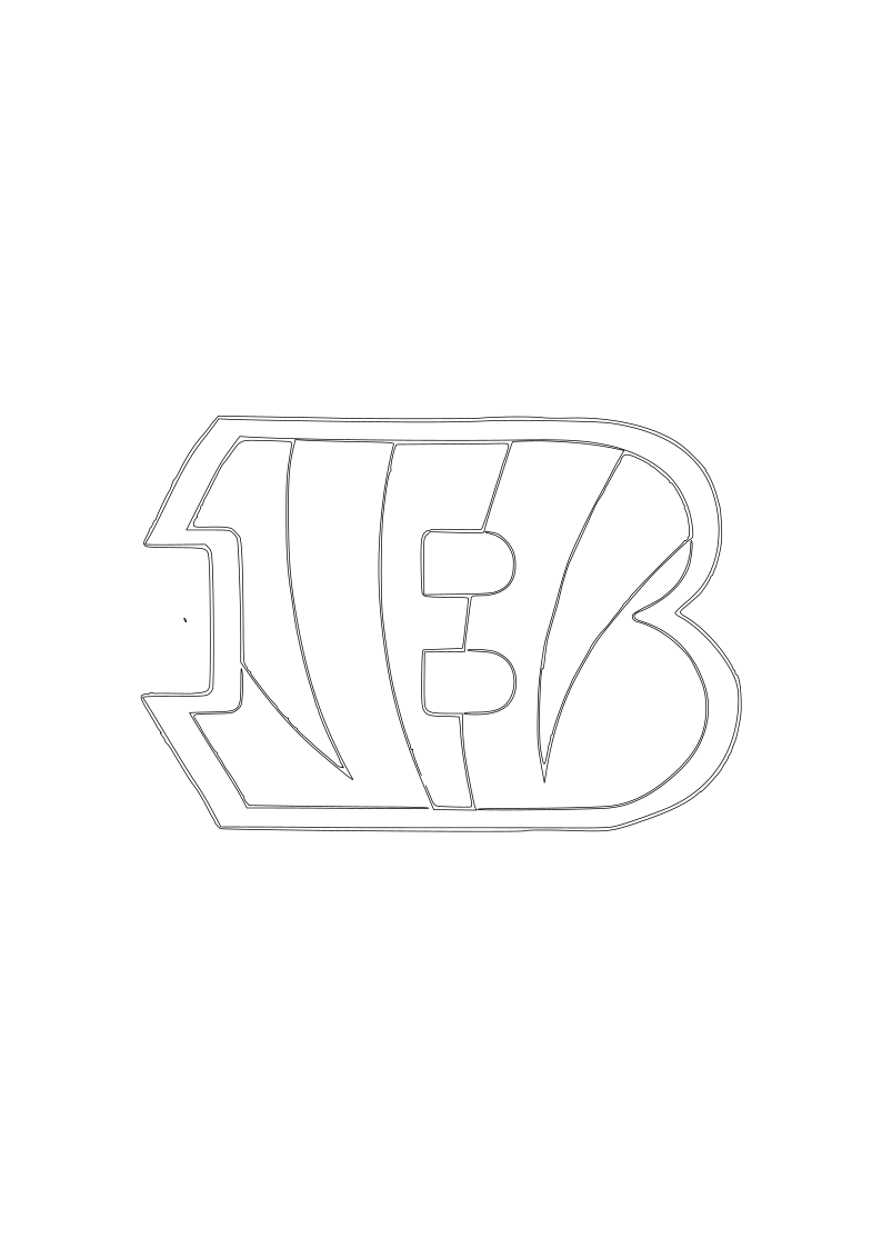

You will need to create a vector file of the image in dxf, esp or similar format. Heres an image converted to vectors using Lightburn, you can also use Inkscape or other vector programs. You can also trace this by hand in a vector program. This is a png image of a vector file. You would select the vectors you want to cut. Placing the vectors on different layers helps to visualize what gets cut. I haven't used vcarve pro for a few years forgot much hopefully this helps. The image was made considering a 10x10 inch size with .5 inch depth.

I am thinking you might want to do this in a different manner. Not sure a v-carve will work with (2) adjacent colors, but I have not tried that yet. Did you want the orange and white colors as a relief in the project with the black on the surface?
V-varve pro has a fairly decent tracing utility to create the image that smik displayed above.

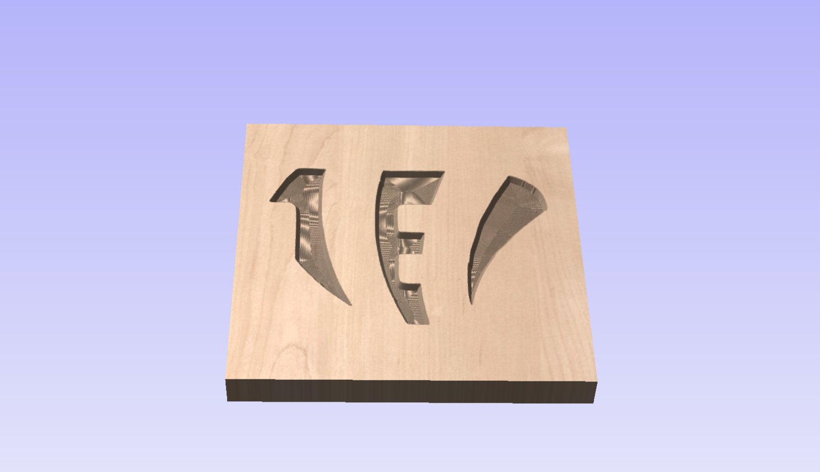

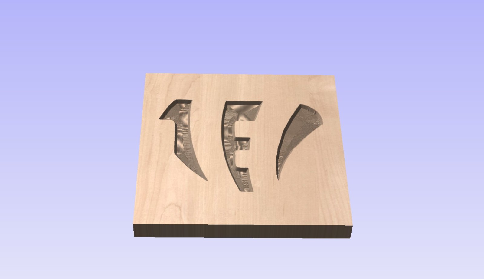

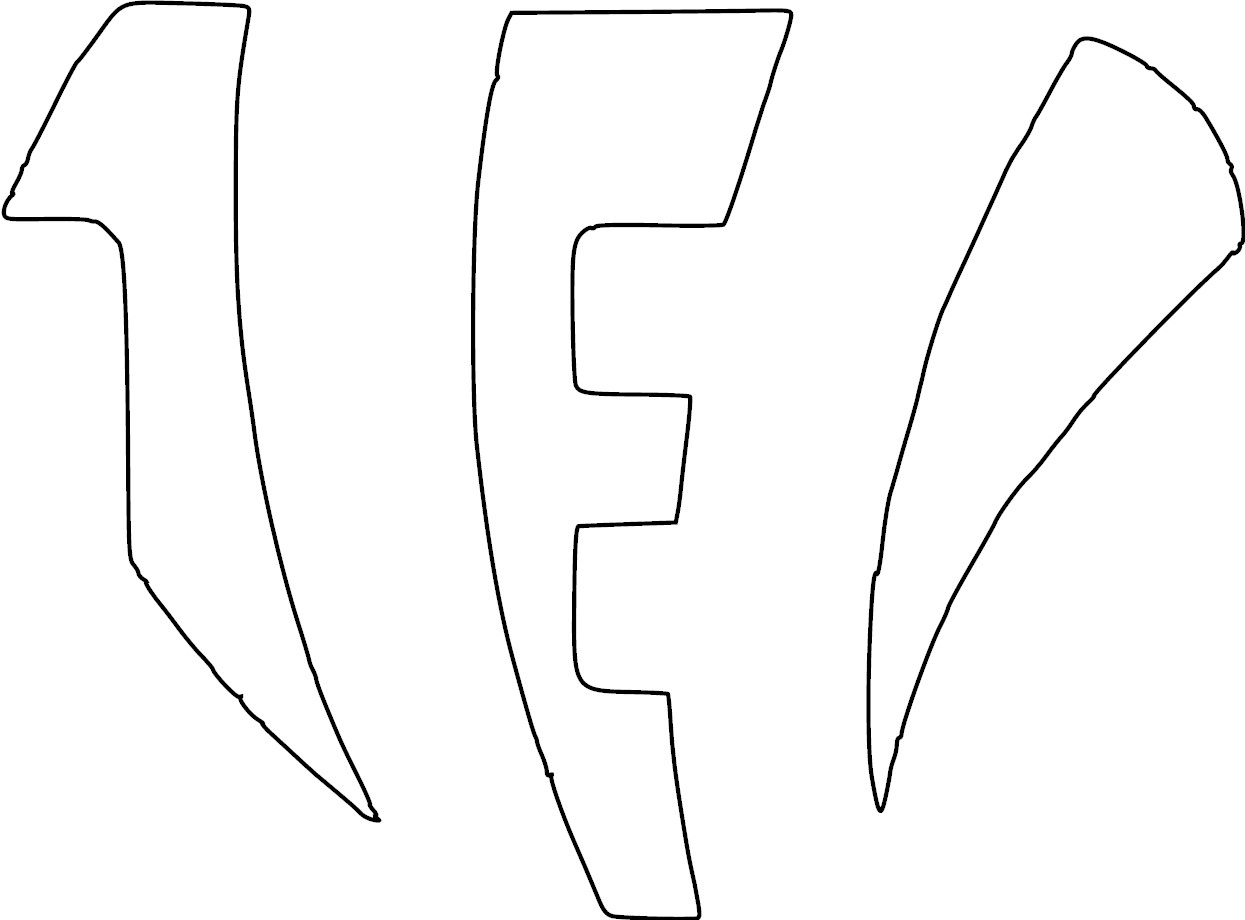

The program gives an idea what your cut will look like. Here using a 1/2" 60 deg v-bit on layer 1. The vectors in this image would need to be modified to how you want to make your design, I just did a quick pick of vectors without any concern to how actual output would look.

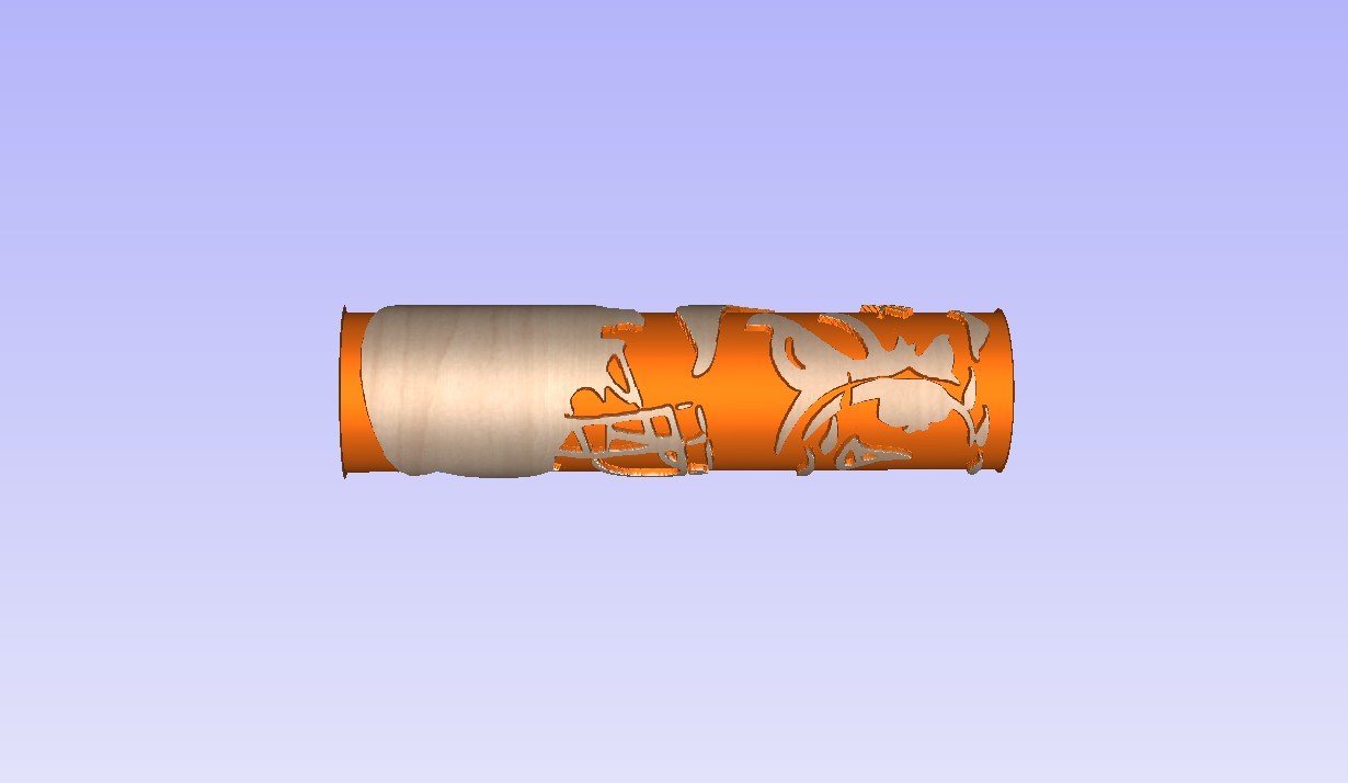

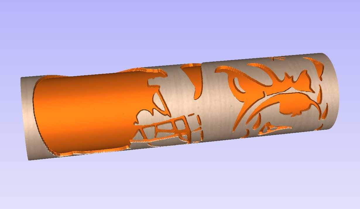

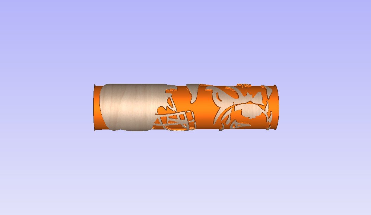

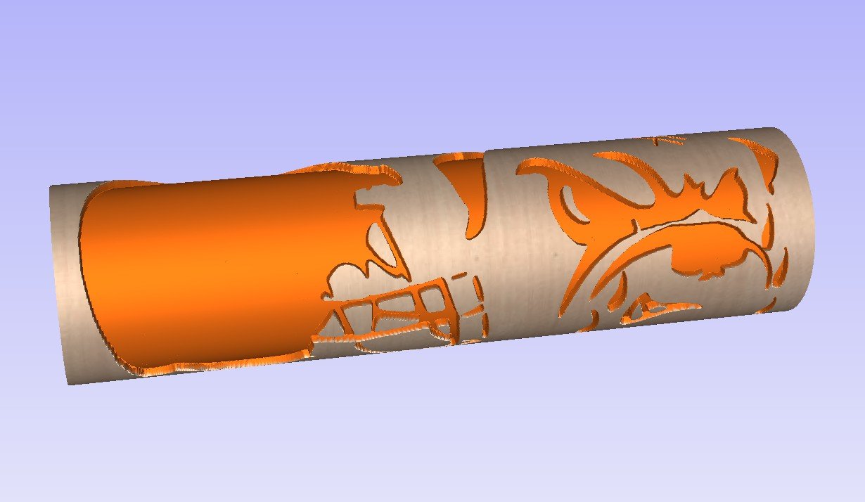

Couple pen blank designs.

Thanks for going over the process smik and the image. Those steps sound in line with the processes I remember seeing in the Vetric tut videos I've watched over the years. I'm guessing if I find a more professional image and convert it to a vector file through Lightburn, like you mention, the lines would turn out better.
Yes, I was hoping a solution would present itself (Jedi reference anyone?) in the matter of the two colors touching. After looking at the image more I think it would go over just as well if all the color sections were separated by a small black line, and that would solve the problem of the color border / colors bleeding over.
You're right in that I was thinking the orange and white would be relief and the black would be the surface. The plan would be to color treat the entire union black (either stain or dye) before any relief carving is done.
