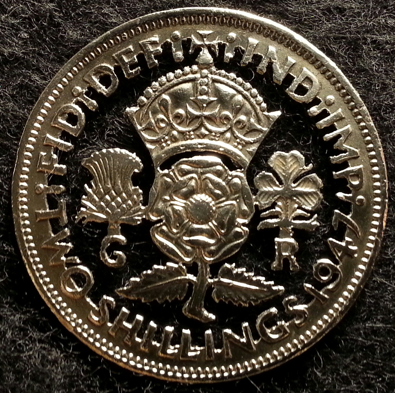

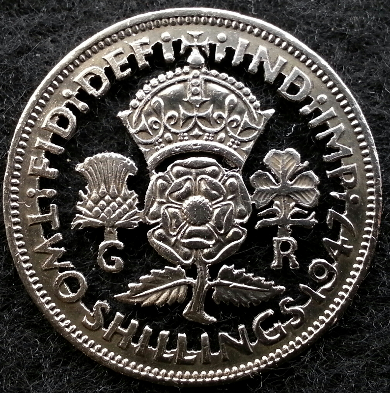

I decided to try something a bit more intricate. This time by cutting into the surrounding letters to give a little bit more "WOW" factor. Or so that was intention. Comments welcome!

Ok Seamus May be you have shared this and maybe you have not. But how thick are these before you start to scrol saw them ????

Lin, most coins are 1/3rd the thickness of the standard coin itself, if not thinner, which is what makes it that much more difficult to cut.:eek:

IIRC, this took 3-5 hours to complete. But over the course of two separate days. There was a lot of "blade dragging" with this one. Meaning: scroll saw was off(gives me more precision with the blade), and dragging the coin up and down the blade in order to make most of the detailed cut-outs.
Thank you for all of your comments thus far. I still think i should have taken the letters all the way!

Since Fred is gonna bust my chops I figured I'd better drill that "R" out. LOL. Every time I have looked at that coin since hearing that, it's like a nagging thorn in my big toe.
In regards to the question of whether I could take on wood carving, I personally don't feel like I have the foresight to see what it is that I am carving and knowing every angle that is needed to create the piece.

1. Do you hold the Coin in your fingers, and manipulate it, to cut? or
2. Do you have a holding jig, that would give you a little more comfort, some mechanical advantage, and greater travel distance?
