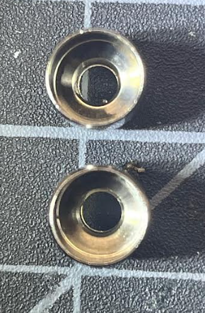

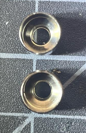

I have had a similar action to your click mechanism. There is a very tiny ball bearing that sits inside the click mechanism (SKM-88). It almost looks as though the little tiny ball bearing is missing or has come out of the channel it sits in. If you decide to investigate this, be very careful. The little ball falls out very easily and will never be found if dropped.
You can see the ball in my top example, missing from the bottom.

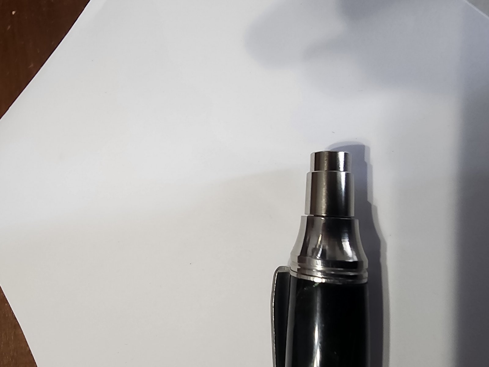

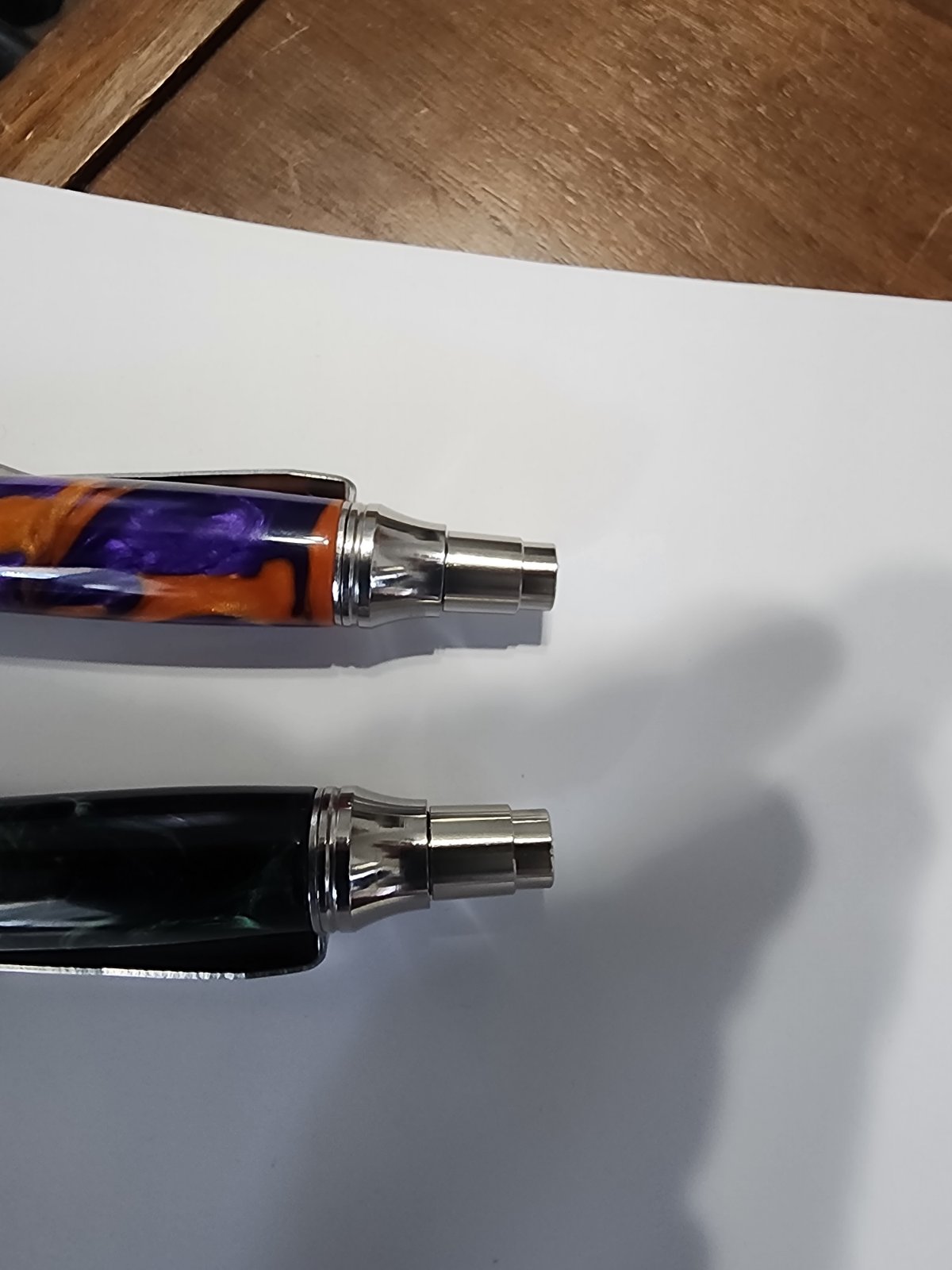

Howdy! Thought I replied to the one email I saw about this but the danger of being a one man band is that sometimes you miss stuff.
While it's possible for the mech itself to be faulty, it doesn't happen often. In the thousands of these we've sold I've had maybe 1-2 where it was the click mech itself.

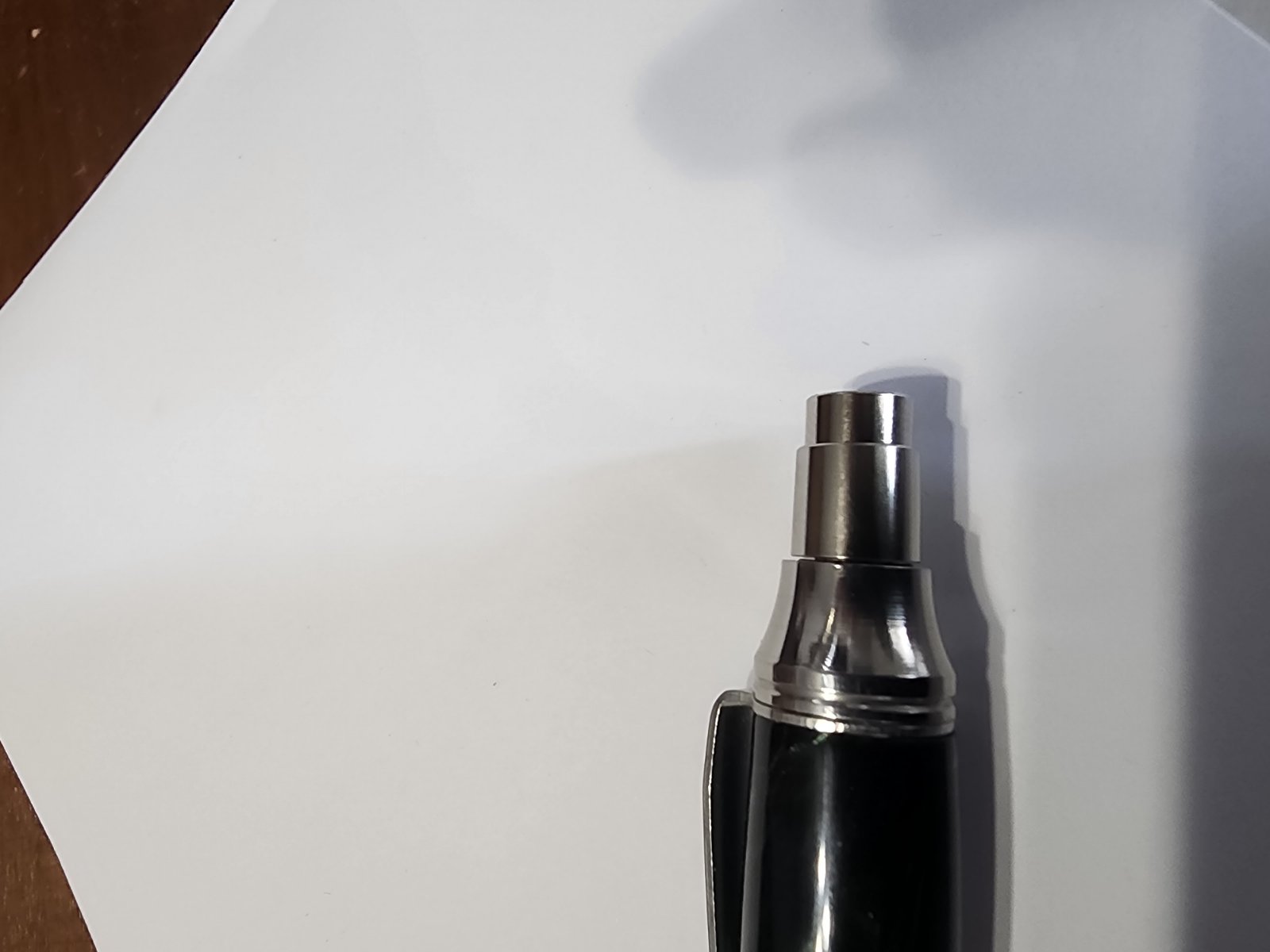

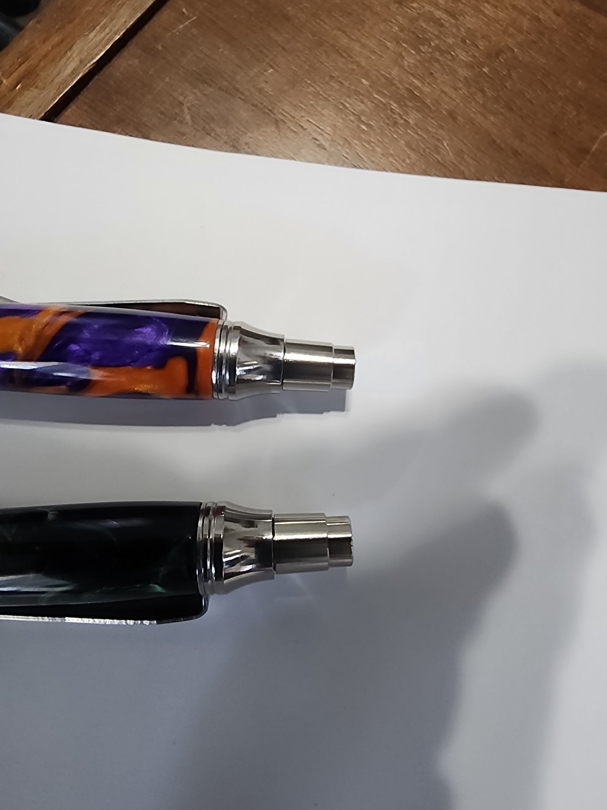

The achilles heel of the Schmidt design is the length of the tube. I, unfortunately, went exactly by the length given to me by our machinist when we designed it and I ordered the tubes. As a result it's basically the exact right length if it's not trimmed at all. Trimming into the brass even a little will potentially cause the mechanism to be slightly less than reliable. Our next batch of tubes is going to add .1-.2mm to the length which may not sound like much but in my experience should make a big difference.
Good news is... it's pretty easy to resolve. Take the mechanism out of the pen and just touch the end of the small post to your sander for a second. Don't remove too much material, just a tiny bit. Then put it back together and test it out. Repeat if needed.
I'll dig through my emails again and get back to you there but pretty much 99% of the troubles we've seen with the Coyote Click is this. Learned from that when we added the Liberty click and gave it a bit more wiggle room for trimming. Also, if for some reason you end up screwing up the mech just let me know and we'll get ya one.
Oh side note... Andy's idea for the oring to keep things tight is a good one. We've been chatting on the website chat function and I think he found a size that works well if you don't want to use something like blue loctite. Incidentally, you can always reach out through that and it'll message me on my phone.

Thanks for the reply! Also got the email; appreciate it. Good to hear the problem and solution. Both these blanks were cut a bit long, so I have no doubt the trimmer clipped the brass, even if just slightly. Will give this a go tonight and see if that fixes the issue.

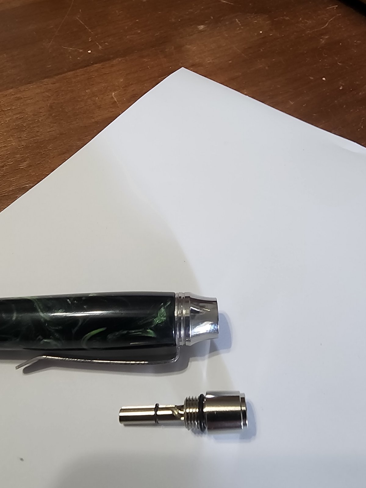

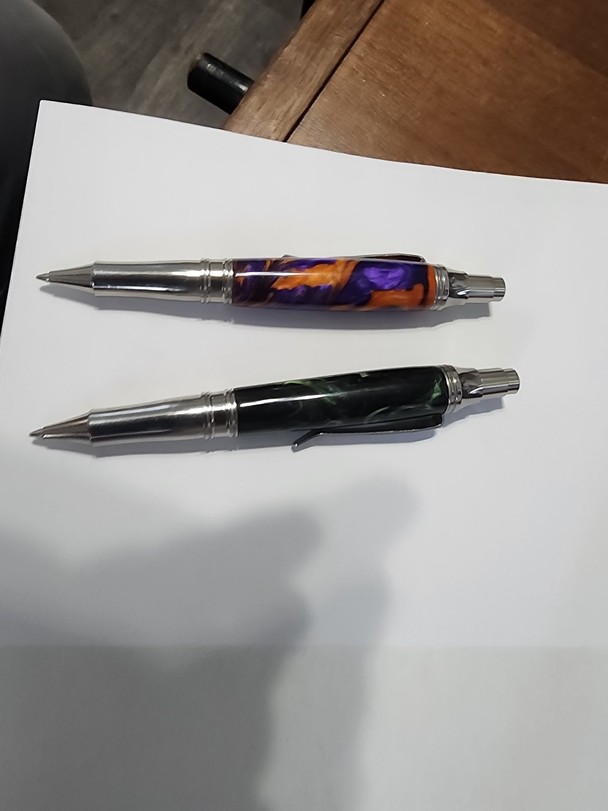

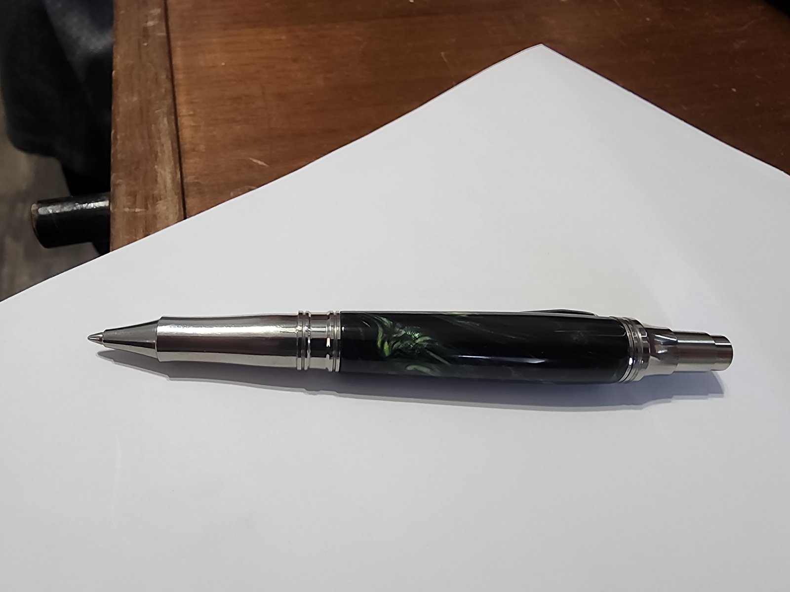

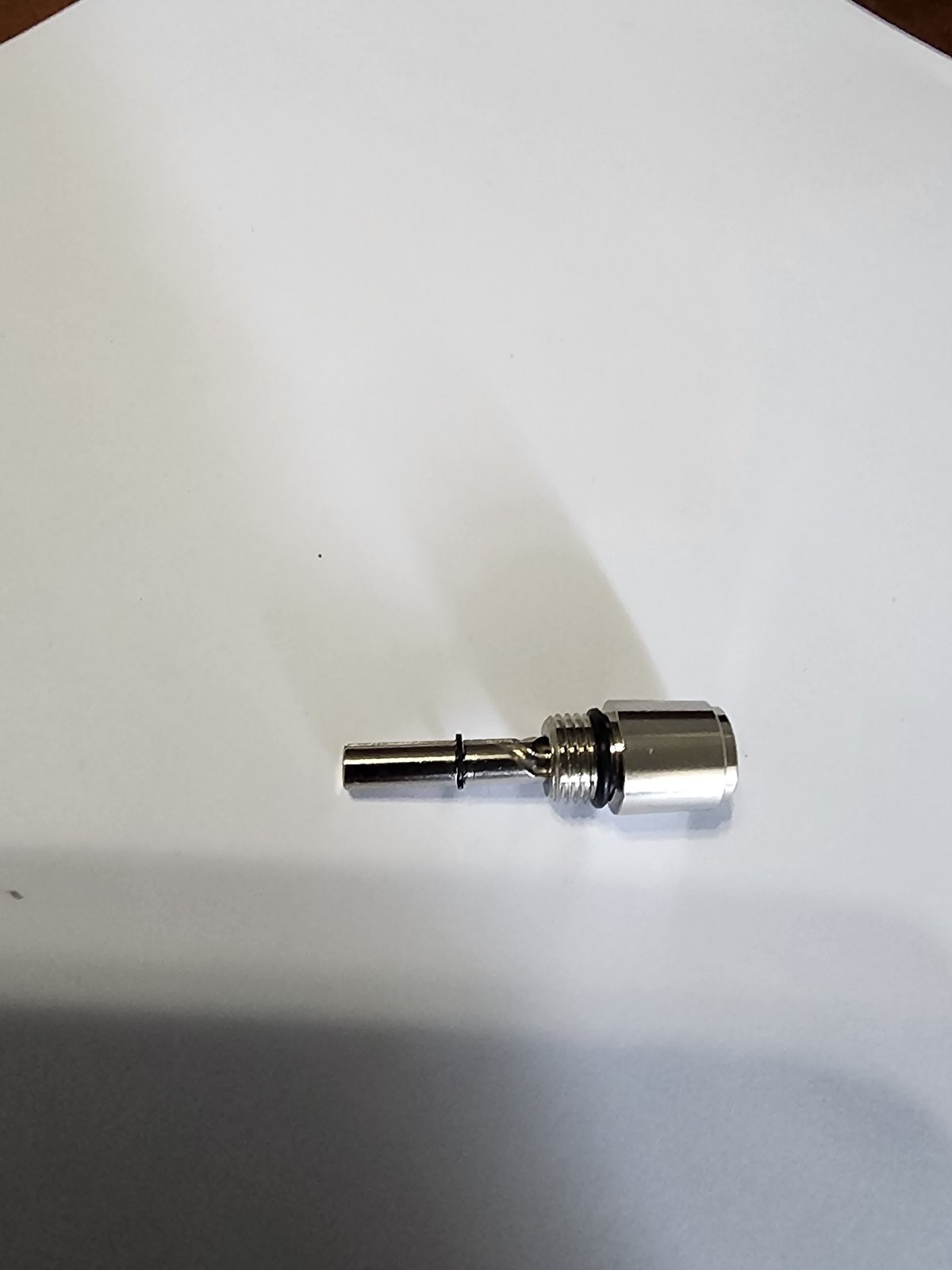

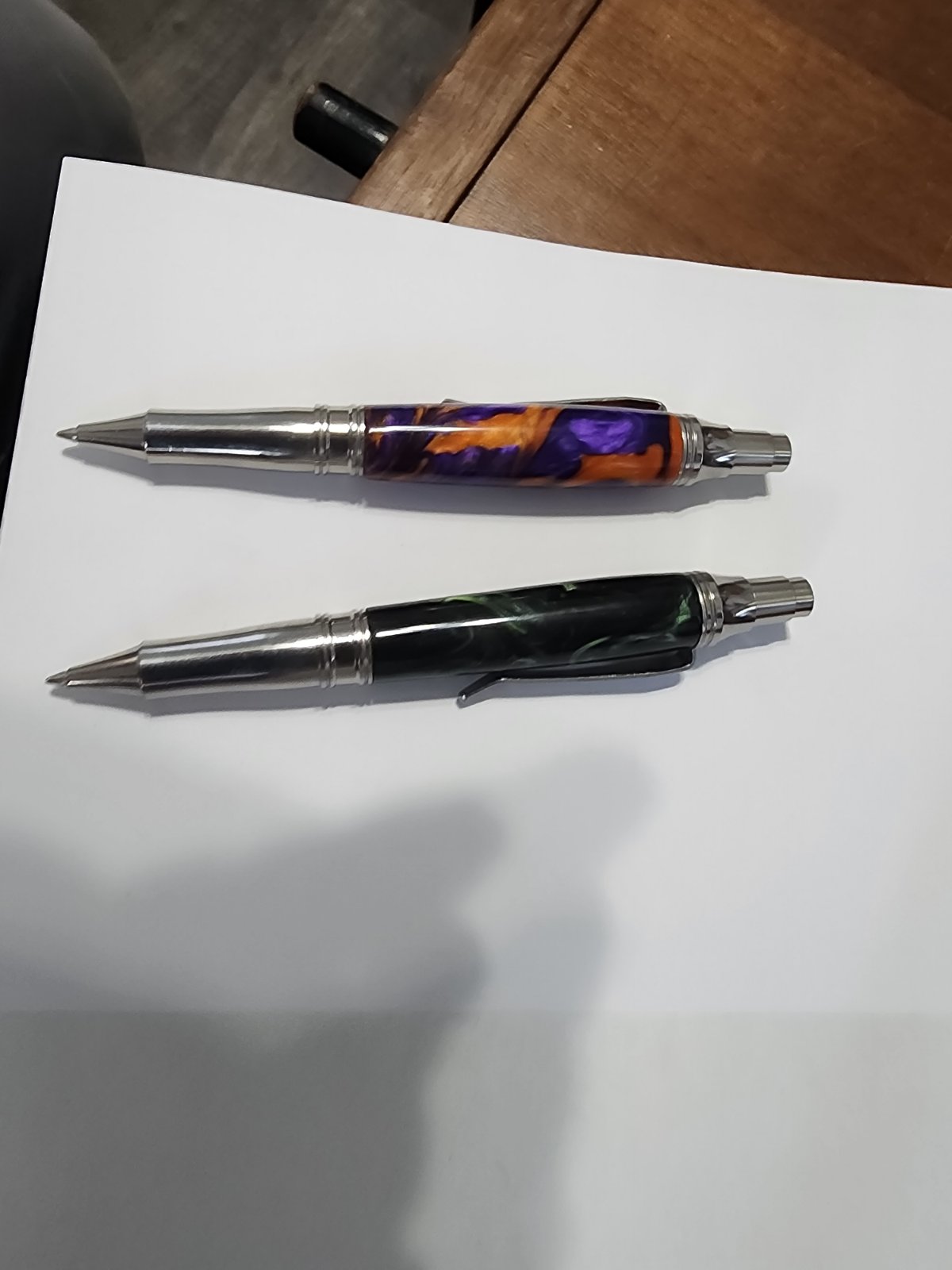

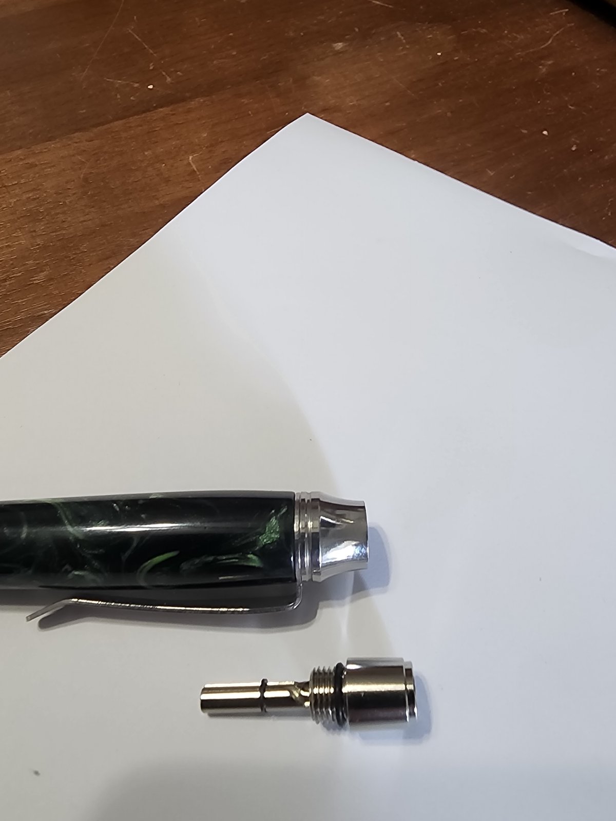

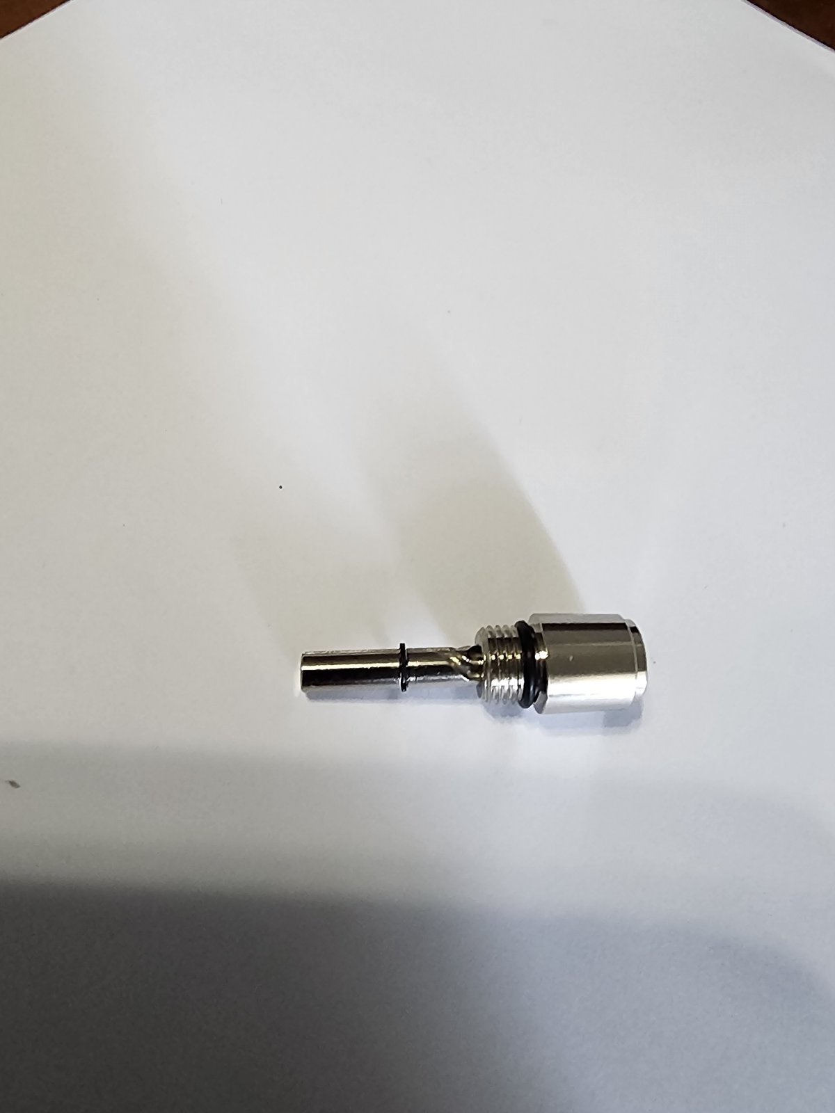

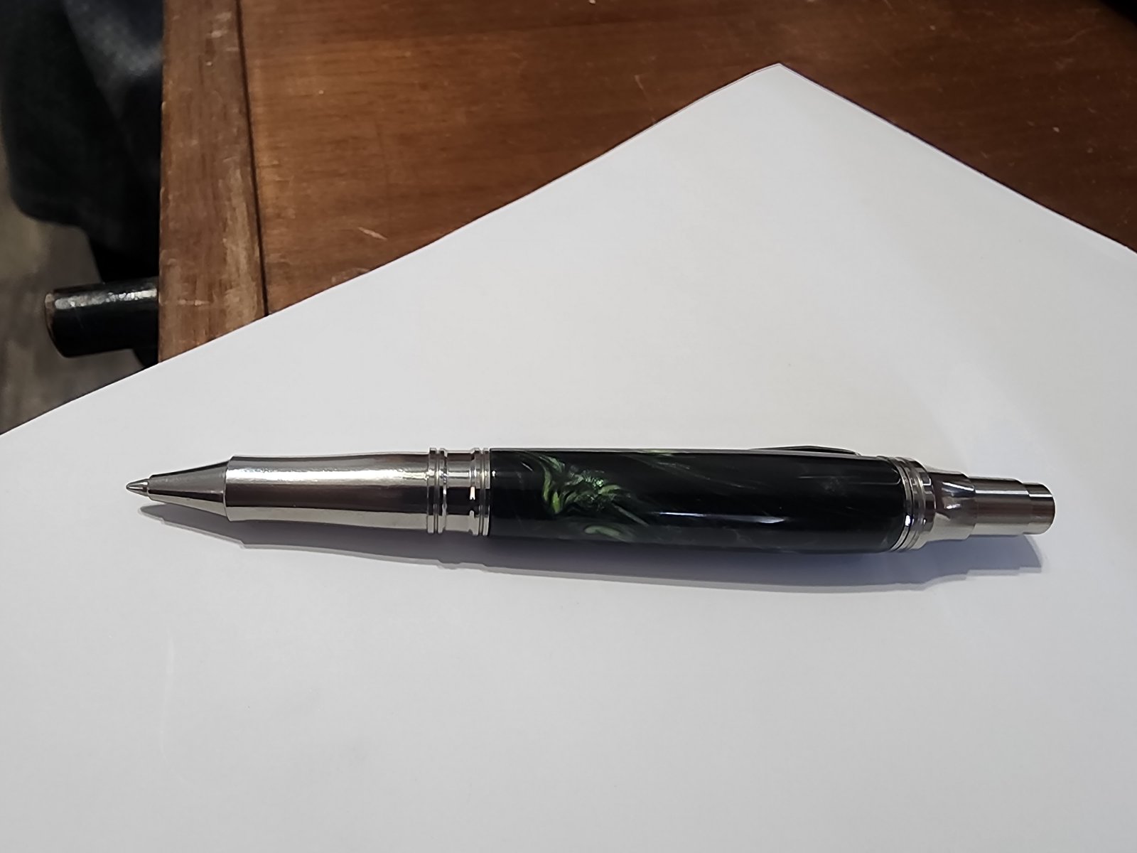

I got a batch of o-rings in today and the 1mm(cross section) x 5mm ID x 7mm OD work like a charm. 50 of them available on Amazon for about $9. I'm sure there are other vendors ,and now that I have a size that works I can shop for volume/price/etc.

Just getting back to this. Put the ends of the transmissions to my ROS a few days ago. One pen seems to work correctly now. The other is still erratic. Need to get a few minutes and sand it down a bit more.
