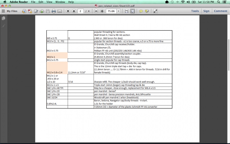

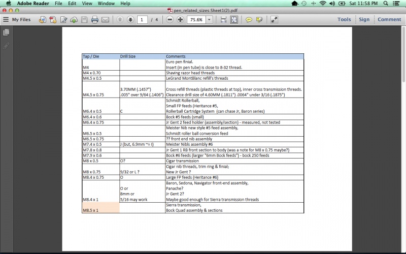

Unfortunately no one cared to take the time to measure every kit with thread gaugues so that we could buy every tap. I beieve it was George, just happened to measure these ones. I started with them, because i already had some ElGrande front sections, so i didnt have to invest in taps and dies for the feeds and buy feeds and nibs. All i had to do was take a pre made El Grande section, Triple start taps and dies and a 10mm tap and die and a pen was made. They are also readily available to purchase seperatley. Unless soneone contacts the manufacture or takes some thread gauges to them, its all hearsay. I think someone might have measured a Jr Gent one time, but i dont see the reason for matching all of them. If you have a certain pen size in mind, take a caliper too the threads and buy triple taps in that size, or whatever double, triple, or quad you desire.
Here, this is on IAP somewhere but i dont know where. Pulled them out of my hard drive. Some of them have ? marks, so i dont know how much i would trust it all. As far as i know this is the best list you are going to find.
Justin
