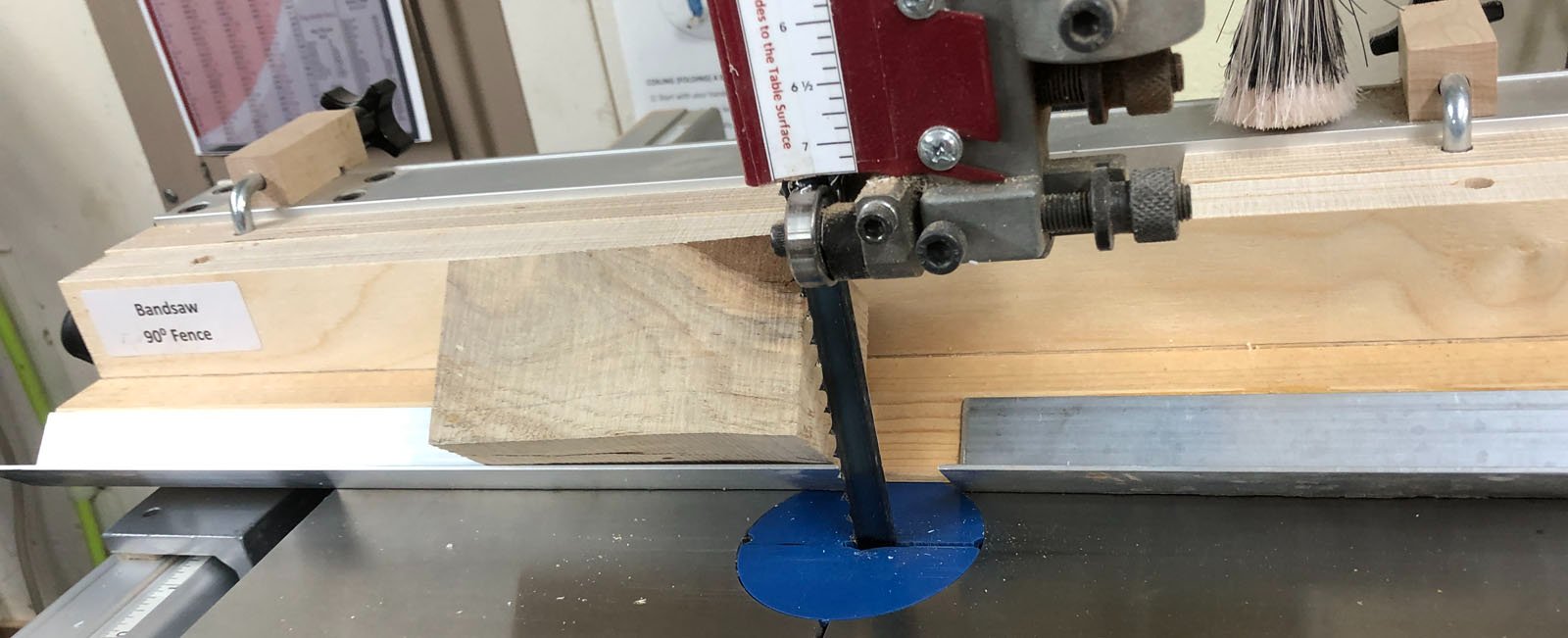

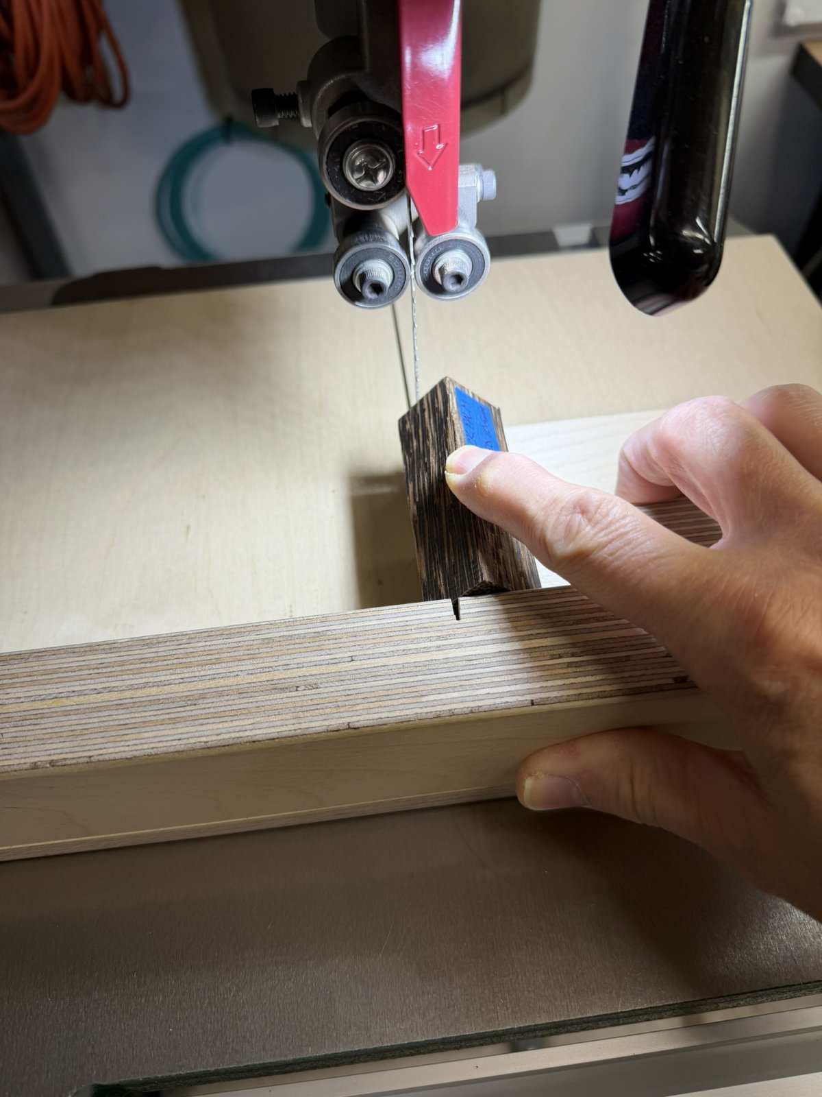

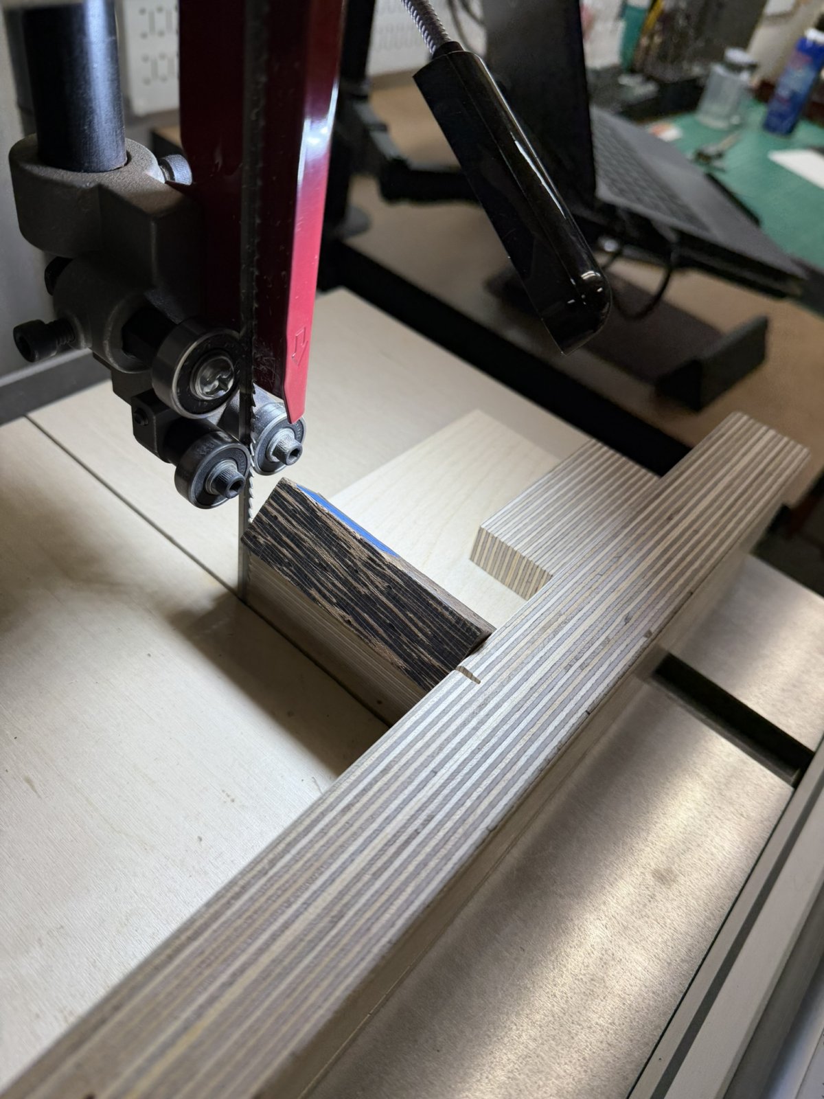

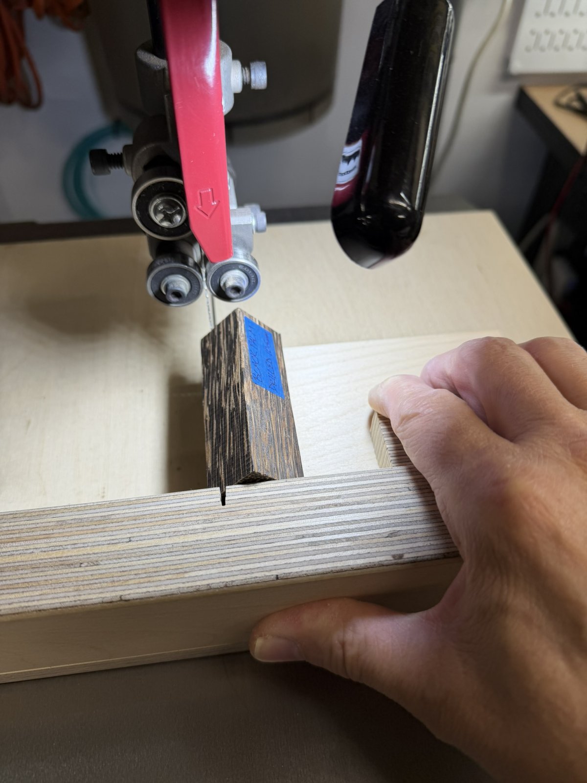

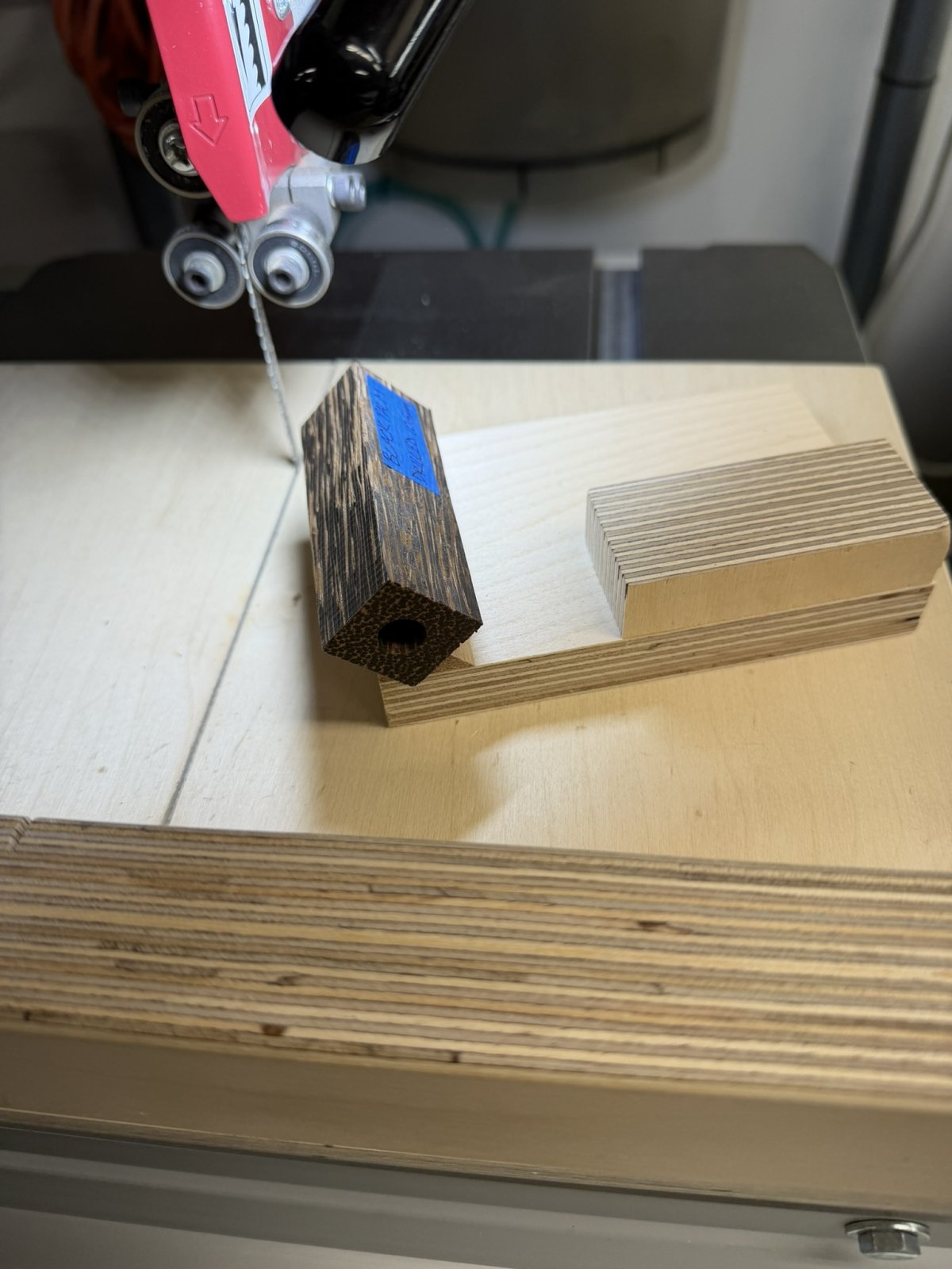

The jig I use is a simple one that I set on the crosscut sled I made for my bandsaw. I do hold the piece with my right index finger and that does get within 1/4" of the meat saw blade, so be careful. I suppose I could add a hold down. Here are a few photos.

Maybe you can, maybe not. I'm thinking not, but for me it isn't a race. It doesn't take long to trim off the corners and have an octagonal work piece.
To put it in context, I am doing this when I have sleeved a wood blank with ebonite or some other material and will be turning the piece on a machined threaded mandrel that is threaded into that machined ebonite. I want to reduce the stress on the ebonite liner, its threads, and the epoxy joint.

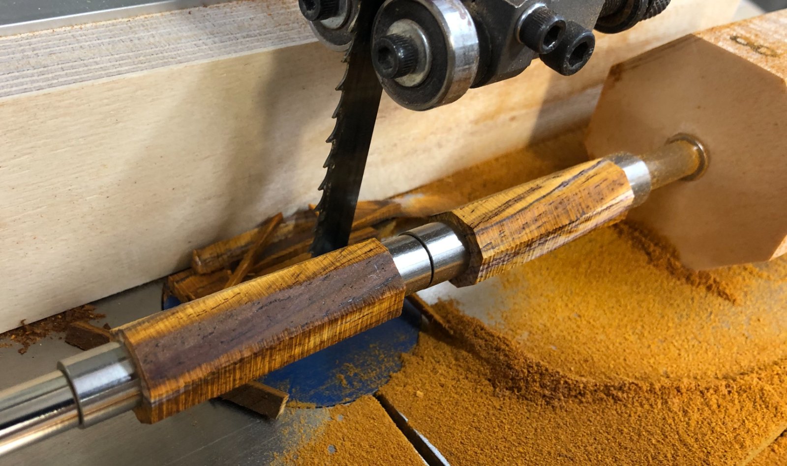

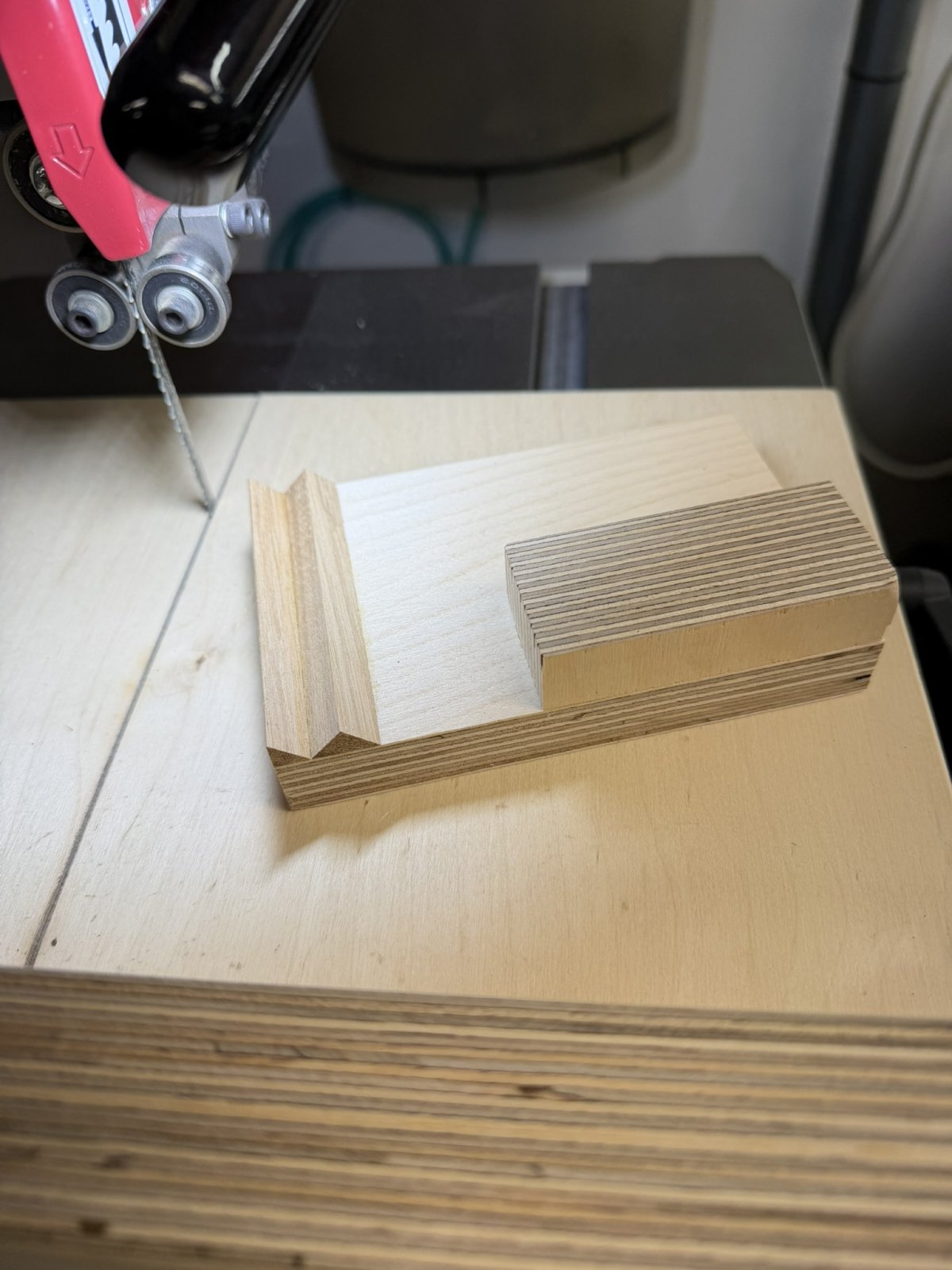

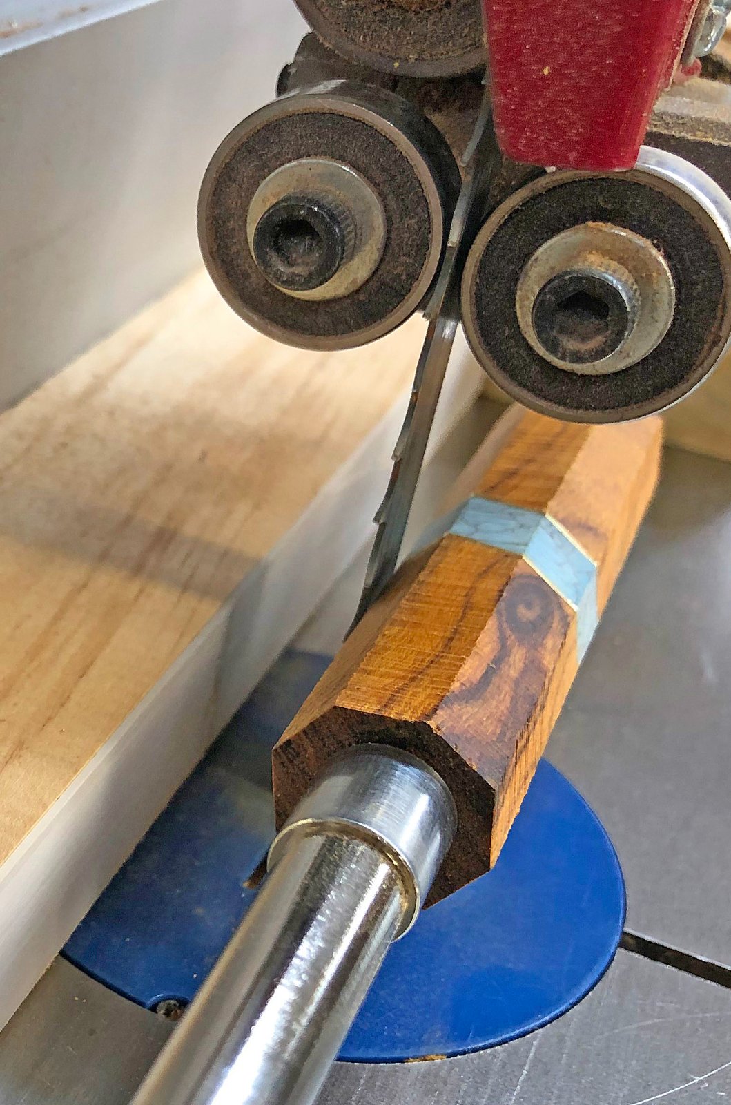

I use two different jigs depending on the size of the blank.

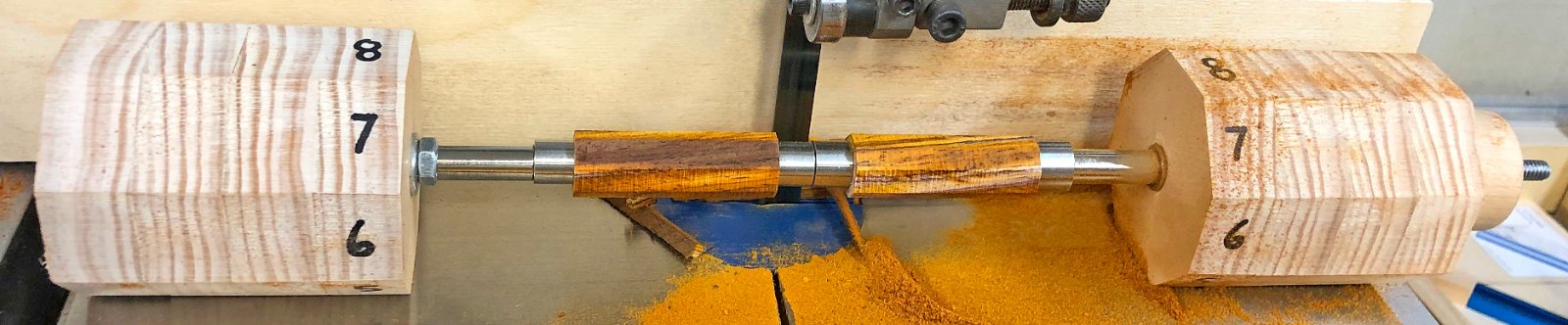

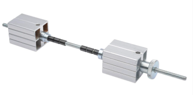

The one I made for pen blanks indexes off of the center of the blank so even if the blank was drilled crooked, the bandsaw cuts the blank so it is symmetrical around the tubes. It is is essentially some octagon shaped blocks with a hole through the middle to accept a 1/4" threaded rod. The blanks go on the rod like a mandrel with the bushings. The amount of material removed is controlled by sliding the octagon ends against the bandsaw fence and rotating it 45-degrees after each cut. It is based on the design of the one that PSI used to sell but with wood octagons rather than aluminum squares. (See the pictures below).

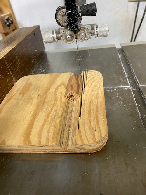

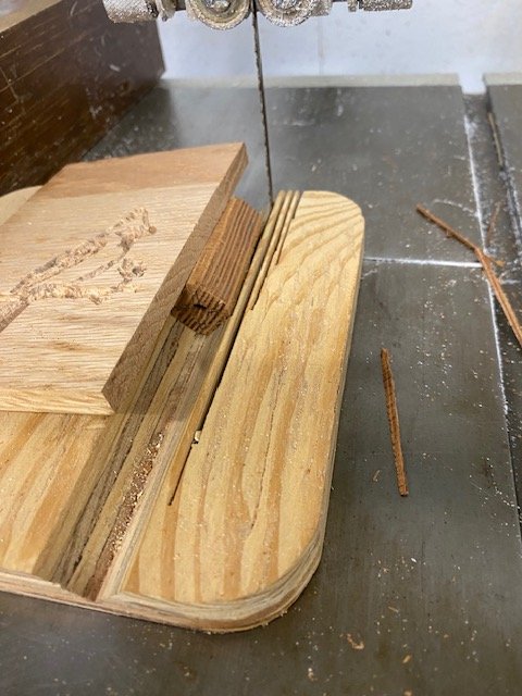

The other jig I use is simply a piece of 90-degree angle aluminum mounted to a board that I clamp to my bandsaw fence. The stock rides in the aluminum angle and is rotated 90-degrees after each cut. It works for larger stock (like for bottle stoppers) and pen blanks that are not drilled and tubed for bushings. The jig was roughly based on a Jig printed in Wood Magazine. (See the picture below).

PSI's Corner-B-Gone
My Variation of the Corner-B-Gone
My Jig for Larger and Non-Drilled blanks
