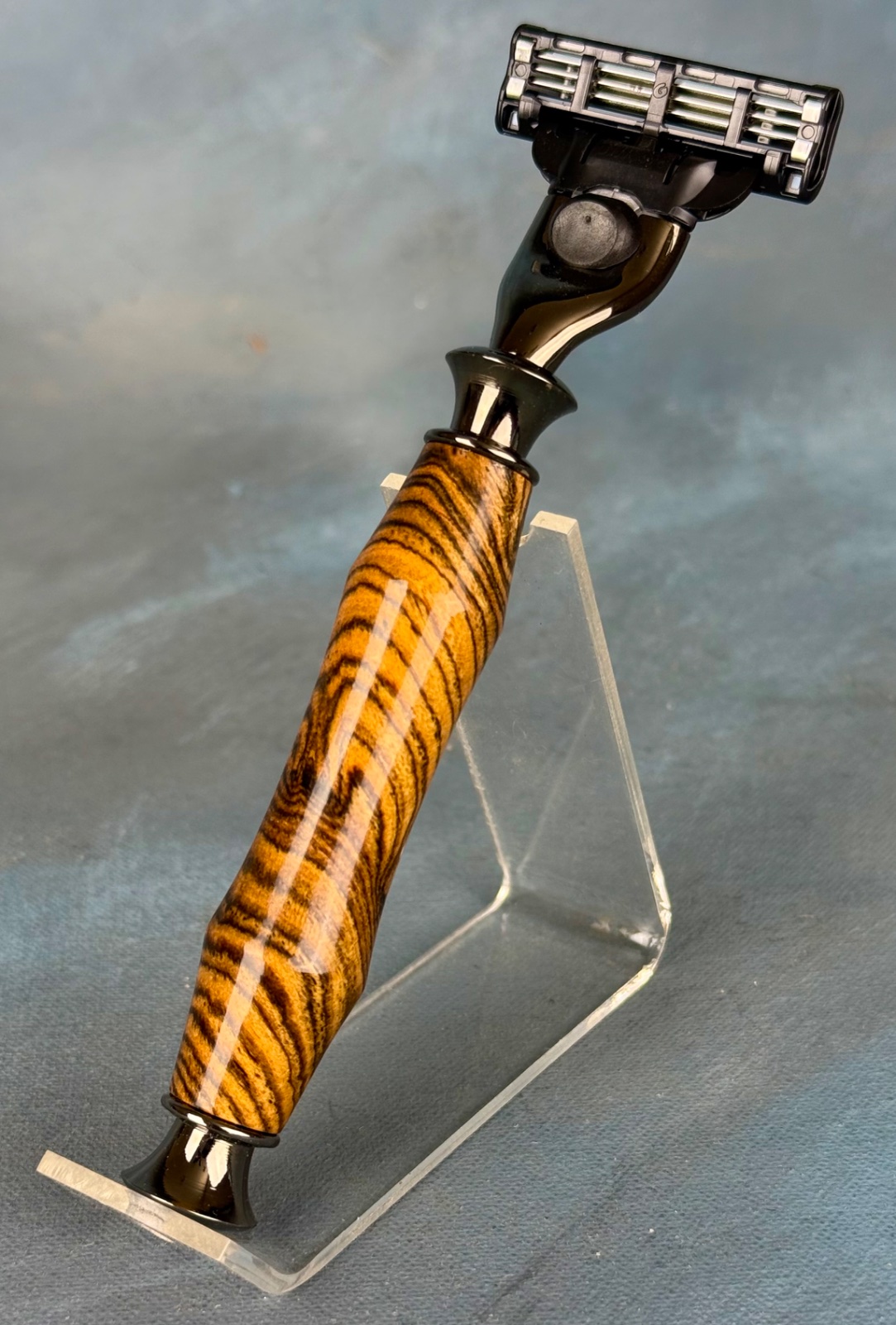

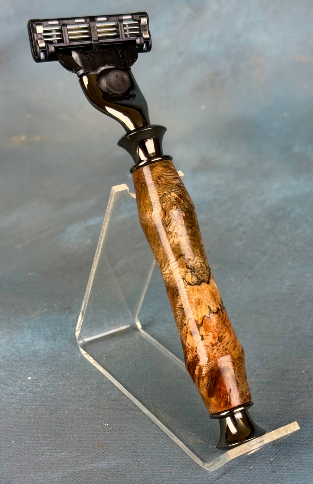

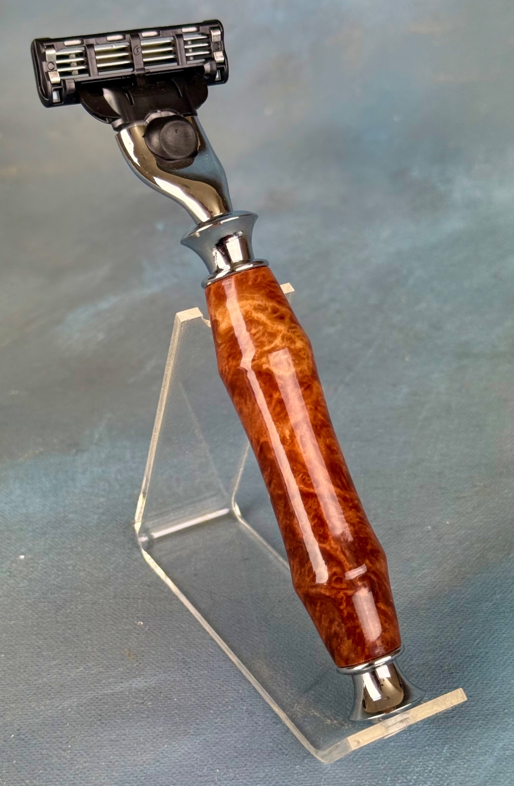

Sold one yesterday so I made three new ones.
Weru Burl
Diagonal Bocote
Mallee Burl
