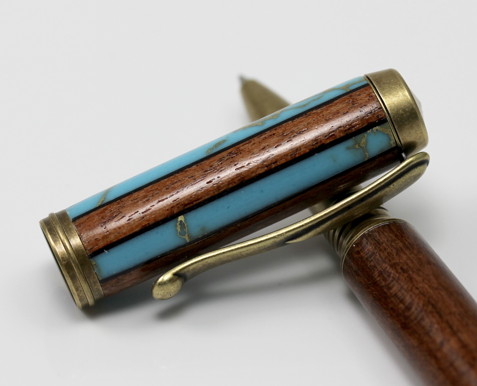

Been wanting to try this combination - the second attempt came out nice.
Torquoise with Gold Matrix (3-4 year old blank, so the older material) Truestone with black veneer and Mesquite.
Finally tweaked my lighting, has been a struggle lately.
C and C welcome.

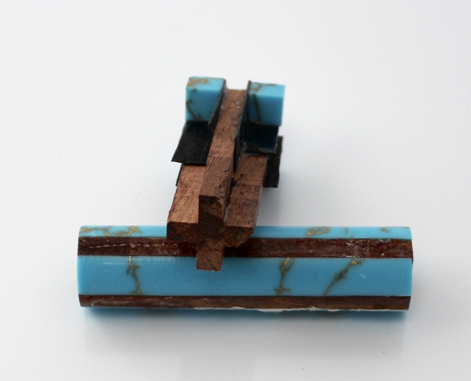

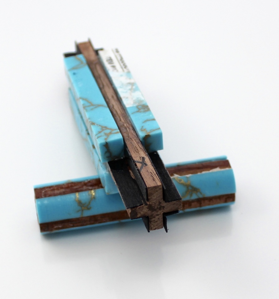

I'll edit in comments:

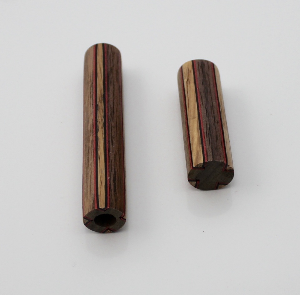

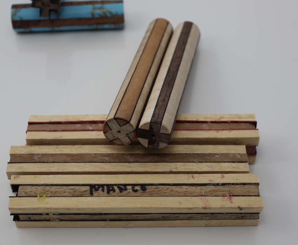

Photo 1: This is the way I had originally made the Chevron blanks - Make the inlays, sandwich between 1/2" x 1/2" square dowels.

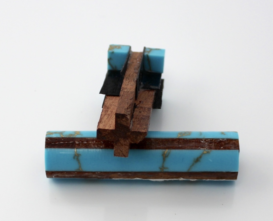

Photo 2: This is how I made the pen displayed above. I used a router table to route off the corners leaving an X, or cross. The centers were about 1/4" wide.

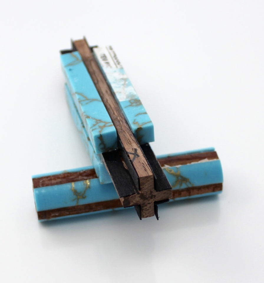

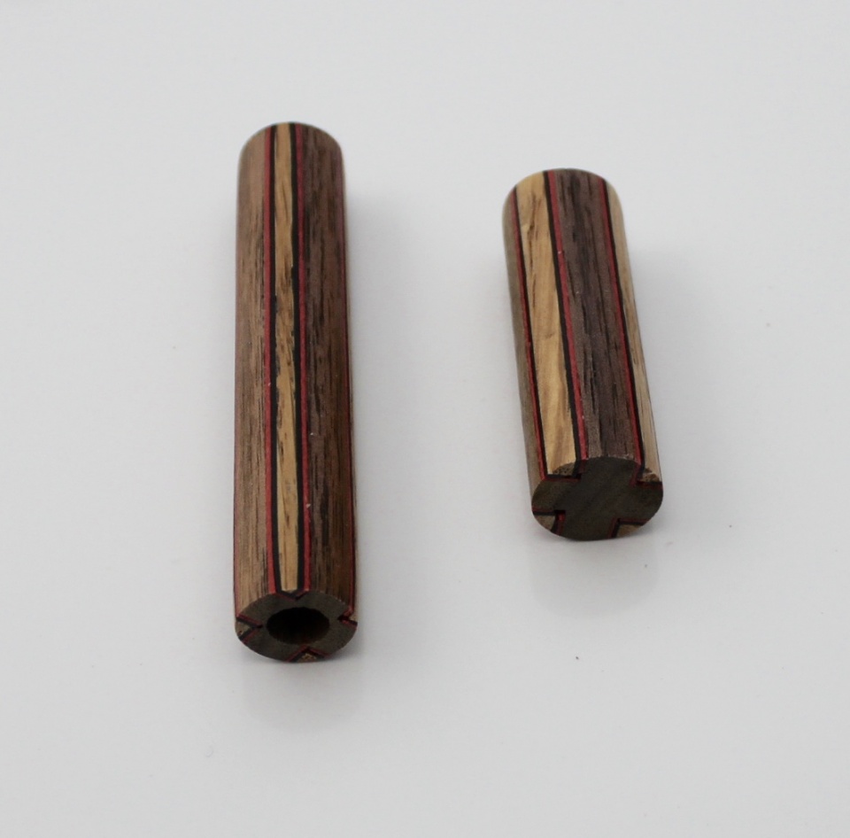

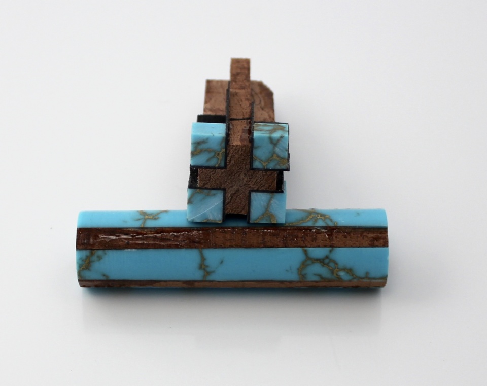

Photo 3: These are blanks that I am making to raise funds at the MPG (profits donated to the event) using this method.

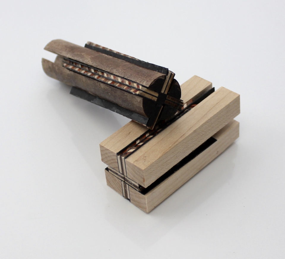

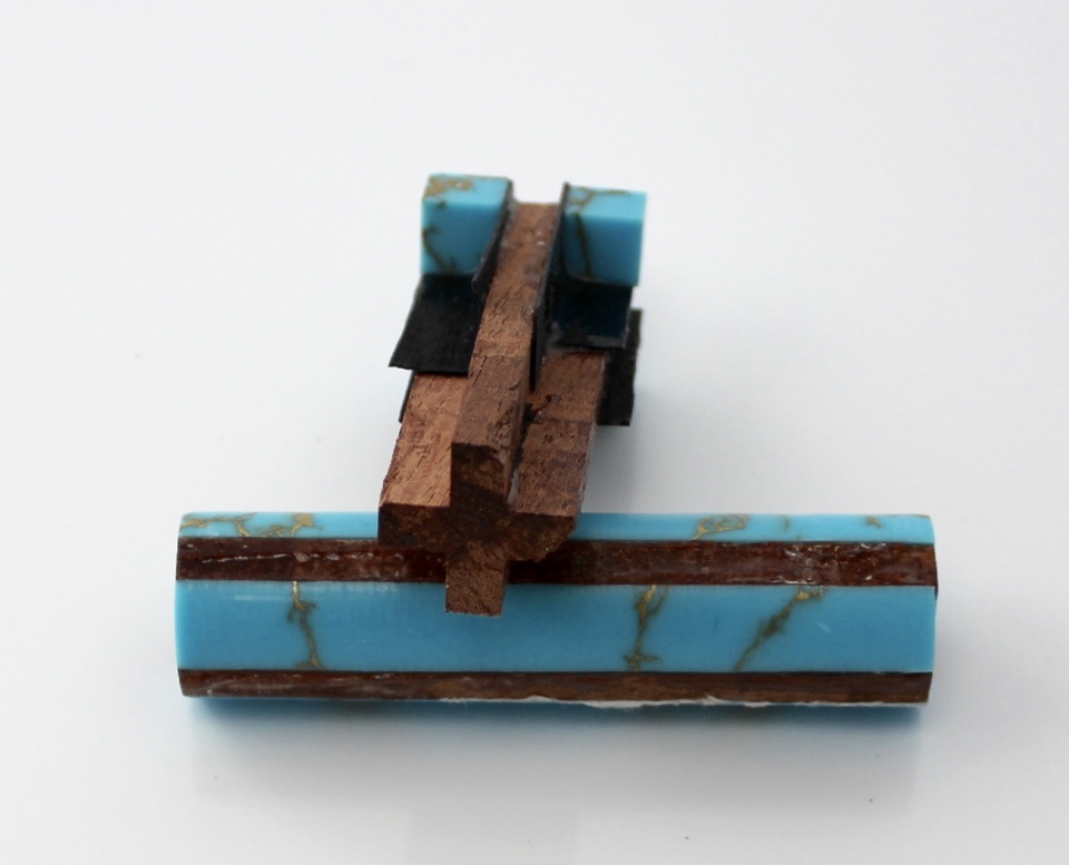

Photo 4: These are two tests blanks to see how they look... Not too bad.

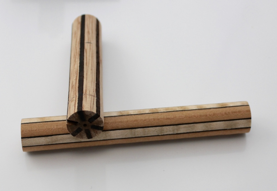

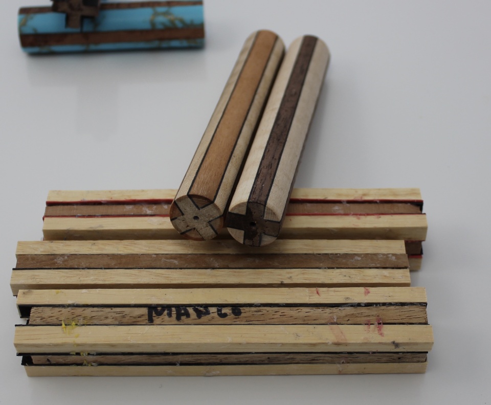

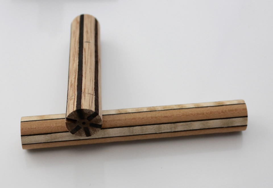

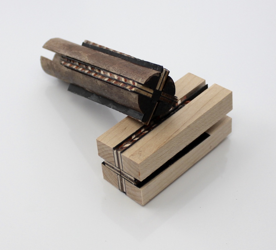

Photo 5: The above is for a FOUR inlay blank. I will still use "Frankie" when I do 5, 6, 7, 8+ inlays.

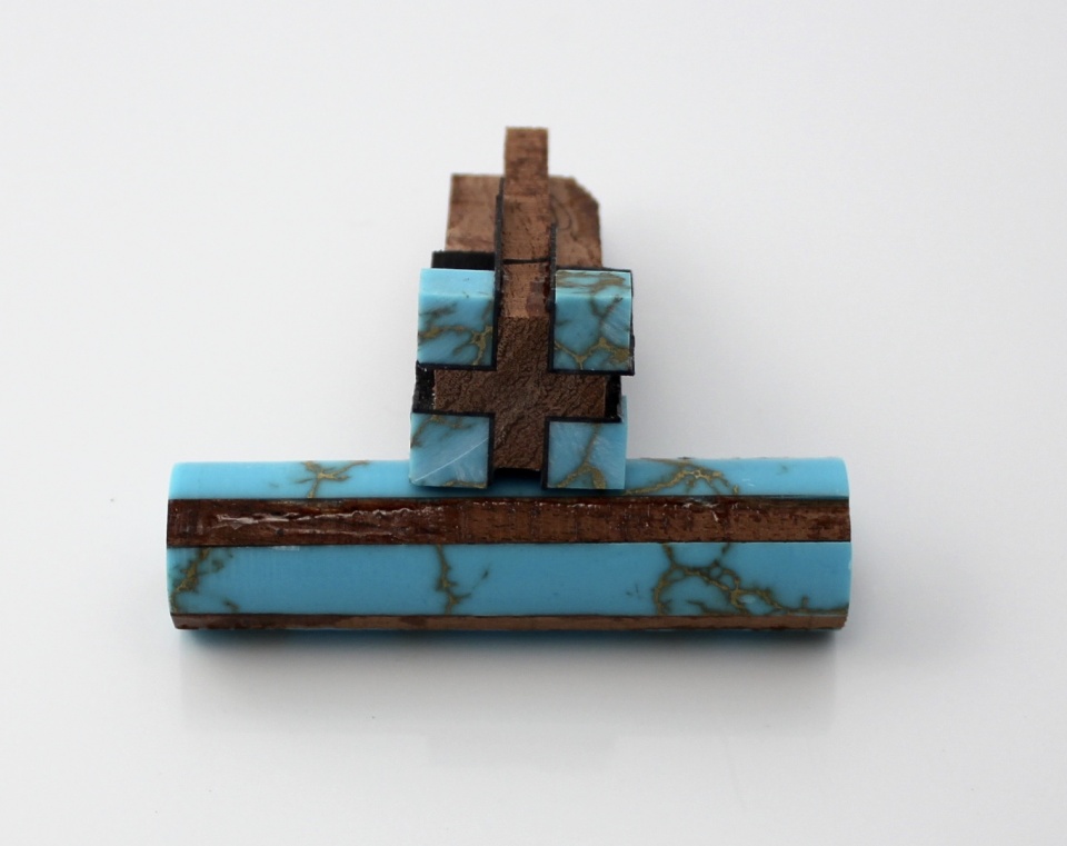

Photos 6 & 7: Pics of the ends of the blank for the pen in the OP.
Sorry, no pics of me cutting the 1/4" squares of truestone on the table saw, I'm not an octopus! I used a pushstick with a groove in the middle for the blade; it held down both sides of the blank.
