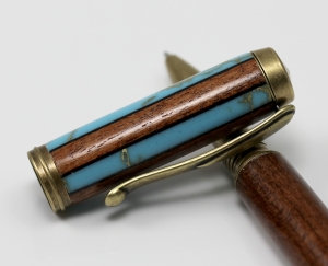

Nice combination of materials Mark.Did you cut your pie slices from a slab or are your balls as big as a computer screen,cutting the tru-stone from a pen blank?
Pen blank on a Byrnes Table Saw.
It's a new method of construction for me - I'll take some pics of the end pieces and be back in about 15 minutes. VERY Easy!
I'll edit in comments:
Photo 1: This is the way I had originally made the Chevron blanks - Make the inlays, sandwich between 1/2" x 1/2" square dowels.
Photo 2: This is how I made the pen displayed above. I used a router table to route off the corners leaving an X, or cross. The centers were about 1/4" wide.
Photo 3: These are blanks that I am making to raise funds at the MPG (profits donated to the event) using this method.
Photo 4: These are two tests blanks to see how they look... Not too bad.
Photo 5: The above is for a FOUR inlay blank. I will still use "Frankie" when I do 5, 6, 7, 8+ inlays.
Photos 6 & 7: Pics of the ends of the blank for the pen in the OP.
Sorry, no pics of me cutting the 1/4" squares of truestone on the table saw, I'm not an octopus! I used a pushstick with a groove in the middle for the blade; it held down both sides of the blank.

Oh, Mark !!!! . That is delightful !!!! . Some creative segmentation there !!!!
Thanks for the pics and explanation,That does look relativly safe process.I initially thought it was built using stave construction and thought to myself what kind of psyco cuts staves from pen blanks.Thanks for the details.

Mark another fine example of craftsmanship. I have to say I am truely impressed by your work. Being a lover of segmenting of any kind is always a pleasure to see work like this. The great thing about segmenting is the sky is the limit. Let your imagination run wild and all sorts of combinations can change a look so easily. Make sure you add all these to that segmented photo thread. These need to be in there so others can follow. You are putting your stamp on this stuff for sure. Please keep up the great work. I am loving it.
Just a side note I looked at that Byrnes saw many times years ago. yes the price is way up there for so little but it is the accuracy you are paying for. I just wish he would either hire someone to develop a tilting blade for that saw or do it himself and then I would consider it even more. That table attachment is such another great expense and it is a pain to use. All those other miniature saws out there have that blade tilt but do not compare to accuracy. Too much play in the parts.
For now I do all my cutting on a full size saw. It does require many of jigs to play safe. keep up the great work and thanks for showing. Love the eye candy.:smile:

Prove it!This I gotta see.:smile:
I will on the next project I make with them. I will be making some birdhouse ornaments using spectraply pen blanks and cut into staves.
I know this is not a pen but it is the beginnings of a bottle stopper I worked on a few years ago. Those are compound angled staves and the pieces are about half the size of a blank. Unfortunately I do not photograph all my work or else I would be spending more time doing that than projects. :biggrin:
It is really not that hard if you make a jig to hold your work. There was a person here that made many pen blanks from stave construction and he even should his cutting method and set up. I think if you do a search it will show up. he may have even put it in the library. Not sure.

Before I got my Byrnes, I would glue a pen blank onto a squared piece of plywood, then tilt my blade and cut, flip, cut! A lot of waste, but if the blank was what I wanted and I had at least 4, worked, but not with the precision I wanted.
Just a side note I looked at that Byrnes saw many times years ago. yes the price is way up there for so little but it is the accuracy you are paying for. I just wish he would either hire someone to develop a tilting blade for that saw or do it himself and then I would consider it even more. That table attachment is such another great expense and it is a pain to use. All those other miniature saws out there have that blade tilt but do not compare to accuracy. Too much play in the parts. :smile:
I was very fortunate last year when DCBluesman's estate was being sold, I was able to get the Byrnes table saw AND Thickness sander for $500. The Thickness Sander box had never been opened. I think he would be happy they are still making pens.

You misunderstand John,I've made staved pen blanks myself so I know the process.My psyco reference was about using pen blank sized pieces from which to cut the staves from.
Mark, nice pen. Very appealing combination. I am also very impressed that it didn't blow-up and fly apart on the lathe while getting cut down! You should run out right now and buy some lottery tickets....you got luck on your side brother!
Beautiful pen! I too though it was made from staves. Thanks for sharing your technique, it looks far safer than cutting tiny staves on a table saw. I've been wanting to make a shaving brush from staves but was too scared to be honest - I've grown fond of all my fingers. When I get around to it I'll be doing it your way.

What are you using for glue?

For this pen (Trustone, wood veneer, mesquite) I used system three 5 minute epoxy. I mixed up about double what I would for 2-3 pens. Liberally coated (wore disposable gloves) each piece, then let set overnight.
For all wood and wood veneers, I used Titebond translucent. For anything with metal accents, I use the epoxy.

How'd you unglue the pen blank from the carrierboard?Did you use a second carrierboard cut at a angle to reglue the blank to for the second cut?One more thing,did you seriously use 4 blanks of tru-stone?Wow that's gotta be expensive to make a mistake.Great job on that pen.
I am sure Mark will answer your questions Dale, but just want to give you a little tip.
As I mentioned I use double sided tape alot. I found the turners tape to be just right for projects. If i need super strength I use outdoor carpet tape from Home Depot. But the point of this is, I use to be able to pick up damaged wood paneling from Home Depot and use to buy many sheets of the stuff. Now they do not sell damaged stuff any more. Once in a while you will see a box of cutoffs from their hand saw stations. They also do not sell much wood paneling any more either. I am dating myself I am sure. But I also have picked up thin baltic birch plywood because I use alot of that for backerboards in my scrolling projects.
My point here is I use that wood as my carrier boards and just glue small pieces to it using doublesided tape. It is very convenient because you can cut to any size and keeps the hands clear of the blade at all times. When doing staves just flip the piece over and slide the carrier board over. If need be add more tape. The tape I use is 1" wide so no problem there.
Another way to make the pen Mark shows and also the ones with more sides to it can be done with a router and lathe and I had shown "my jig" for that in the segmenting forum also.
Many ways to do segmenting work but needs to be done safely because of the small pieces used. Not sure if any of this is any help to you if you want to try something like he did. :smile:

... One more thing,did you seriously use 4 blanks of tru-stone?Wow that's gotta be expensive to make a mistake.Great job on that pen.
Just a quick note for you here, Spanx ...
What he did was use a miniature table saw setup and a jig to cut a SINGLE blank into 4 equal long thin squared blanks that he glued AROUND the wooden parts with system 3's 5 minute epoxy.
He then used a router to make the blanks rounded on the outside, and drilled the center holes for the brass tube ... pictures are earlier in the thread showing parts of the process, and the cut-offs from the end of the original blank he used.

DALE: Oh my no! I used 2 1/2" of one blank - but cut it into 4, 1/4" strips. The kerf on the Byrnes table saw is very thin (I'd have to go measure it), but with a push stick pushing down from the top; and with a 1/8" notch in it for the blade, it actually was an easy and safe cut.
GREG: NO - I actually turned it round on my JET mini lathe using only my "Magical Skew with a round carbide tip" (Magical Skew is not a nickname, it is a tool that Magicbob sells and I'm am able to turn some pretty irregular segmented blanks without having a blowout). After it was slightly below 3/4" I placed the round blank in a collet to drill the hole, then glued, turned and finished as typical.
I routed the corners off of the original Mesquite blank with a square bit, so that the initial blank was now an X, or a cross.
