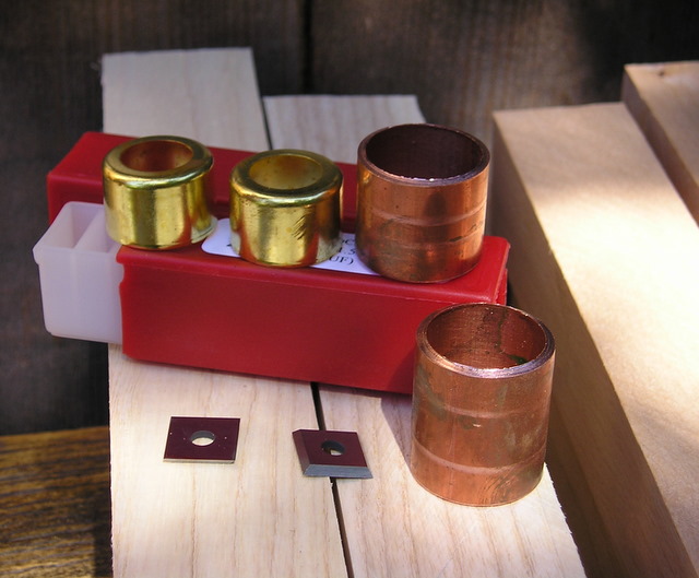

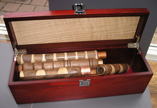

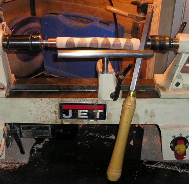

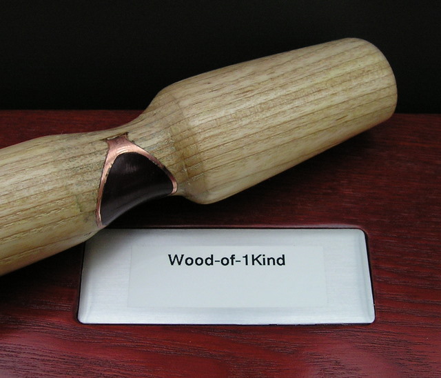

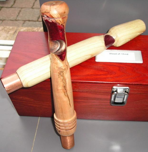

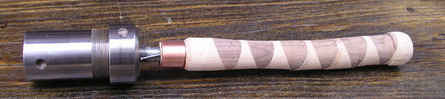

Here's a a quick way to make some tool handles with distinction. This small selection was made to demonstrate the cutting ability of the upcoming SKOGGER tool that will soon be offered exlusively to IAP members. Quick way for me to do these is using the Beall chuck and a home made 1/2" mandrel (bolt actually ). Let me know if you if you like 'em.

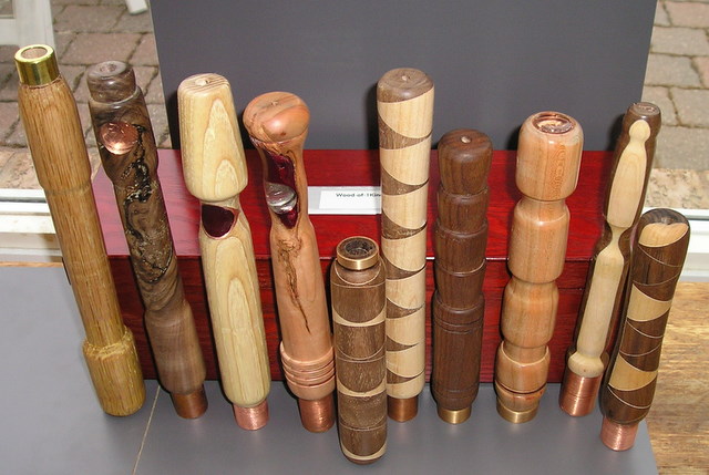

The in-progress handle looks like it is sagging in the center. Might just be an illusion.
Very fancy. However, some of the finished handles look like they might have sacrificed comfort for fancy. But as demos of what can be done, they are fine.
Jan 27, 2005
2,372
Drums, PA, USA.
I'm sorry Frank, I have to agree with you again.
Clear wood with no defects would be a smarter choice for handles.
The one with segments would only be nice for display, I would advise not to use them.
Hope your Skogger is better manufactured than your handles.

Very nice. I like the pin chuck idea vs. the alternate methods of turning handles posted on various sites. I made a screwdriver handle for a friend that way.

Not sure what you mean by seen it coming. This is not a cheap shot at all.
Just a cautionary word that gluing endgrain to endgrain or using blanks with bark inclusions on a handle is looking for trouble.
A tool is only as good or safe as it's handle.
I wish you luck in your endeavor.

Peter, the handles look beautiful, but I would have to agree with Ron. My first thought when I saw them was "there's a weak joint where you don't want one".
End-grain to end-grain glue ups are probably about the weakest joint there is.
The segmented handles you have made where you glued long grain to long grain would probably be fine. Depending on the glue used and clamping techniques, the wood in those handles would probably fail before the glue joint did.
Judging from one of your other posts in another thread where you said the Skogger would be smaller than the Easy Rougher, I'm guessing your tool is aimed mainly at turning pens. The chances of a major catch on a pen blank are pretty small, but why take a chance? I'm sure the Skogger could also be used on other spindle work and roughing out small bowls, where the chance of a major catch is even greater, at least in my experience :biggrin: If the handle failed at that point it could be disastrous.
I would not take Ron's comments as a low blow, rather as an opportunity to improve on a great product you have obviously put a great deal of time and effort into.
I hope you take these comments in the spirit in which they are offered.

Peter, awesome looking handles what has been said about your crafted handles doesn't mean you cannot make the idea work!!!! . As segmented and inclusioned handles, they do have some serious weak points. But there is a way to have the best of both worlds. Think sleeve. Presuming you are turning a round tang on the end of the square tool shaft to a nominal size, let's say 3/8", use a piece of 5/8" o.d. aluminum rod, drill to fit the tang then drill your segments to fit the o.d. of the rod and glue up. Once it is dried and ready to turn, chuck it up between centers and turn out your prefered handle profile. Be sure to turn a plug for the butt end. Viola! A great looking segmented handle that will not snap off on a solid catch. You could either epoxy the tang in the tube or you could drill through the handle under the collar and through one side of the tube, tap the tube and use set screws to hold the tang. Then slip the collar over the holes for a neater appearance. This would make your handle more versitile!

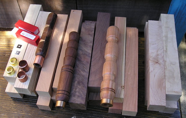

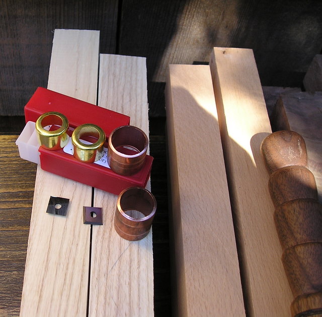

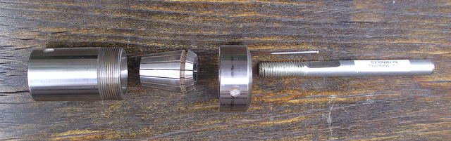

I'm about two weeks away from my SKOGGER introduction. I will be offering a "package" which will include a 10" turning block which the purchaser can turn his/her own handle.Solid hardwood choices will be: ash, beech, cherry, maple and walnut. A ferrule will also be included along with a solid carbide cutter. It will truly give the turner the opportunity of crafting their own "special" tool. Pricing will be determined as the introduction time approaches. My final price will include shipping to any US destination so that everyone knows up front what their true price will be.
