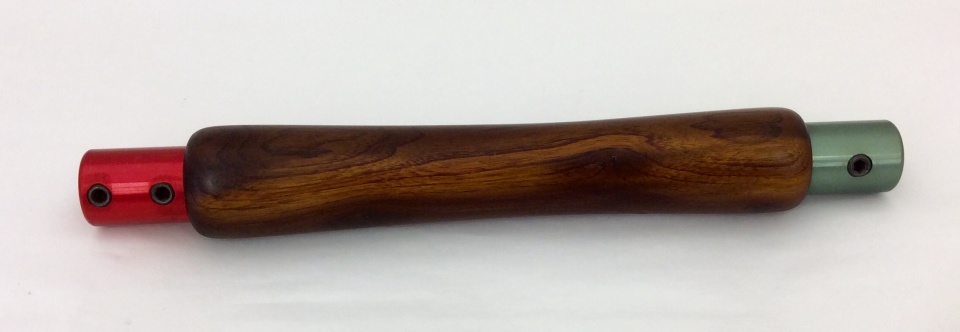

Here is a pic of an Osage orange handle I made earlier this summer. It has my 1/4" and 3/8" ends.
