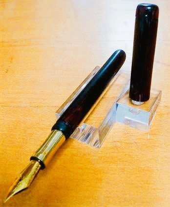

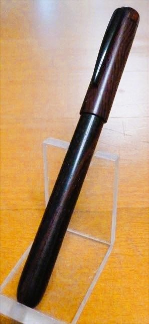

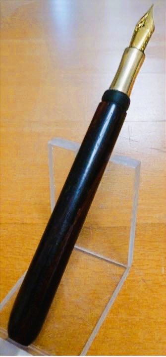

As it happens I am going through this right now. In fact just finished a custom pen with clip today. I have made a few pens with a clip, partly as an experiment. Indeed the clip that you choose, either made or purchased, pretty much drives the entire design whether you choose to bury it or not. It isn't just the OD and ID of the clip but also the gap to the clip itself which affect how it might look. The deciding factor for me wrt "clip or no clip" is the appearance of the pen, which is very subjective. I have decided that custom pens using wood as the outside finish look best with a clip versus any other finish. I just happen to think that it looks classy, and who doesn't like wood. I am pretty sure everyone here is a "woodworker" in some capacity.
Having struggled with getting the finial and cap the same OD, and attaching the clip, I now attach the finial by adding a thread the same as the cap, which requires threading the finial end of the cap. Then you can screw the finial onto the cap without the clip and turn and finish both together. As you go, you can check the clip against the turning for fit. Sometimes the ID of the clip won't fit over the thread on the finial, and requires boring out until it lust slips over with no slop. Then when you screw on the finial and clip it all lines up. I haven't tried "burying" the clip yet. I can see the attraction in terms of appearance, but adds another level of complexity. For reference, her is the pen that I finished today.
The wood is cocobolo, one of my favorites, the section is brass (Turners Warehouse) and the nib is a Jowo #6 with fine tip (my preference for my writing style). The black clip is from Beaufort Ink. The threads are M12 x 0.75 and M9 x 0.75. For the cap, my first challenge was that my largest drill bit is 13 mm for drilling the hole in the cap wood. Drilling a concentric hole through a 13 mm Delrin dowel with an 11.25 mm drill bit is not easy. I used 7/16". So I had to drill through a 16 mm dowel, thread it, and then turn it down to 12.5 mm for it to fit into the 13 mm hole in the wood.
