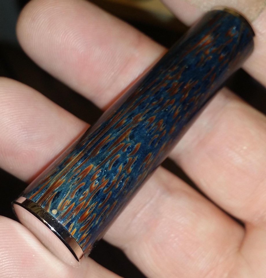

I did it! Super light passes. fresh edges on all my tools. The palm shaves off like dust.. anything that looks like a chip means it's time to back off. Treat it like a chip prone acrylic blank.
Just to make it worse this is for a Panache. A smooth concave shape with no scraping is a pain to get. Just need to do the finish and I'll post it up.
Does this all also apply to black palm? I received an 18" black palm turning square as a gift, and I have never turned it.
I've turned Black Palm without doing anything special to pre-treat it. I have some other type of Palm that was grown in Silicon Valley that's FAR softer (and boring in color/contrast compared to Black Palm)...that stuff is very dusty and takes a lighter touch. But Black Palm turned nicely (sharp tools, light cuts when you get close to final size, don't get crazy aggressive during rough in...normal stuff).
Here's the cap.. I can't finish the rest till I can figure out where the nib coupler trim ring ran off to.
Dyed with wiped on blue Aumlite then toned back with WTF. CA finish.
