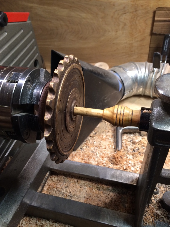

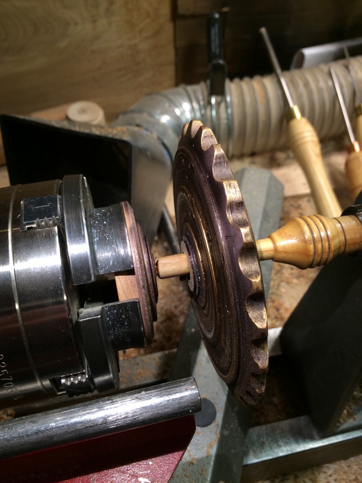

Normally when parting an item off the lathe, we use our free hand to catch it......when it is a toothed gear, I choose to go a safer route. With this piece, I used a wooden Morse taper mandrel (in the tailstock) from another project as the "Catcher" when the gear was parted loose.
I assumed the gear would climb out of my leather gloved catching hand and end up broken on the floor.
The "Catcher" worked as planned.

For a while now, I've been using a simpler version of it -- a length of dowel, usually hand held. If I need both hands free I hold the dowel in a chuck in the tailstock (or just let it sit in the tailstock through-hole.)
Thanks for the great tip but tell us more about the gear. How you did it and what are you going to do with it. You better be careful or I might show up on your doorstep one day begging for some lessons.
Hey Cody! This is a maple gear almost 5" diameter and is the feature of an art piece. I learned the technique and finishing from Nick Agar.
