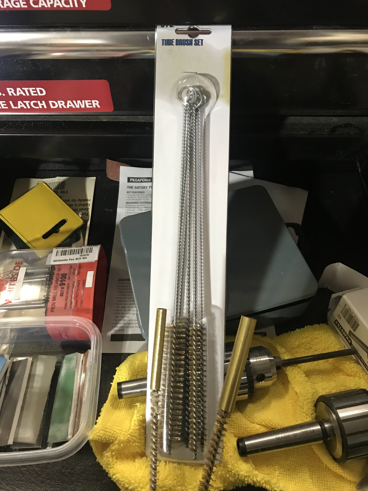

Gluing in tubes is always messy for me. Tried to come up all kinds of ideas and the one that works best for me is the the round brass and stainless brushes you can get at Harbor Frieght cheap.
They have 3 size brushes that works on the tubes i have been doing. Sierra and Slim's. I think they will work on most all kits.
Put the tube on the brush and apply glue
Then insert tube in blank and twist in and out until satisfied glue is spread
Hold in place until tube is stuck(i use accelerator to speed process) then twist the brush out.

Hmmmm .... sounds like a reasonable way, and less messy way than with fingers, to hold the tube.
However, my first impression was that you put the glue on the brush, but I now realize that is not quite what you meant ! 🤪 🥴👿;)

I may not have been clear enough on that😊
I put the tube on the brush and then the glue on the tube
it is the best way i have found for me

After several applications, the brush will be coated in spots with glue.
I have a dedicated pair of denim pants! I use a piece of paper to mix my epoxy on with a toothpick. Apply to the scruffed tube and the ends of the blank hole. Insert, get the tube positioned, wipe off any excess on my fingers on my right pants leg! The pants are 8 years old, somewhat crunchy in spots. ;)🤣
I do use the Harbor Freight metal brushes to clean the tubes after final ends are sanded flush! Very handy.

Doesn't the glue get on the brush? I can see a tube glued in to the blank and a brush glued into the tube. 🤔

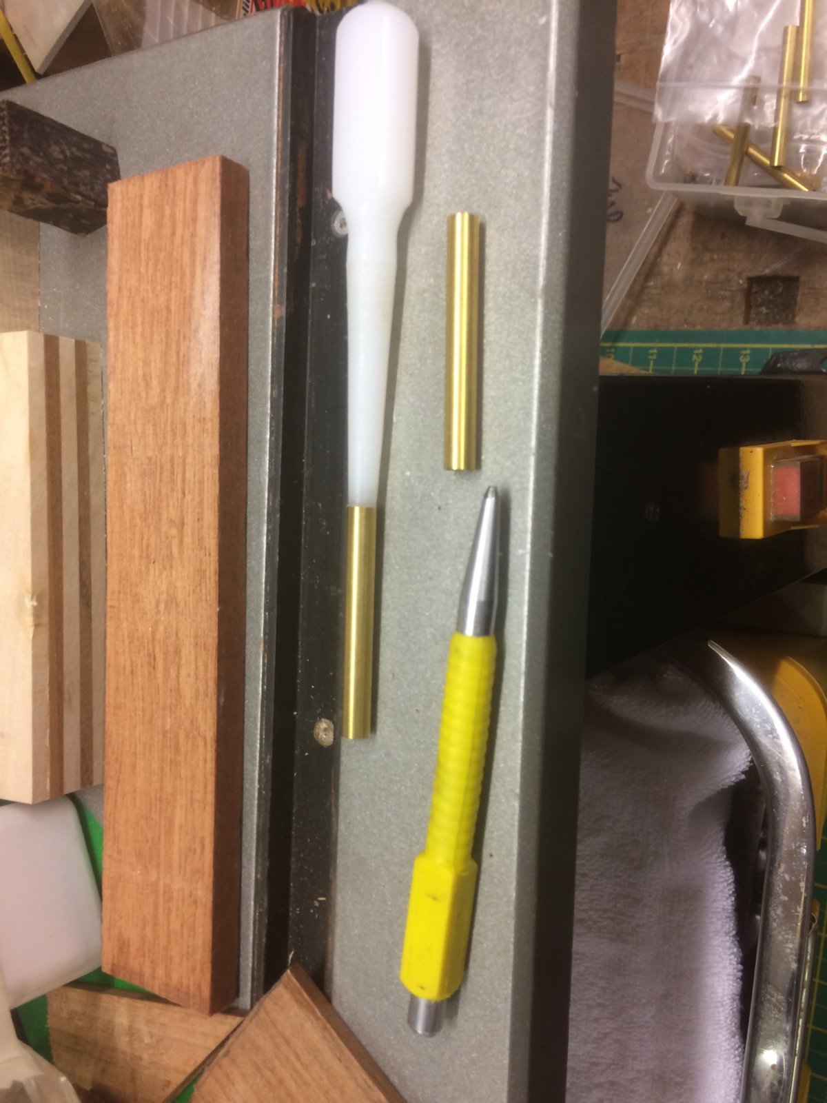

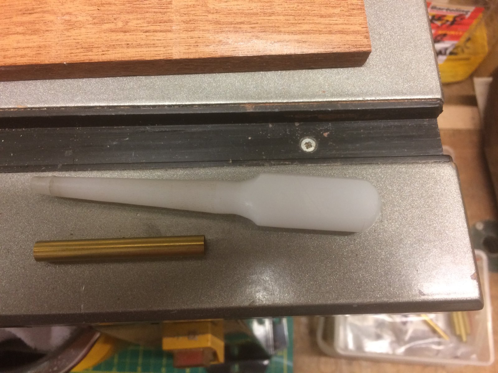

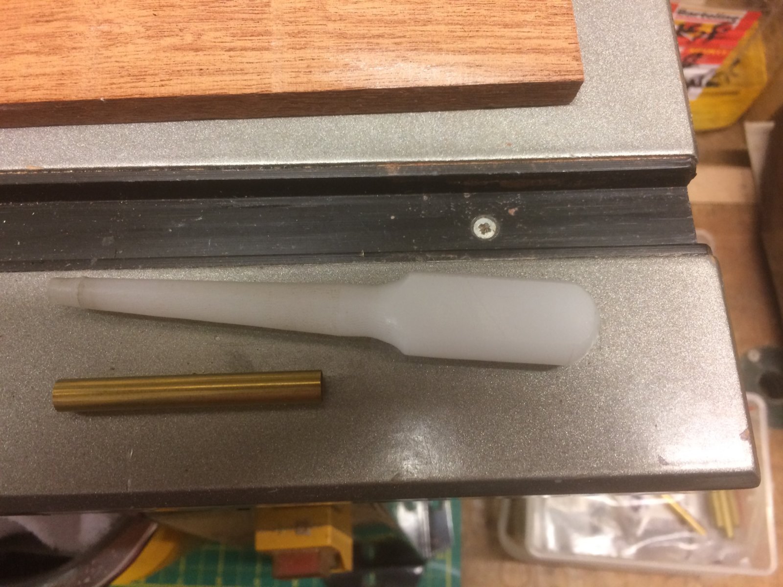

Made a tapered insertion tool from an HDPE flat offcut . Before that I used a panel pin punch ( for driving panel pins below wood surface) to hold the tubes .
Epoxy stirred up and then inserted into blank with coffee stick ( stirrer obtained free from mac donald's or K F C ) from both ends and you can wipe it round a bit. Seal tube end with something then pouch tool onto other end , add glue to tube push home rotating as you go.
HDPE is totally epoxy and CA proof !
Like the idea of brush to scour tube afterwards though, currently I use a round ended. dental probe to remove any visible to me , just takes a bit of time. Bun gin the tube end saves much work too .

here's a photo of the insert tool I made and also a pin punch , in case anyone wonders what that is ( not sure if it's a common name elsewhere but that's what we call them in uk )

I like using the those brushes after glue sets. And after the blanks are finished. For openers I plug the tubes with dental base plate wax. I also wear gloves ( not latex the other type). Good luck with that technique.... They way I work the brush would stayed glued in the tube or the tube would pull put with the brush and glue on it. What ever works... works...there are not rules.

Good to know about those brushes from harbor freight. I have been using brushes that plumbers use for cleaning fitting. I got some for .25 each at the local Habitat for Humanity store several years back but these look like a better idea.
