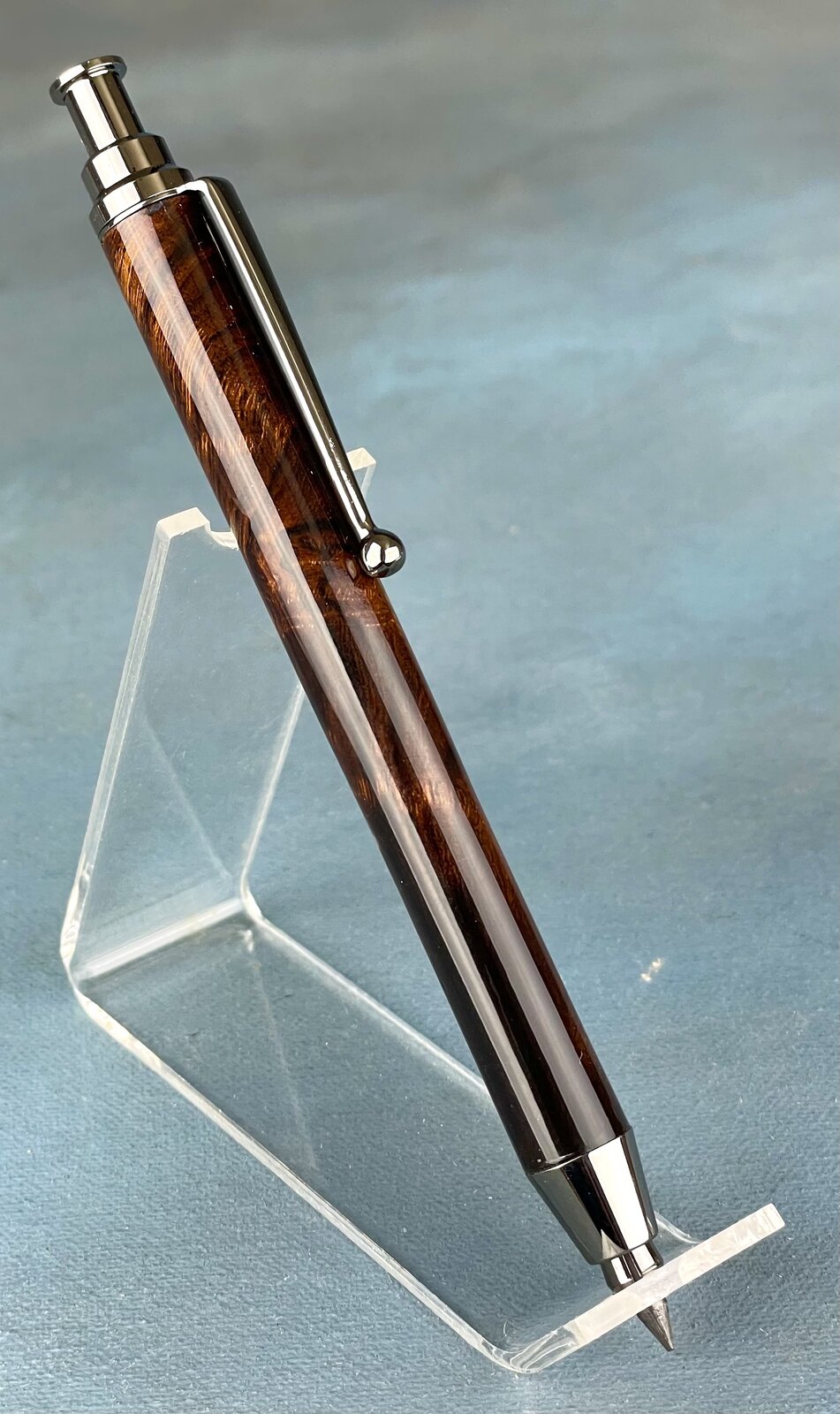

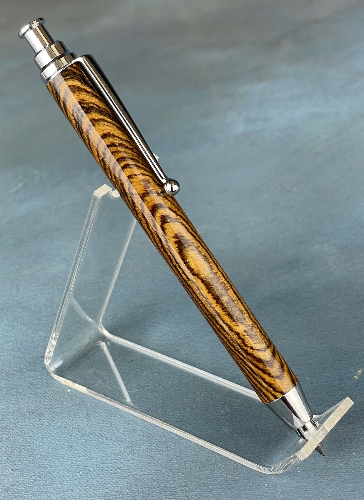

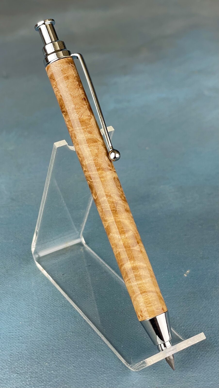

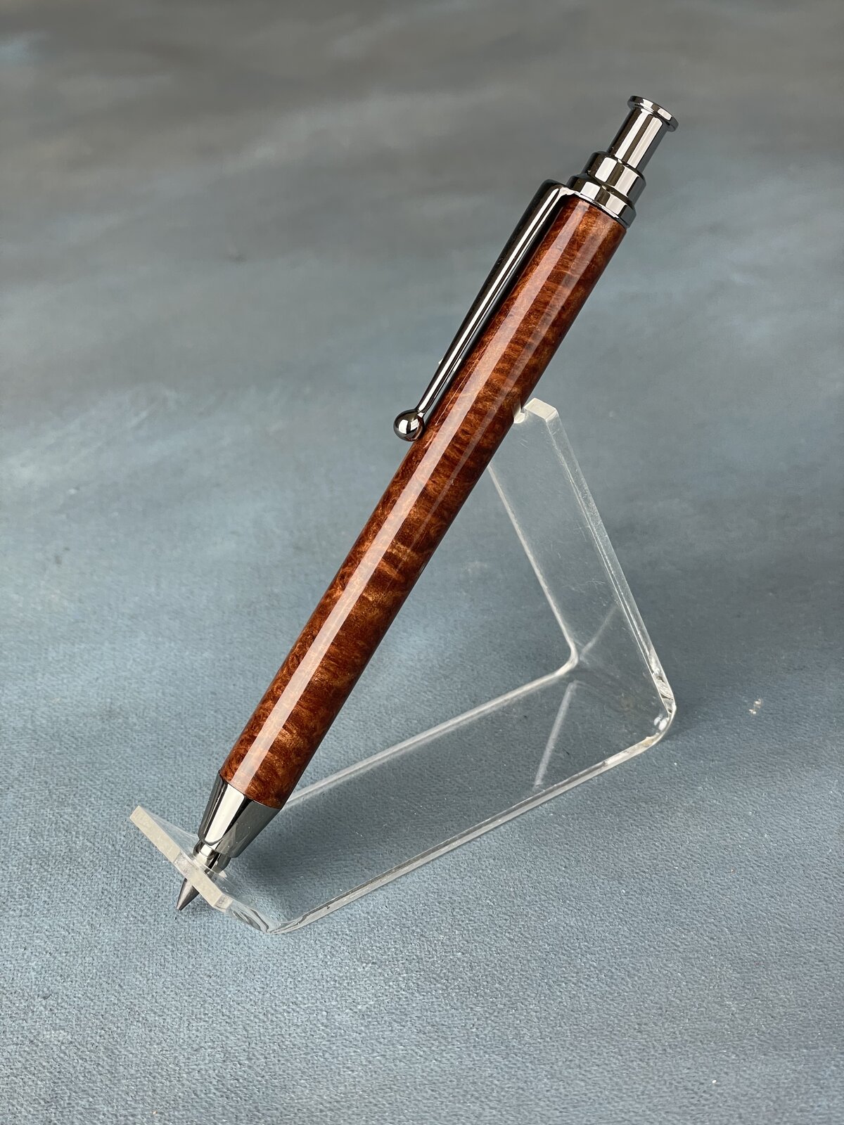

I like to vary the tonality in my sets of pens and in this case pencils. Diagonal bocote, Peruvian rosewood and maple burl helped spread the spectrum. The last redwood burl completes this initial offering of this kind of pencil. CA finish as with all of my pens.
