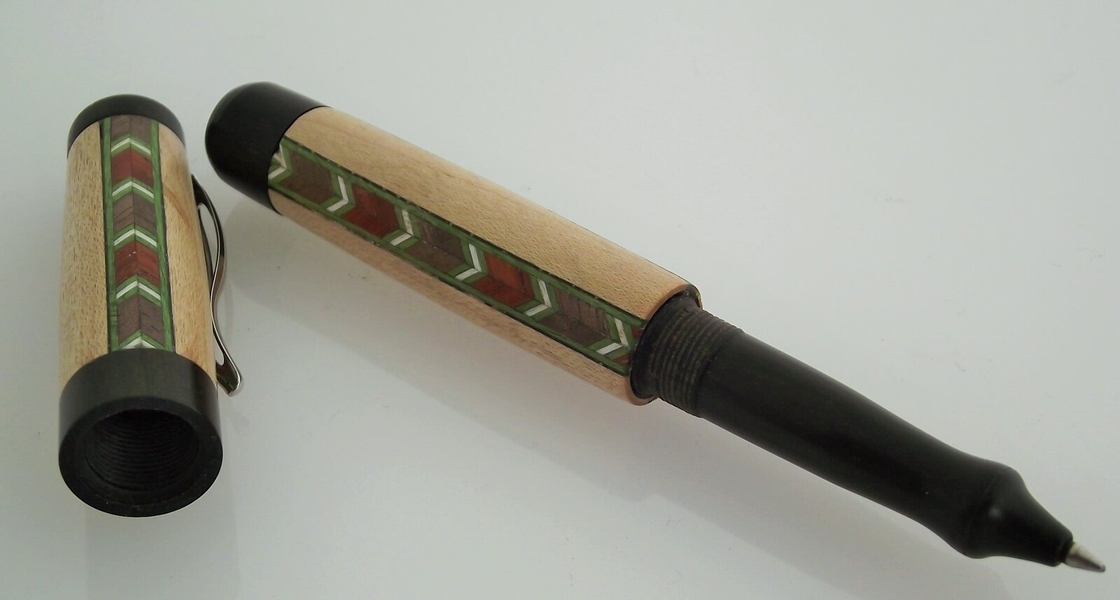

I agree with Mike Drake. If the wood has been stabilized with juice, then baked properly it has become at least partly acrylic..ish. I cut threads on an all wood pen using tap & dies. However....that pen went to a new home immediately after I made it. I don't know how the threads are holding up. The threaded parts were made from what I believe is African Blackwood. I would not hesitate to thread a stabilized blank.
