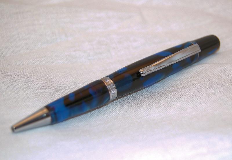

You can do this with a Sierra. There is not threading necessary. All you are doing is replacing the black plastic with your material.
I apologize for the terrible pic. I took it before getting my good camera.

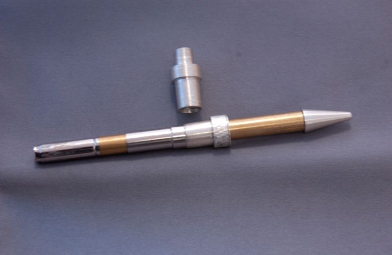

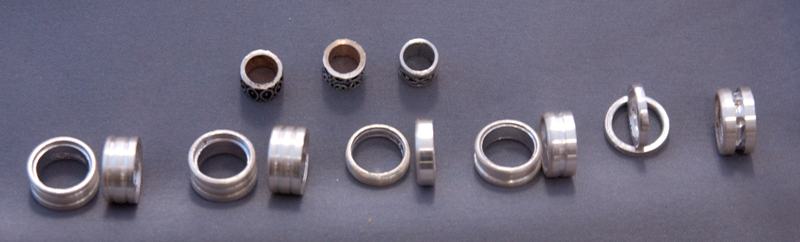

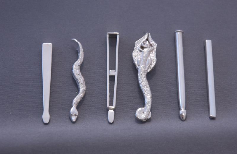

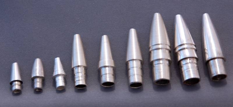

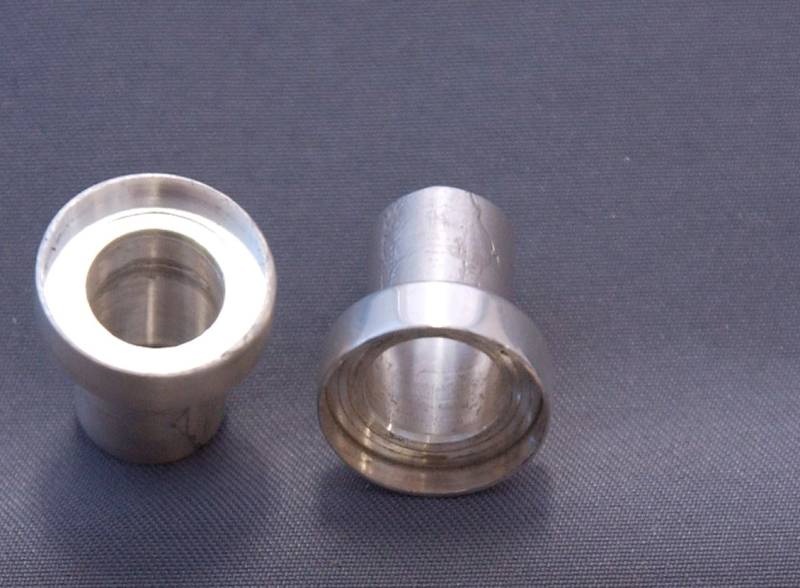

I am working on a design that would replace the lower piece of the Sierra with an 8mm tube using a sterling silver nib and centerband. the first design is ready but I need to make a pen up to make sure it works. this would allow the center band to be custom designed. I also have made a center band to replace the cigar style along with the caps clips nibs, making the clips and caps modular so the can be used on different size kits and tubes.
