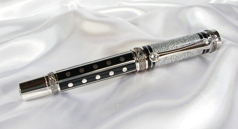

Now the thread wrappers can talk to this much better than I and use the correct terms and tell you differences. But I have played around with thread wrapping of sorts. Found out there is different types of threads that make a difference when top coating. I do not remember what was what though. But this one example I show here I used a metallic thread and top it with a color presevative called U-40 Color Lock #2. Believe me I have tried a bunch of different color preservatives on different threads and some worked fine and other did not work at all. I found this one to work best for anything I was coating. Got it from Mud Hole. I built the cap of this blank usesing end caps of acrylic and aluminum. I then wrapped the center portion with 3 layers of the metallic thread. I Put a very very small dot of thin CA at the end of the start thread. Did not want too much or it would mound and would show when you wrapped. I then wrapped as I said 3 times to make sure there were no gaps to see the tube through. Again a small drop of CA to finish it off and then cut with knife. I top coated with the presevative. I believe 2 or 3 coats. Know it was more than 1. I then cast the entire blank in Liquid Diamonds epoxy resin. I found resins of any kind would turn threads dark and they lose brightness. Then turned down to what was needed. Pen looks as good as it did the day I did it.
Now this is just my method of the way I did things because I do not do fancy designs. I have done other blanks using same method but using cloth threads and not the metallics. Many threads to choose from. But what I wanted to do was to use billiard cue wrapping threads and not fishing threads. I still want to go down that worm hole too. As I said others will be able to help more so than me. Good luck. Do not be afraid to cast in resin instead of CA. I would test any product before committing to finish products though.
