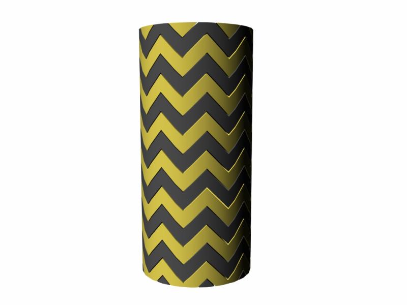

Well, it took about 2 hours, but using Lightwave I have figured out how to build the 360 HB. Looking at it, I imagine you are looking at hours and hours of tedious work to complete.

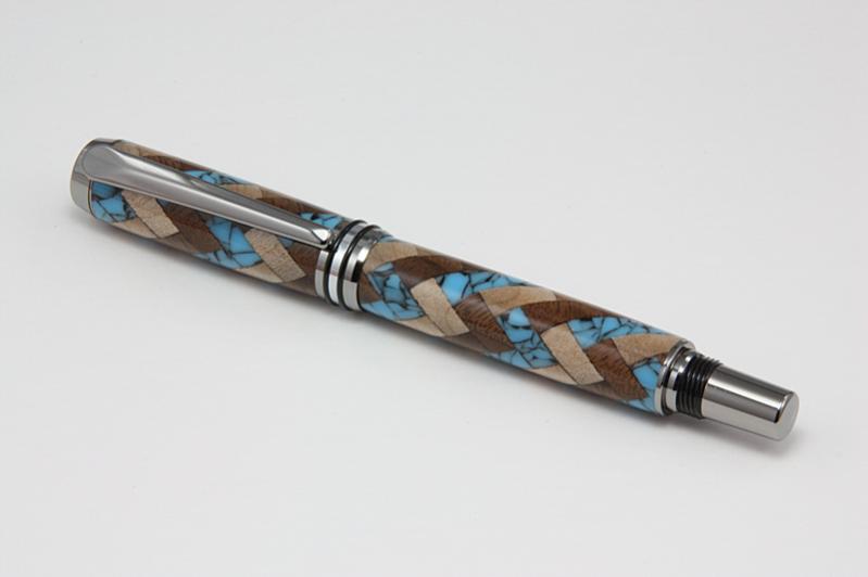

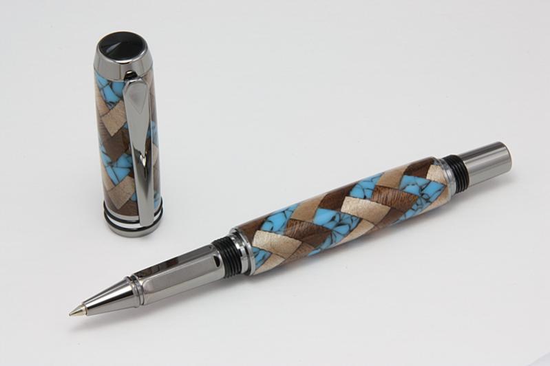

I do want to say glycerine (Jeremy) that is a mighty fine piece of work you did with that pen. Awe-inspiring work!
I just recently started to tinker with attempting to make similar style of pens myself. It is truly fascinating.
