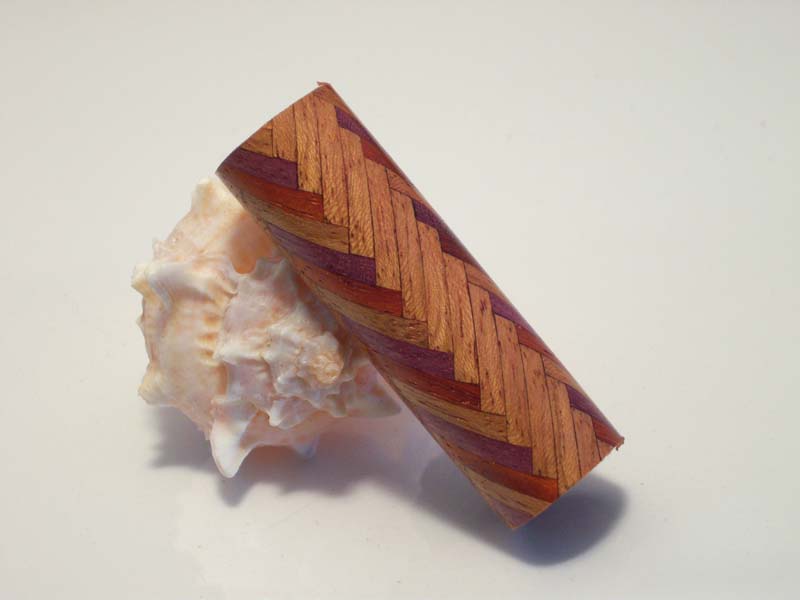

Okay, there seems to be a tremendous amount of buzz lately about the 360 HB. So here's my thought: instead of wasting all of your efforts trying to figure out how to bleed it out of the guy that already knows how to do it, let's use this thread as a think tank for those of you that don't. It seems to me that there are plenty of you out there that certainly have thoughts, ideas, concepts and even failed prototypes of the design. Why not use this thread to bring your thoughts together. Brainstorm and see what you cancome up with!
Those that do know how to do it, please don't use this thread as a place to give it away!!! Let's get some gears turning! You know as well as I do that these folks can do it and this might be just the avenue that takes them there!
If it seems that someone may be on the right track, some gentle prodding would be fine but give the inexperienced a chance to jump in with their thoughts before you do.
All of you that want to learn, have fun with this! I think that this could prove to be a great experience for many!!!

Hiya Wheaties! The following pic shows the 360 HB design. It is your basic HB design that actually wraps around the whole blank.

Here is what I have learned from postings by those who know.
BRobbins629:
Hint #1. There's more than one way.
Hint #2 See my avatar (it looks like a flat herringbone pattern)
Hint #3. For my method, it doesn't have to be a glued up blank. It can be built around a tube.
Hint #4 Quesion: are the cuts done on 30 degrees?
Answer: For my method, it doesn't have to be a glued up blank. It can be built around a tube.
After reading Bruce's hints I am guessing that he lays out a veneer in the herringbone pattern and then wraps and glues that around the pen. If this is true then a good deal of planning must be involved to get the pattern to line up once wrapped around the tube and each tube would require a different set of dimensions.
I found this quote from Bruce in another thread:
"Will also work with veneer and a little planning. This one is a 360 degree pattern."
The other method is to glue up a solid blank. I am still working on this one. Here are the hints I have found on this method
TribalRR:
Hint #1:The number rows of herringbones depends on the angle of the triangles. The pics I posted have 3; 6 pieces per layer.
Hint #2: I started with 3/16" thick triangles and went from there...
So it seems that your basic building block must be a triangle and the number of rows of herringbone pattern depends on the angle of the triangle. Just to mess around I made some equlateral triangles (all angles are 60) out of foam and it gave me 4 herringbones and it took 8 pieces to complete one layer. However the last piece did not line up correctly so I am missing something. I suspect that you must use isosceles triangles and that the angle must be exact to get the pieces to line up. That is as far as I got.
With regard to giving away the secret:
Regardless of how you make your 360 herringbone pattern I am guessing it is a ton of work and no matter what resonable price you get for the resulting pen (or blank) it will not be as profitable percentage wise as other blanks/kits that take less time to complete. Here is quote from Bruce that sums it up.
"Thanks to all for your comments. The woods are ebony and maple. I actually have made attempts at this with 3 different techniques. Will consider a tutorial when I have at least one of them perfected. I will say that my technique does not lend itself to making a profit. Took about 10 days to make the blank and that was after figuring out how to do it. With all the early failed experiments and mock-ups, I probably have more than 30 hours in this but the techniques could lend themselves to some interesting designs. More to come... "

I'm not sure how you would get the stepped joints though if you did it this way?
That's a great point Bob! you'll end up with a ton of zig zags around the pen instead of the length of the pen...so I invented the next evolution in pen blank technology! :biggrin: It's tough to sit here and surmise a solution without going out to the shop and doing it. So much to do, so little time.

...The woods are ebony and maple. ... "
I would think Ebony would be a tough wood to make a veneer out of that would wrap in that tight of a diameter without blowing out a glue joint or cracking...keep in mind you would still have to leave enough material on the tube to turn/sand away and finish.
I would also wonder how you would overcome the whole "outside of the veneer has a larger circumference than the inside of the veneer" issue. Consider a 3/8" diameter pen tube. The inside circumference of the veneer would be ~1.18" thus if you make the thickness of your veneer say 1/8" the outside circumference would be 1.57".
I'm not saying this isn't the way it is done, but it would sound very difficult to do.

ok. he made two regular herringbone blanks and they are laminated together, but the one on the back is inverted...meaning it's flipped end over end. This way all the straight strips glued on the side angle across to one another.
I totally agree with everything you are saying and I am just guessing at how he did it based on the comments I found. Personally I am more interested in figuring out the other method because it seems it would work for all tube sizes.
