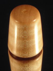

Curly Maple Thimble
After reading your post , I was thinking "I have a tool I never used" ( the tapered thimble cutter) and started a search for it . I still haven't found it but gave it a shot any way and here is the result .
I did this on the lathe with my Barracuda 2 chuck , a 1/2" drill bit and a small skew . I think it turned out nice .:)

That thimble looks nice! I guess I had better get off of my chair and make my own, since I brought this up in the first place!
I will go ahead and order a cutter from CSUSA this week, and give it a shot. Hopefully I will sell enough to pay it off quickly. For right now, I will try the 1/2" drill and skew method.

Hi Michael
You have it part right , the part you are missing is the Jam Chuck I made from a piece of beechwood .
First , I chucked up my blank (curly maple) and drilled a 1/2" hole about 3/4" deep , then I used a small skew (3/8") and tapered the inside walls of the blank to what I thought looked good . I then took a small round nose scraper and smoothed the inside to a comfortable shape (for me) . because I had a fairly large blank to start off with I was able to round off the blank to about 1" long and parted it off .
Second , I took a 2 1/2" piece of beechwood (I bought this wood specifically for making small jam chucks because it is a soft Hardwood , but any scrap of hardwood will work) and turned it to the same profile as the inside of the thimble but a hair larger , then I took my thimble and placed it on the the jam chuck and pressed it in place till it was seated solidly . I then put my tailstock against it to keep it in place for the final roughing to shape .
I then removed the tailstock and with a skew I finished turning the final shape and sanded it just like a pen . I finished it with Friction polish .
Jam chucks are a perfect way to make all kinds of closed end work holding jigs for anything from closed end pens to small bowls and boxes .
A word of warning , DO NOT rough turn with a jam chuck without using the tailstock and live center to hold your piece in place , while a tight fitting jam chuck will hold even a small bowl tightly it still needs support when rough turning do to vibration .
Sorry I have no pictures to show right now as my shop computers hard drive died last night and I lost all my pictures . As soon as I take some new ones I will post a few of my jam chucks .
Hope this helps and if you need more info please feel free to PM me anytime

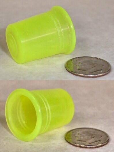

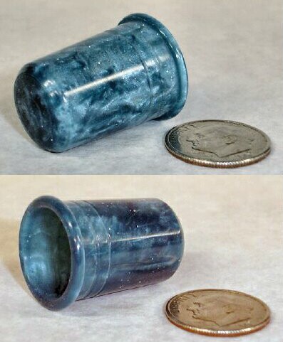

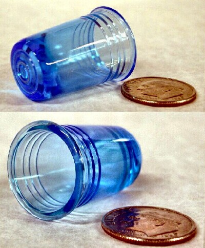

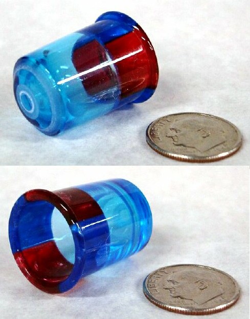

I bought that exact thimble hole-cutter from Craft Supplies when they first came out several years ago, and yes...it works great...on both wood and plastics.
