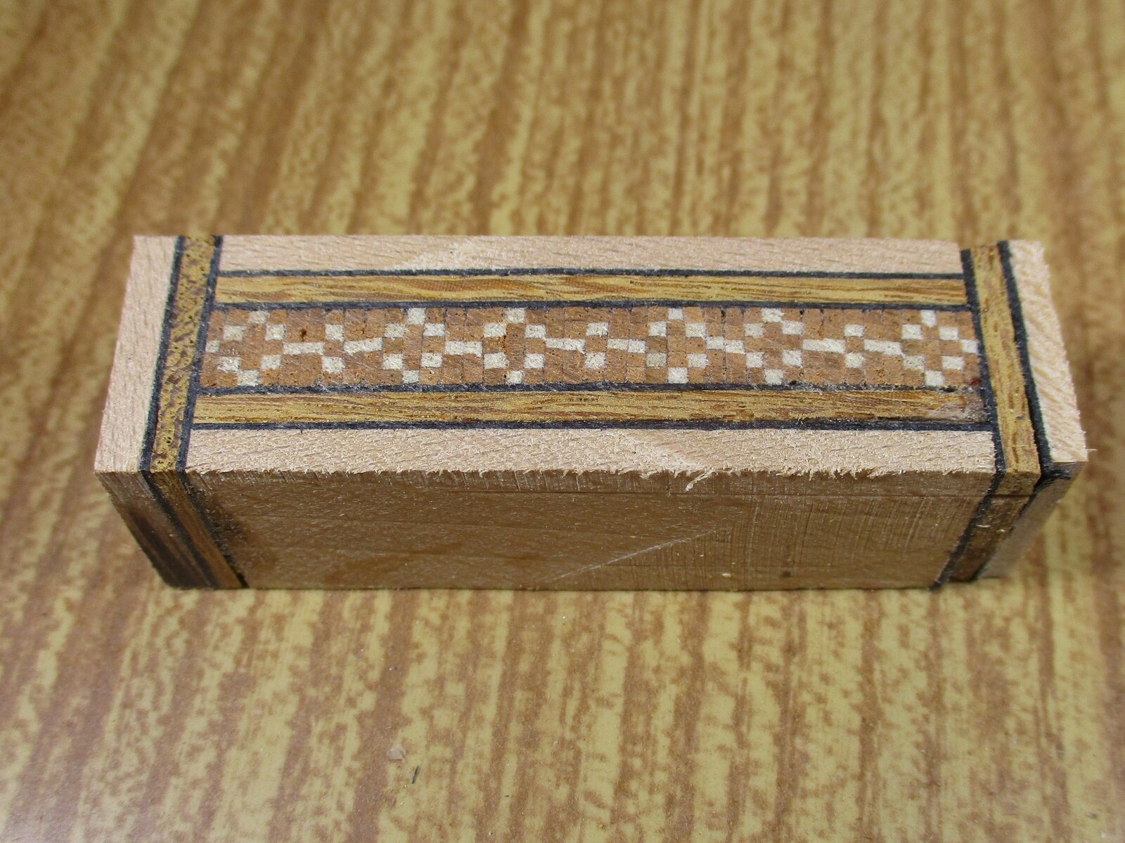

I watched a video of a chap making rosettes for a guitar, using really tiny pieces, and thought that I would have a go. All comments appreciated. IMG_2740.JPGIMG_2712.JPGIMG_2717.JPGIMG_2737.JPG

Alan you are really doing work that I would not even try and you have a good handle on it. But if you would allow me to make a comment or two. I believe if you are going to take this to the next level you need to be more precise and work a method out to be able to sand all sides or get extreme cuts. I say this because I can see splintering and gaps. This could be a product of the woods of choice. Maybe try using acrylics or metals because you will avoid those things. Yes gluing is a problem because of time constraints but doing things in batches or steps could work around this. being able to work with hard woods is a plus because of tighter grains. and being able to plane and sand flat is a must. Now how you do this is something I can not suggest but just throwing my thoughts out there. The work is far better than I could do but it seems you are looking for perfection. That next level is a tall step for sure working with woods this small. Good luck and hope you do not take my comments the wrong way.
Thanks for your input, John.

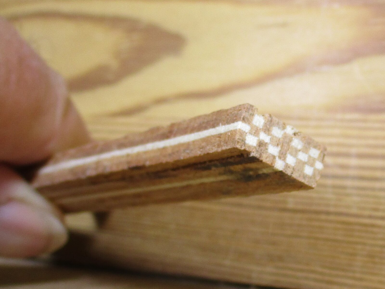

I know that the splintering and gaps come from the ridges left after cutting on the bandsaw.( as you can see on the second photograph )
There are jigs that I have seen on rosette makers videos which addresses this problem but I have not made one yet. This is just my second attempt with this type of pattern and as you know glueing such small items accurately is quite problematic. I made a clamping jig and, if I continue with a few more, will look at trying to tidy up the bandsaw marks better.
I agree fully that using hard woods will be an improvement. Currently I am at the 'suck it and see' part of the process, but will be trying different woods with my next ones.
I value your comments, John. I am aware of the issues, but posted anyway to get some feedback.

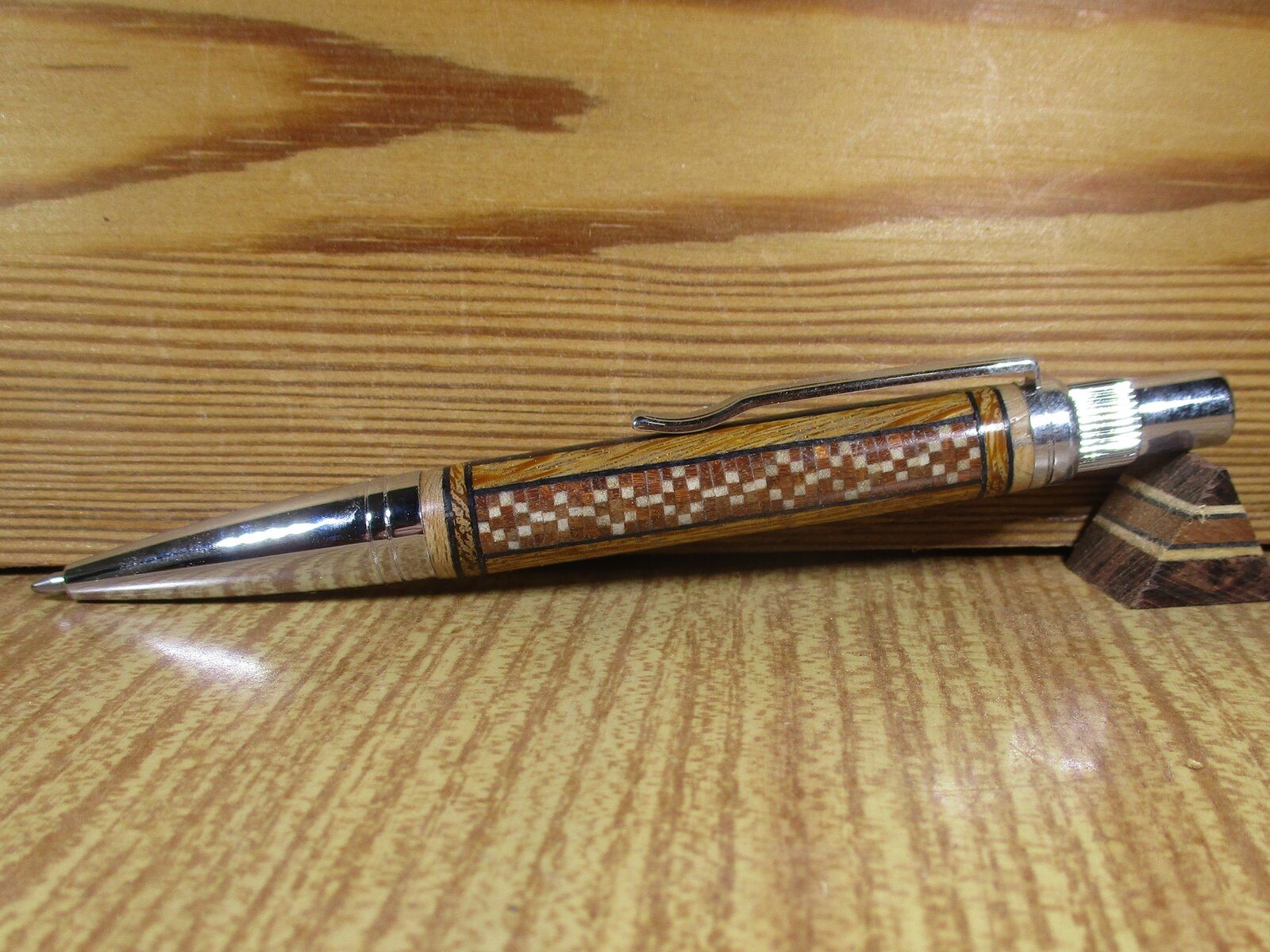

Saying that, the pen looks great in the hand as the wee gaps are not seen with the naked eye!!!
Alan
Alan, I love your artistry. No need to give pointers, you know the issues and where the tweaks need to be. BUT, for this pattern - I am a big fan and admire your work. Very nice design. And I agree, the visual is quite appealing for the casual eye and I would be proud of this. May you have a great spring on your side of the pond. If I get lucky I may get some time this summer to play.
My first thought was "wow". Next thought was "wow, that took a lot of patience". After that was "wow, he must have a very sharp skew".
I can see John's point about precision and tighter joints, but this is much beyond what I can do at this point. Maybe someday with practice and patience. That being said, I do like the old world feel it has about it. It reminds me of some of the matchstick art of days past. It's not like you can really use a planer with stuff that small. I wonder if stabilizing would help with any splintering or tear out from having to work with the end grain like that?
Anyway, bravo! That's some pretty amazing and intricate work!

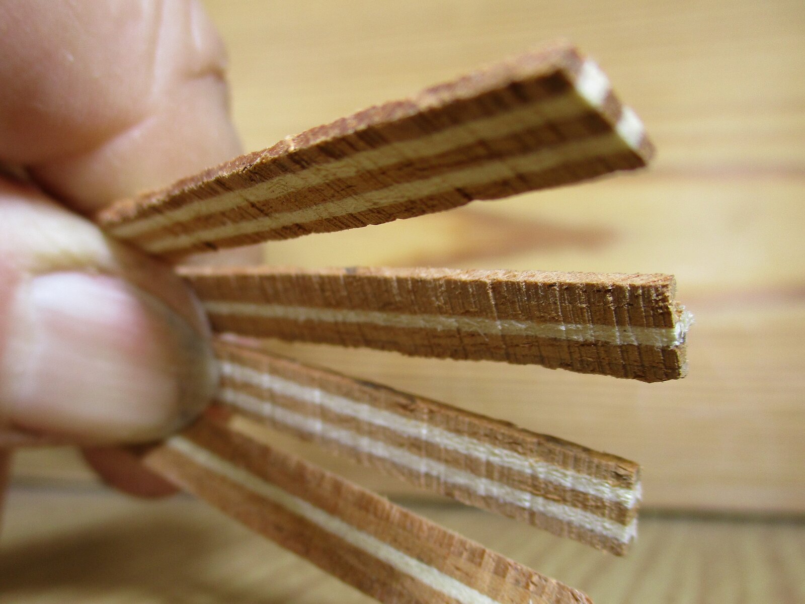

Alan I am only trying to make suggestions because I do know that working with materials this thin and small is not easy. To me you will never get a good cut using a bandsaw. Just not possible because the way the blade travels and the thinness of it. It flexes too much. You would do much better using jigs designed for a tablesaw. I believe I told you this once before in one of our conversations I am a huge fan of using doublesided tape and securing to a flat piece of Baltic Birch plywood as my carrier. A tablesaw blade is solid and cuts cleaner than a bandsaw blade. If using a bandsaw blade I would try a metal cutting blade because it does not have the set in the teeth like a wood blade. and the tooth count is higher. If i need to sand the pieces they are already secured to plywood and I can run over a flat surface like sandpaper adhered to a glass plate or I like to use a piece of flat tile. Now that I have a Brynes tabletop sander I happened to use that for some thin material to make a pen that I will be showing at some time. This works well too. As far as clamping I would treat each row as one layer and clamp all in one row and then keep doing this. Now you have rows that you can even up by sanding method. Clamping is very easy. A 90 piece of aluminum angle is your buddy. Man I use that all the time. I either line with wax paper or scotch tape. Have a piece of straight aluminum to hold pieces down and just put stops on the ends and use tiny wedge if need be to tighten up joints. make sure you keep squaring everything up after each row you keep adding, just like doing a celtic knot or doing scallops. Just suggestions. Do as you may. Good luck.
