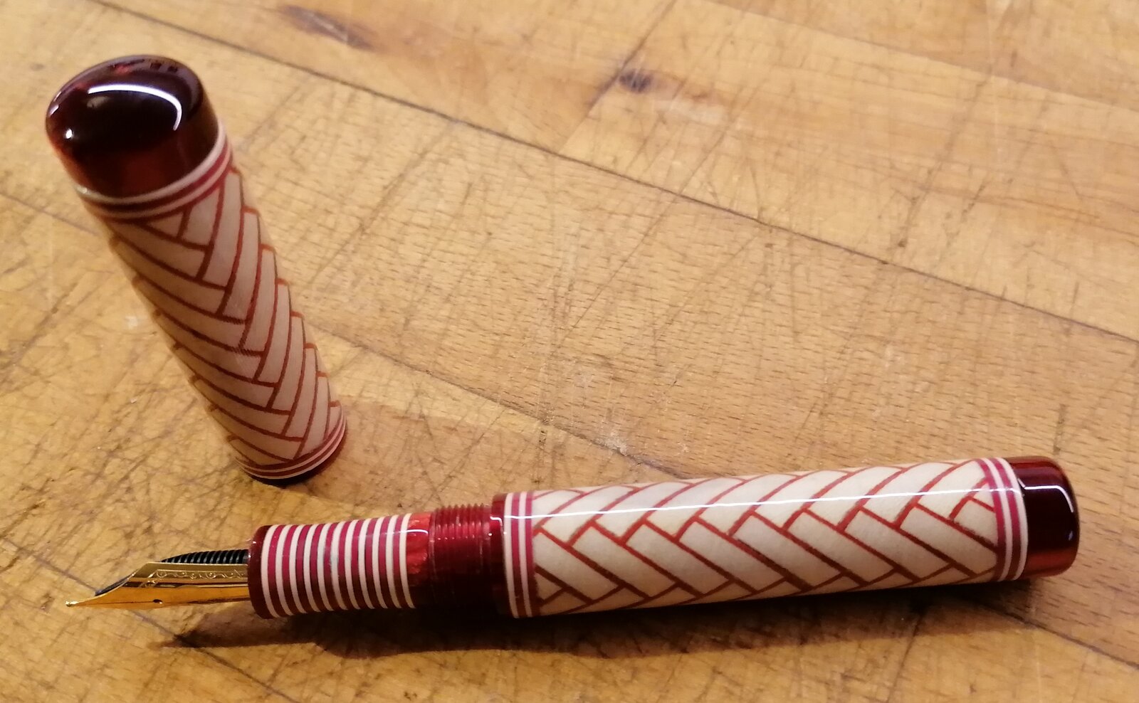

Holly, Red tulip veneer, cream and burgundy credit cards and red mother of pearl kirinite

Very nice work. I tried blowing up your pictures to see if I could find the kitchen sink. Did you run out of room or did your wife say you couldn't have it?
Thanks Kenny, the kitchen sink is in the case but I had to remove the taps...... 😂😂

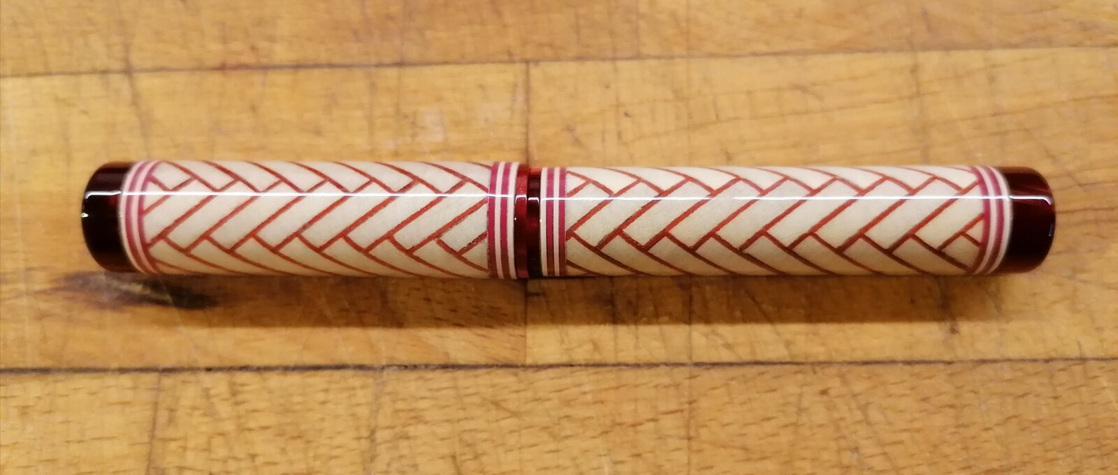

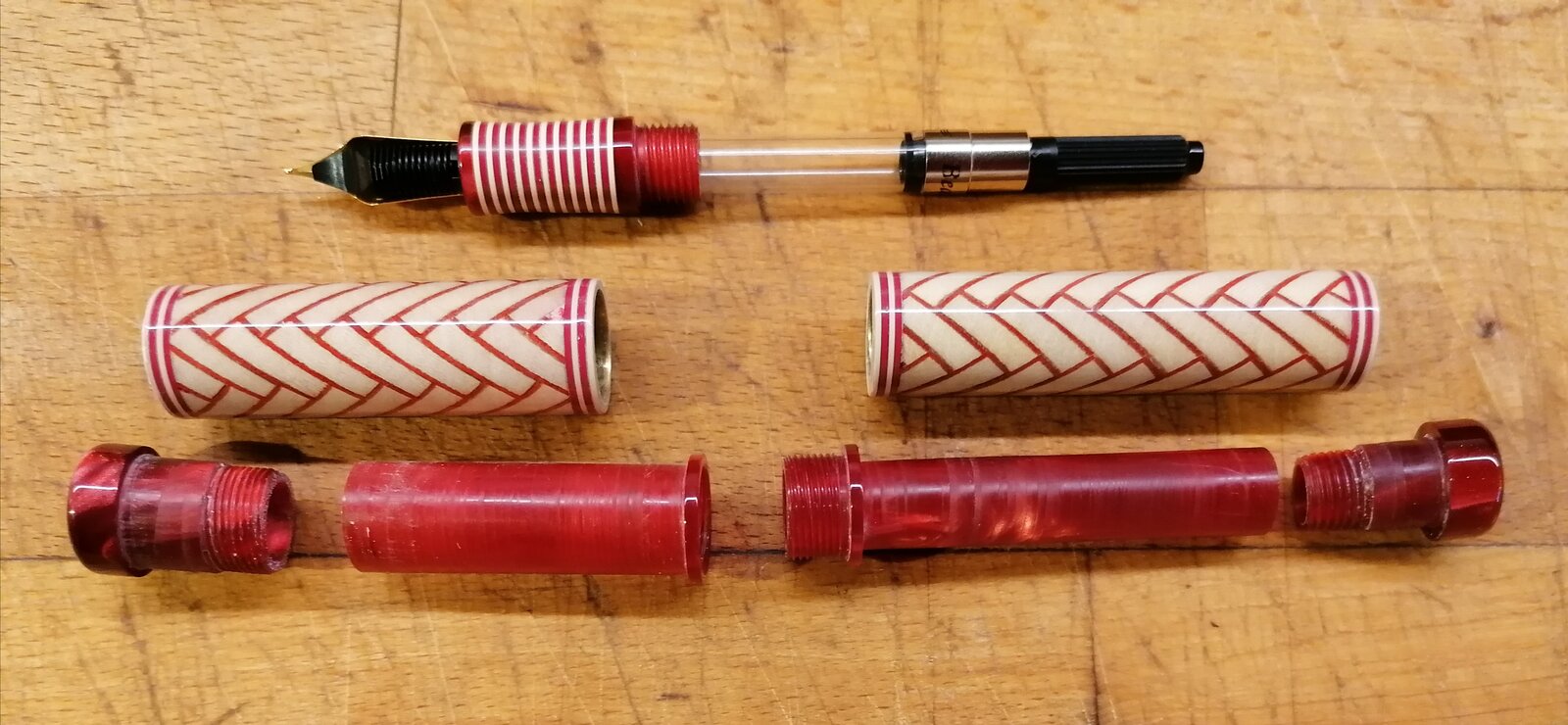

Very impressive ! ! !
There does not seem to be much wall thickness . . .
. . . what diameter are the two brass tubes ? . . . please . . . and I hope you don't mind my asking . . . just wondering.
Thanks Mal it's 9/16" for the cap and
Thanks Mal, it's 9/16" for the cap and 15/32" for the barrel. The outer diameters ended up being 16mm cap and 15mm for the barrel (sorry for mixing up measurements) so the cap doesn't have much left left when turned down but I needed the tube inner diameter to take the insert, cap thread and section

This is awesome! You have come up with a very unique color scheme that works so well! Did you make the hardware (the red tubing)?? I am just trying to understand your process as I would like to make a kitless pen sometime.
Thanks mate, yes I made the tubing and threads etc. Hope you have fun on the "kitless pen" adventure 👍
