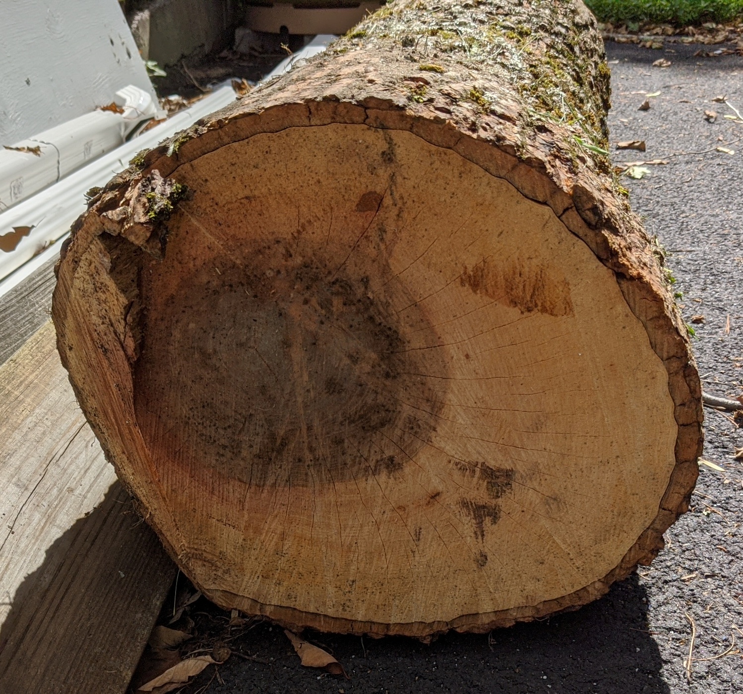

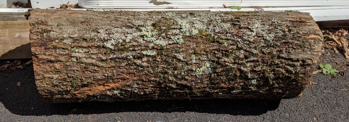

During the last high wind storm, the Pastor of a local church that lives down the street from me had a Hickory tree that was compromised and had to be cut down. I noticed the wood logs laying in his side yard and inquired as to what he was going to do with it all. These logs varied in diameter from 24" x 8', 14" x 5' and smaller/longer. He mentioned that the larger log was claimed by the guy that cut the tree down but the others he didnt have any plans for. I was given permission to take the 14" x 5' log.

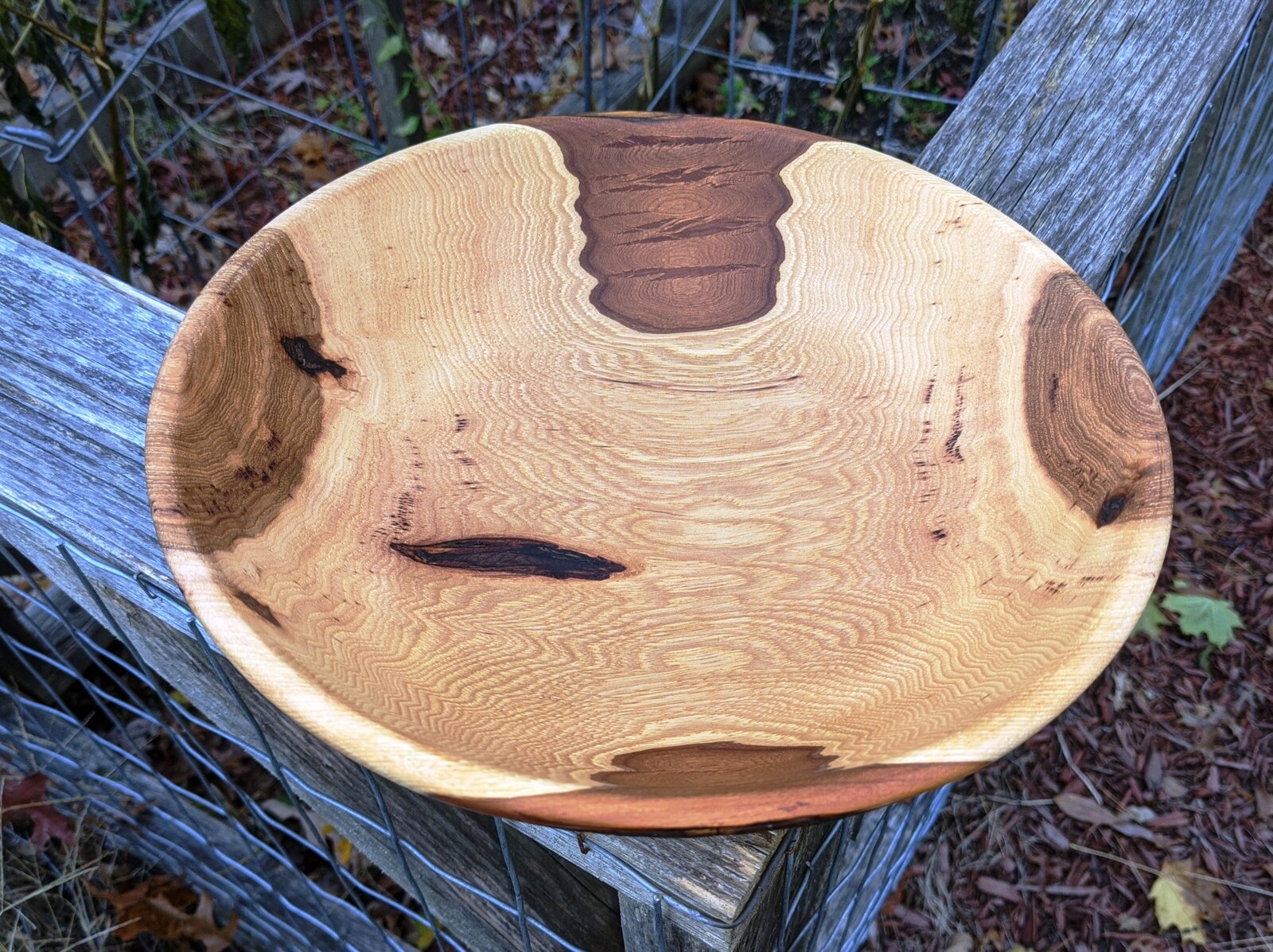

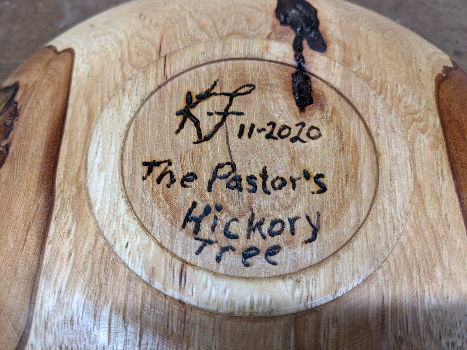

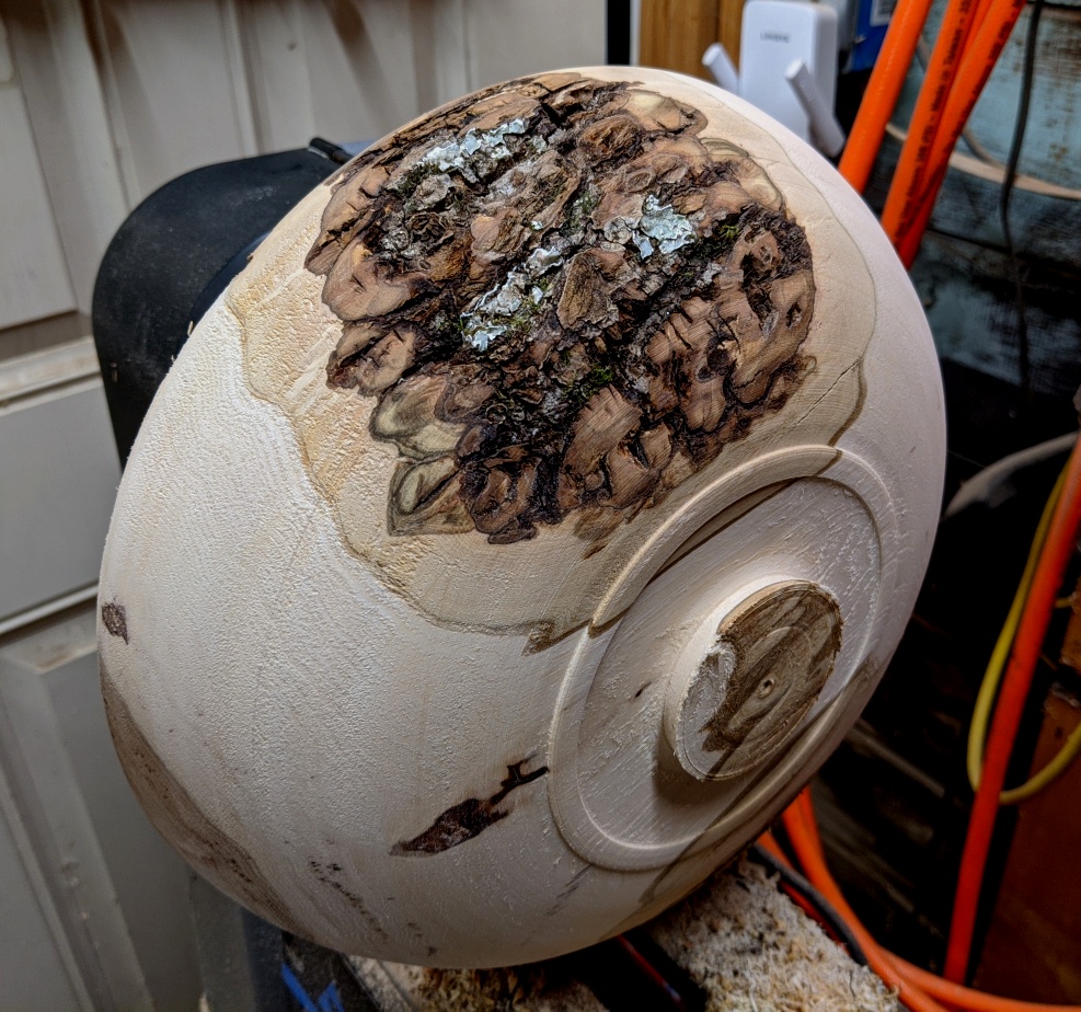

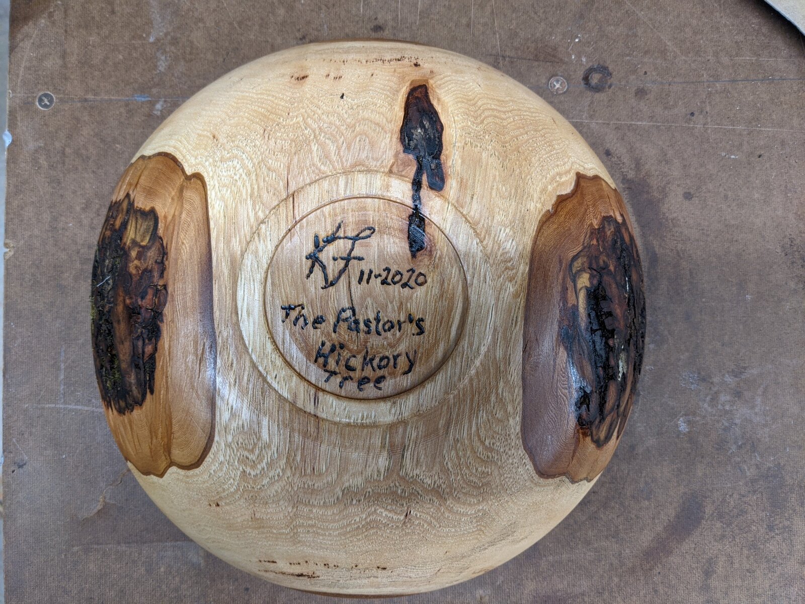

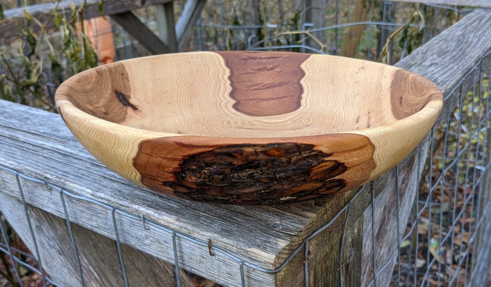

Long story short, I cut the log up and Anchorsealed the end grain and stored it all in the shop. I took one blank and roughed it out for a bowl green, stored it for a couple months in its shavings in a plastic bag. I took the blank and threw in my stabilizing oven and dried it out and finished turning it. When it was all done and food safe finished I presented it to the Pastor and his wife. they were amazed, very surprised and his wife told me she was saying they should have had something done with the tree as a memento. When I handed the finished bowl to them they were teary eyed.
Attached is the journey of the bowl from log to finish.

Well done! On several things.
Hickory is an interesting wood. Very dense (heavy). I've turned just a little bit of it and I love the way it finished.
You did good. 😇
