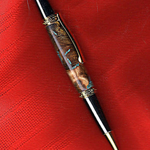

Tony--i've not seen how fine this product is ground, but i've been using dust of turquoise, lappis, copper and aluminum in voids in burl that show up when i'm close to finished diameter. As mentioned above, i work the dust into the void then add a few drops of super-thin CA. The CA carries the dust where it needs to go as the void changes sizes in that last 1/16" or so of turning. I tried doing that with epoxy, but i was getting clumpiness and also the epoxy was too thick to find the void below the surface. That use has saved several blanks and i think adds a touch of artistic impression. Craft Supplies carries a nice assortment of dust--not cheap, but it only takes a little cuticle spoon from a manicure kit to fill an ugly void.

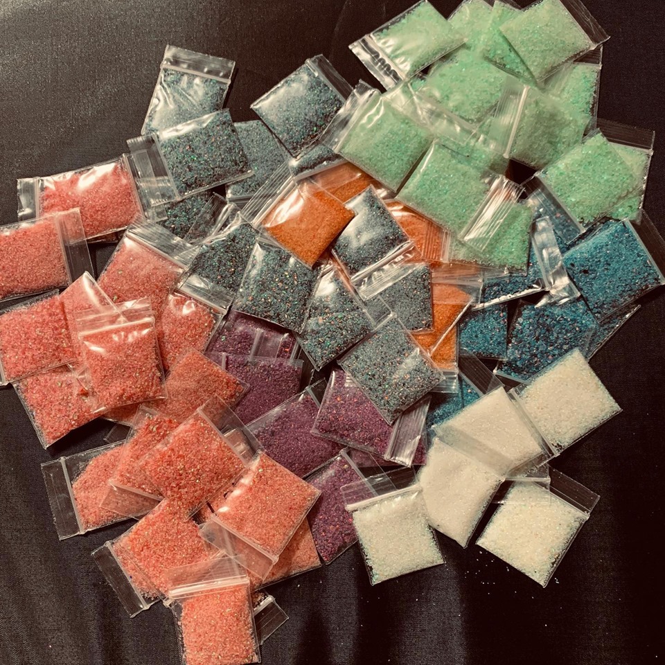

Tony, yes, the synthetic opal is sold by the GRAM.
I asked The Opal Dealer about using it to create a 1/16" deep x 1/8" wide accent on pens, and whether to buy the Fine or Medium grit, and their reply was:
For pen making we usually suggest our fine size. The fine size would fill the space a bit better. For that small of an inlay space, I would guess 1 Gram would go as far as 30 pens but that's just a guesstimate.
Found this photo on their Facebook page from a Sale back in July, and it shows the 1 gram packets:
Not clear on the actual measurements of the packets.

I have a bunch of the 1 gram packets; I'm not sure what the volume is but I'd guess about 1 teaspoon, maybe a little more.
