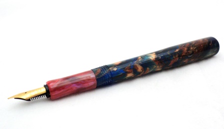

(An old cliche) but I met him yesterday while attempting to unravel the mysteries with my 1st componentless FP.
Is the nib supposed to fit tight against the section? The reason the section is an odd color is because I was just using left over pieces to experiment with....

For the nib, yes you will need to step drill the very front of your grip section to accommodate that small step in the feed housing. It should sit flush with the front of the grip section when seated fully.
Otherwise great start.
