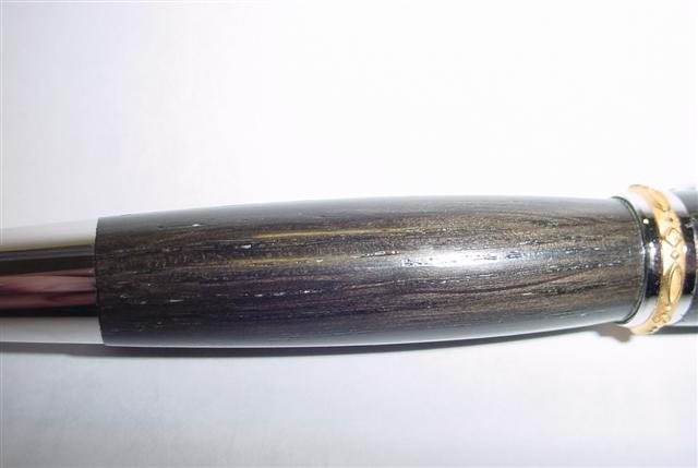

First, I thank Lou for the Bog Oak!!!
Then, he was kind enough to help eliminate the "white streaks" that I kept developing.
So, finally, I have a bog oak, with which I am pleased.
This is done with sanding sealer, several coats and sanding in between each application (AND adequate time for each to dry, outside of my wet basement!!)
The result is exactly what I am looking for - it is not "plasticized wood", you can feel a little grain, you can see a little grain - JUST LIKE REAL WOOD!!! But, it feels very smooth to the touch.
The pic is not the best, but I wanted to post before the show this weekend, in case I don't have it after the show!! (We are scheduled to leave tomorrow-of course they are predicting high winds, so my 18' trailer will be banned from the interstate, making our 70 mile trip SEEM endless!)
Again, Thank-you, Lou.
Comments invited! (Remember, I AM a plastic guy, so don't expect a whole lot when I attempt wood)[:I][:I][:I]

SWEET! I HATE those darn white streaks in the bog oak! Congrats on your successful turning, and on a very attractive pen!

After re-reading, I should add that there are a couple of coats of spray lacquer on the pen, as well. But, the real "trick" was continuing with sanding sealer until I had the result I wanted. The lacquer (3 coats, I think) just seals it all in.

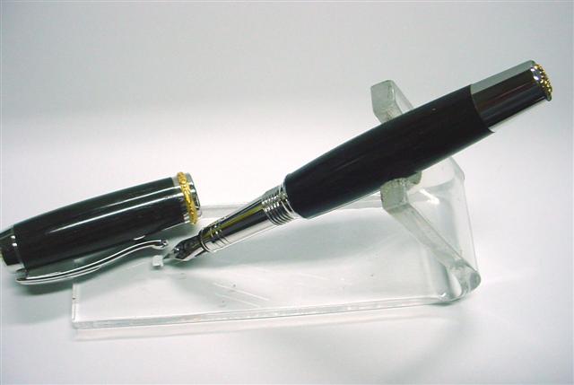

Had a few more minutes and I could hear Eagle saying, "I can't see the wood!!!" So, here's the wood.
Now, Eagle will feel better! (Lord knows we don't need a sick bird on the site!)
The "pits" are reflecting light, making them look white, but in person, they just appear to be "oak grain".

And just that fast...BAM!...the student surpasses the teacher. Magnificent job, Ed! (Now can we get Dawn to take a picture? [8D])
