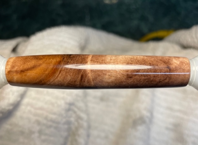

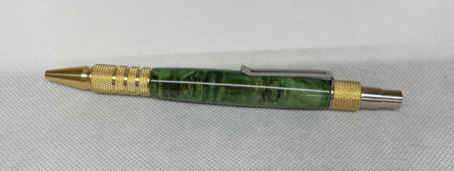

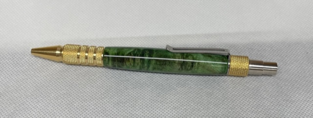

Thanks for steering me to GluBoost. I've used it a couple of times already...and it's the best CA finish I've done so far!
The first picture is a stabilized colored brown Box Elder (WXST16) from PSI, I think. It will be a Dura Click EDC Aluminum, after letting it sit overnight.
The second is stabilized green Maple Burl (WXST03) also on a Dura Click EDC, Brass.

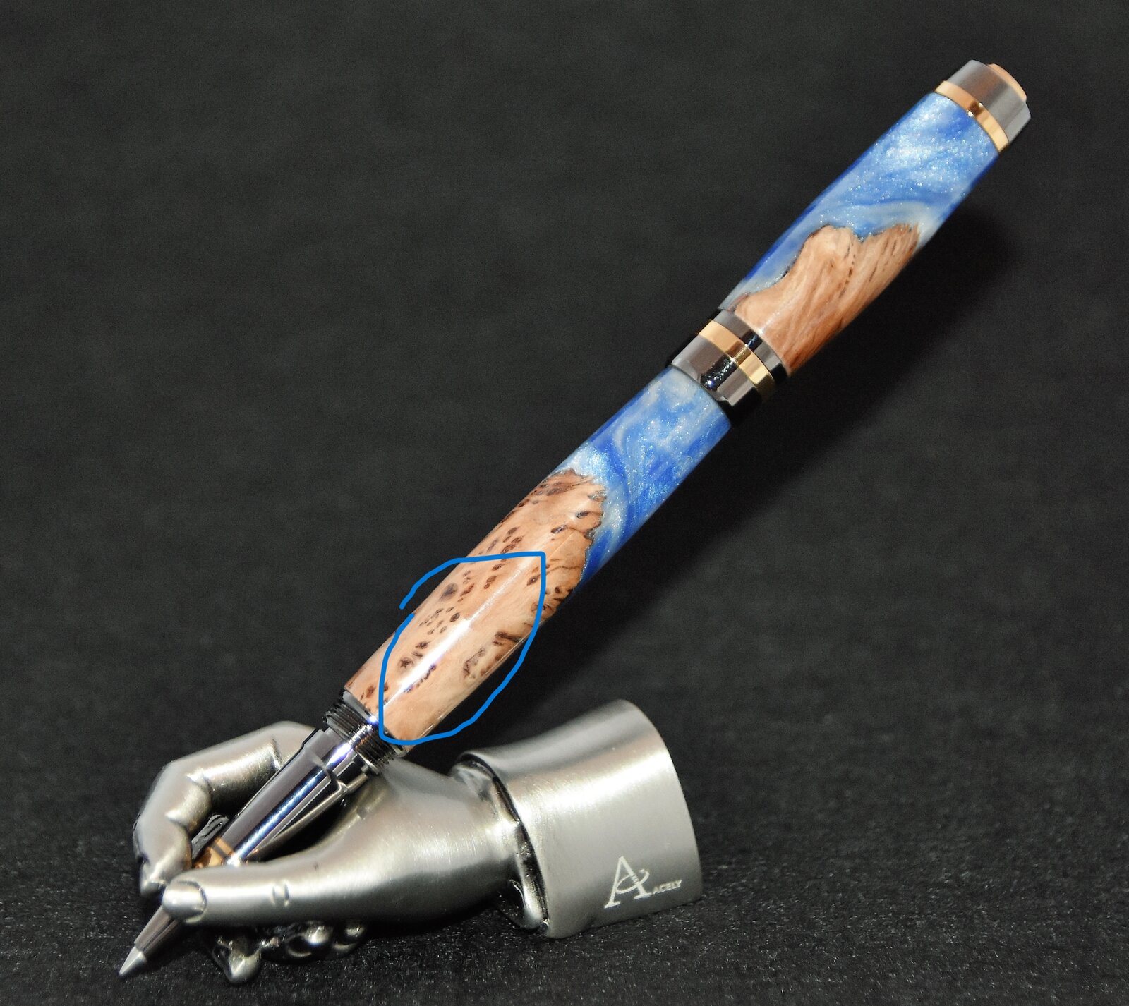

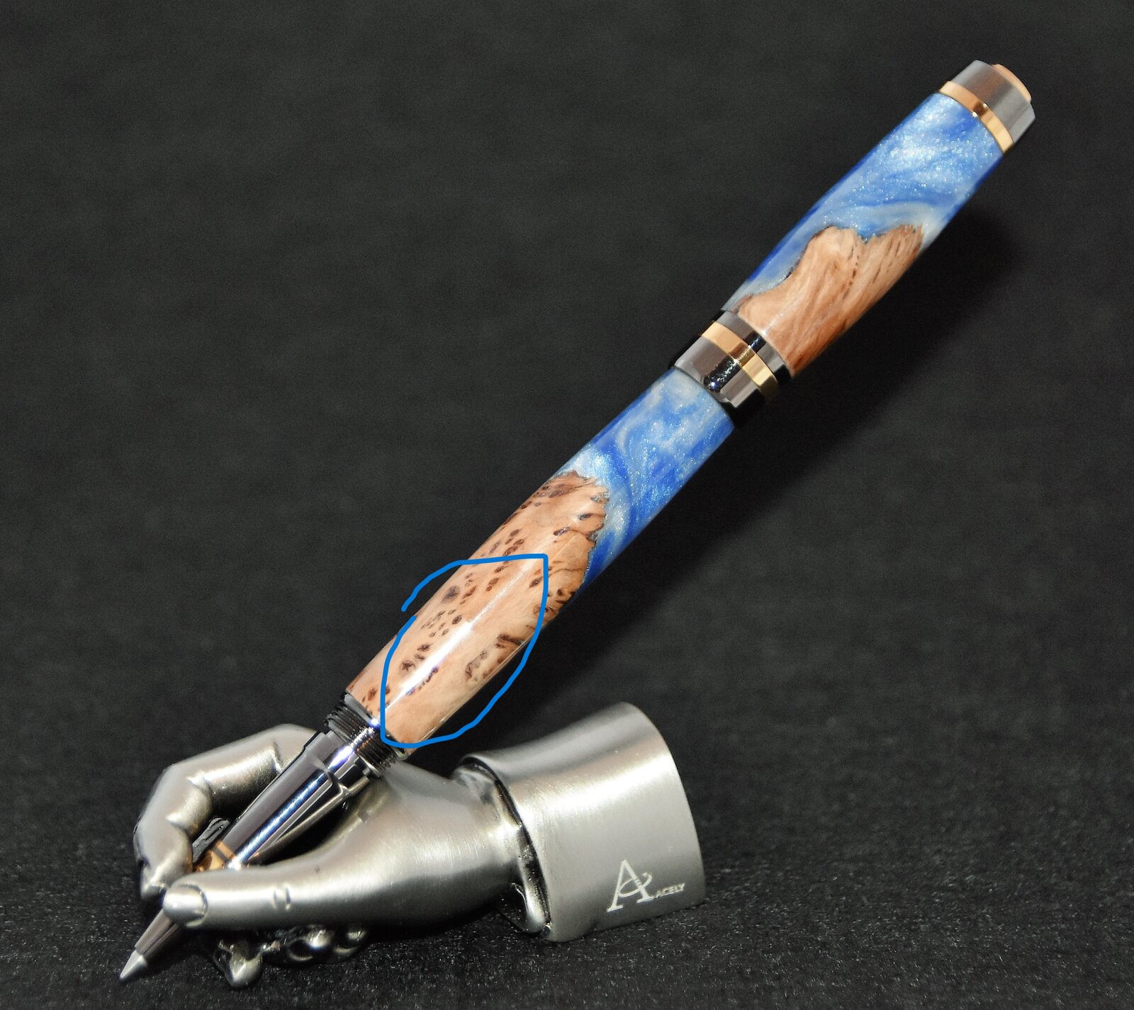

Thank goodness I found this post! While I am new to turning (a year or so) I have not had any issues using Titebond until about 2 months ago. One pen showed a fogged spot right before the final micromesh. It was stabilized redwood so I sanded back down to wood, applied 2 thin, 8 medium Titebond, micromesh, polish and perfect pen finish. Last month it seemed to start happening more often. Started noticing some fogged spots so I got bit analytical- tried with accelerant, without accelerant, waiting a bit of time, waiting hours between coats, tried Super-T CA etc. and could find not seem to find a pattern. Kept an eye on humidity- very stable in Colorado and I keep the humidity around 25-30% in the house. I finished a beautify blank last week and let it set for a few days before assembly on Friday- it was perfect. Today I took it out and - fogged areas. grrrrr. Glad it is no just me. Looks like I am going to go over to GluBoost and give it a try. Sorry for the flash- in the circled area, at the top is the unfogged high gloss, and in the bottom part of the circled area (slight color variation) the fogging.

Fog is usually the result of accelerator, or wet sanding in certain conditions, particularly on the wood. Don't wet sand wood, it will retain moisture for sure, even if it is stabilized. Sometimes in high ambient humidity situations - it occurs too. Green wood, even air dried, can do that also.
