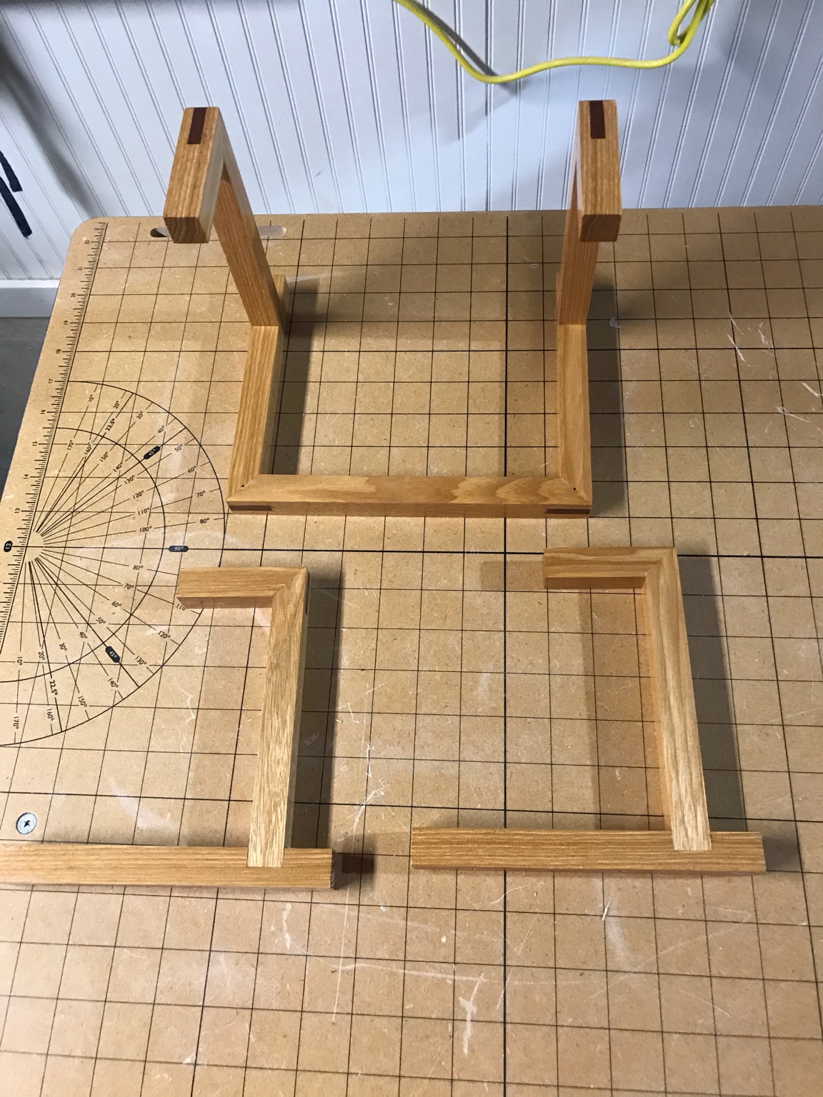

Here's a picture of the components just before you put it together. Should help anyone that wants to make one figure out the assembly.
