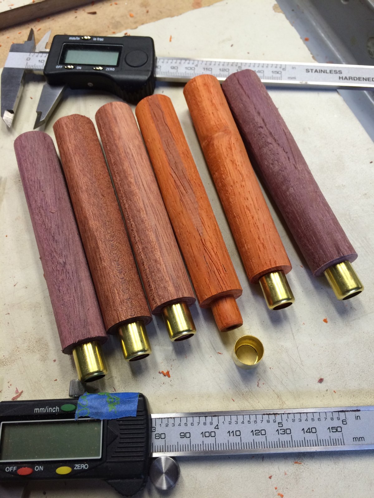

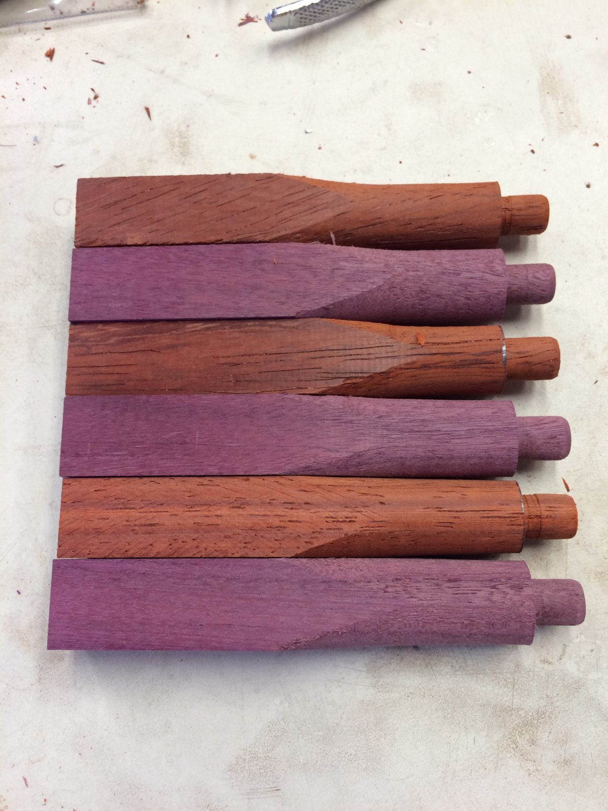

I have had great success just using a parting tool. After turning the piece to size for the main portion of the blank body with the tenon I then make sure I know the length of the tenon and start my cut right there. Early on I would mark the line in pencil.
Go easy on your depth at first and measure often with your calipers.
I use an inexpensive parting tool, but it is very sharp. It makes tenons like this.
I use digital calipers and when close I test fit to avoid a loose tenon.
