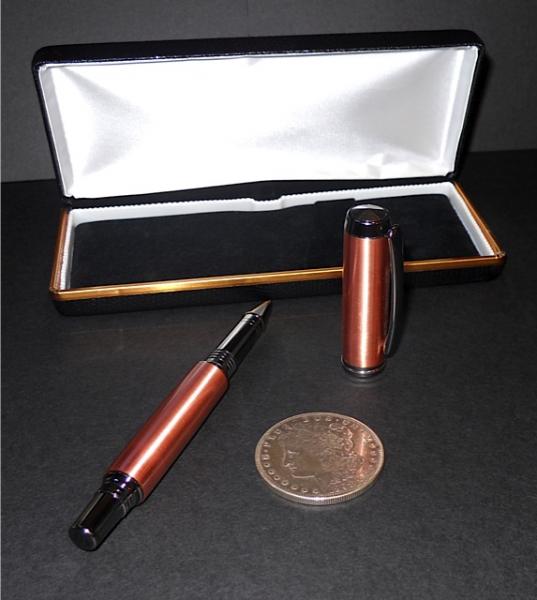

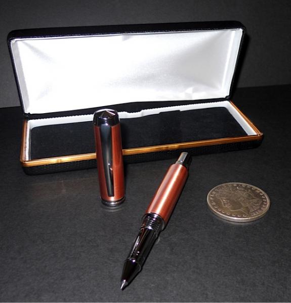

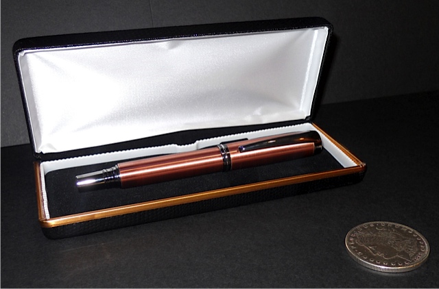

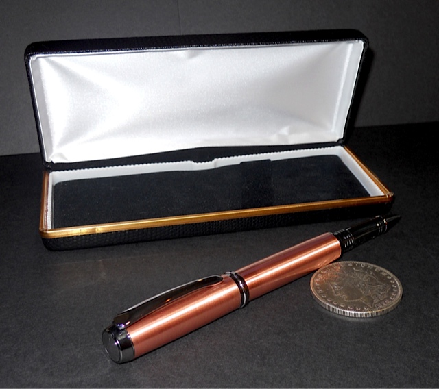

This is going to be a gift to one of my son's karate instructors, who always has extra time for him. She just passed her 3rd degree black belt. She definitely is an inspiration.
The body is made from Tellurium Copper Rod... the kit is an Artisan Jr. Gent ll....Black Titanium and postable. (also it has a thin CA finish...but im not happy with it)
I find that the metal pens...Aluminum, Copper, Bronze~Aluminum & Brass pens have a severe tendency to Scuff, Scratch and show finger prints very badly... Ive done both very very shiney finish and brushed finish... but to no avail... the CA im still trying to work out with the metal pens...and it's been frustrating to say the least...so if someone has any tips...I could sure use them.
AND as always... your comments (good or helpful) are most appreciated! :)
