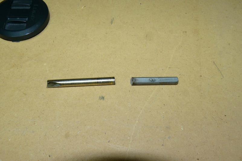

Question about the Teachers Pens: Are they suppose to retract or not? This is the second one I have made by the kits instructions. When I twist to retract the ink, they seem to push out causing the middle to come apart. I do not understand. They fit fine when the tip is out.
I also did a green and white corian and a blue slim line. However in the process of trying to square up another wood blank I had, the shaft seemed to get stuck in the tube and over heated, thus causing it to break in half. Can I square off without the shaft??
